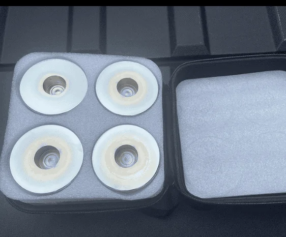

I tried this but found the slip off center from each other, which seems sketchy.
Sorry for the potentially unsafe advice. It looks like the Jack Puck brand pucks have large holes at the bottom to allow for shifting:
Rivian R1T R1S How are you solving the Jack height problem? 1722438920229-61
I bought some generic pucks off Amazon, and the hole at the bottom is snug with the nipple, so they don't shift when stacked.
Rivian R1T R1S How are you solving the Jack height problem? 1722439030606-5l

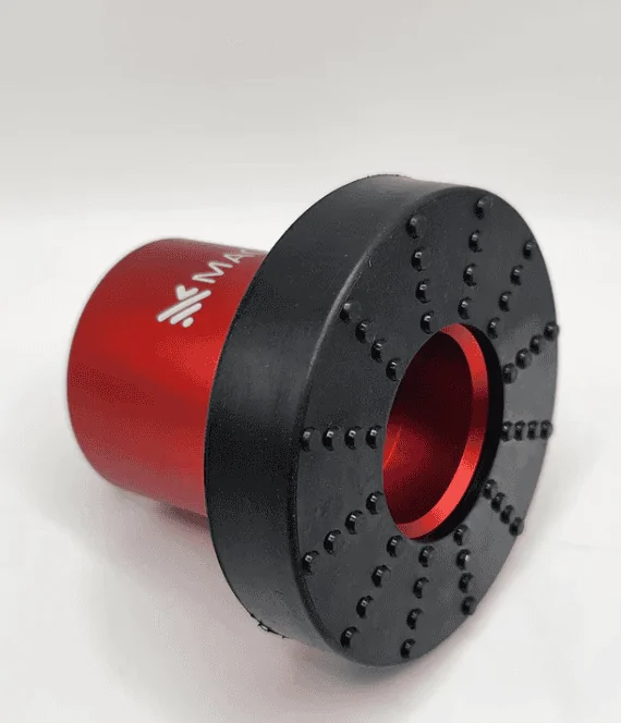

Our Magnetic Jack Pucks are designed with a 'port' for the Big Red by Torin 10T Bottle Jack Jack, which we find to be far more practical for working on Rivian's. The pucks you picture wont work safely with a bottle jack, so I imagine you must carry a floor jack with those while on the road.
As a Rivian owner, I built these first for me, then for everyone else. We've delivered thousands to Rivian customers for a reason :).

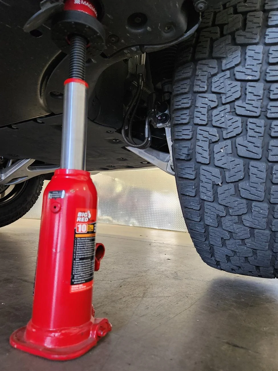

Hi Mark, I just did a 4 tire DIY rotation and on the rears I experienced some shifting when using the Torin 10T Bottle Jack + XL Puck. Not sure if it was user error but the shifting gave me pause and ended up adding backup and backup to the backup (i.e jacks stands on the arms). Better be safe than sorry.
Is there a better way to ensure the mating of this ports seats correctly?
1. Place the puck on the Rivian and then raise the jack until you make contact
2. Place the puck on the jack and raise until you make contact
Not sure if either of these would make any difference to minimize the shifting I experienced.
