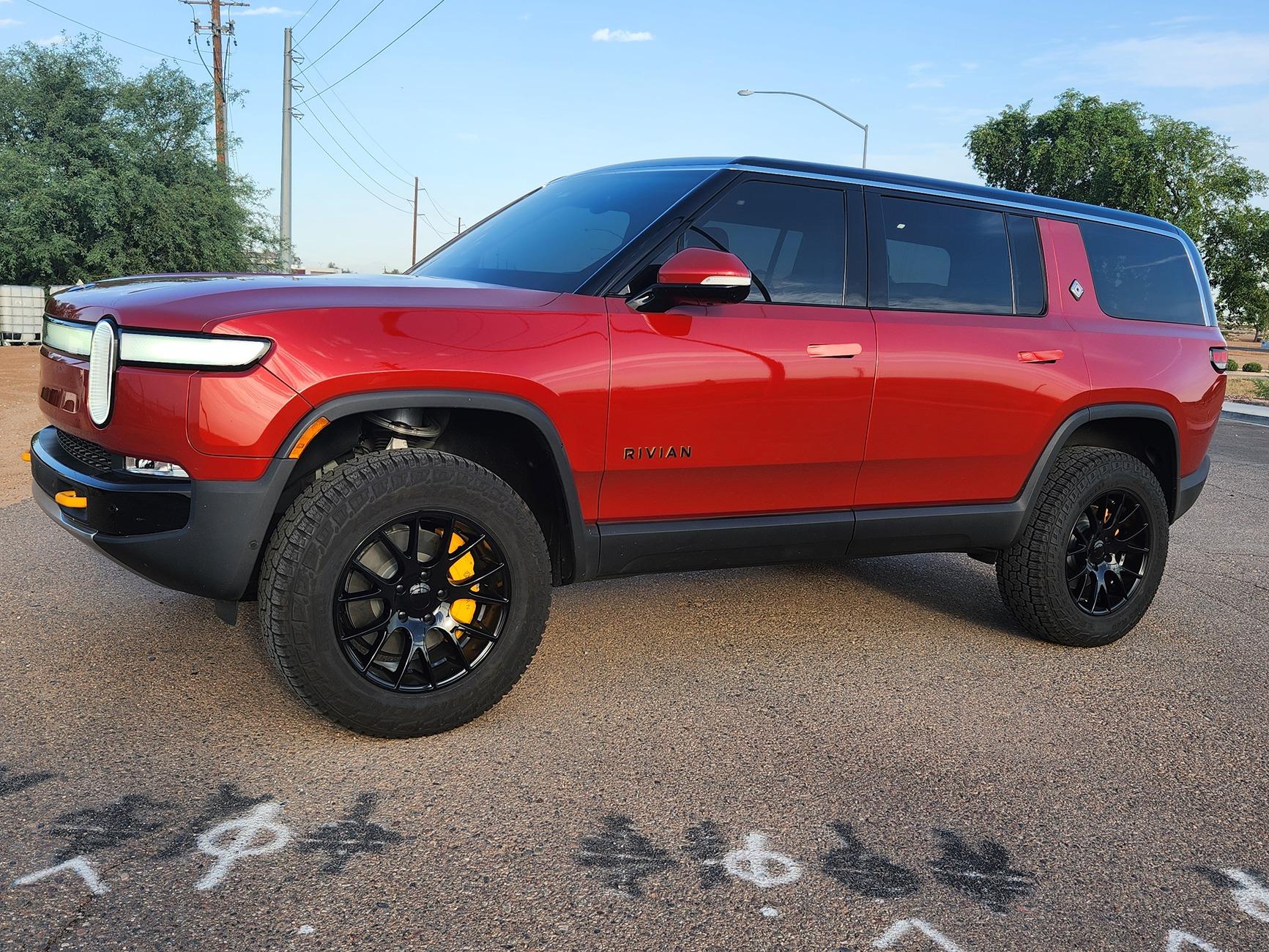

If you don’t mind me asking. What wheel is that you have? I’m going to need to find an alternative to replace my 21” wheels and tires when they’re gone
That is the Dodge HellCat replica wheel. These are +25mm offset, which works well. I paid $550 delivered for all four, as they had light blemishes on them. That is my wifes R1S. My R1T is below running +48mm offset Variant wheels.

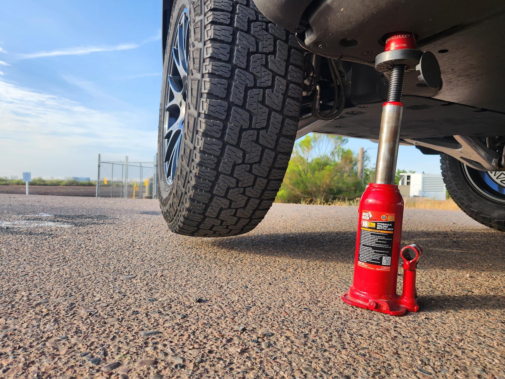

Something is amiss here. Let's see if we can figure out why.
We can lift the front tires almost 2" off the ground with a standard puck and the Big Red 10T on both my R1T with 20's and my wifes R1S on 21's. Which ride height are you in? Quad Motor R1's, Rivian asks for Highest in Off Road menu.
Rivian R1T R1S How are you solving the Jack height problem? tire change height
Bottle Jack. Hydraulic compressed all the way down and the screw extender needs to extend all the way inside the jack puck port until it meets resistance from vehicle. If you're doing all of this, then something else is off.

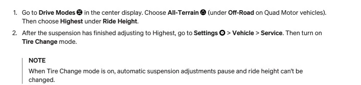

Did you set the vehicle to its lowest suspension setting per the owners manual?
Edited to reflect that Rivian requires the Quad Motor R1 vehicles to be in Off Road - Highest Setting before you initiate Tire Change mode in the Service Menu.
