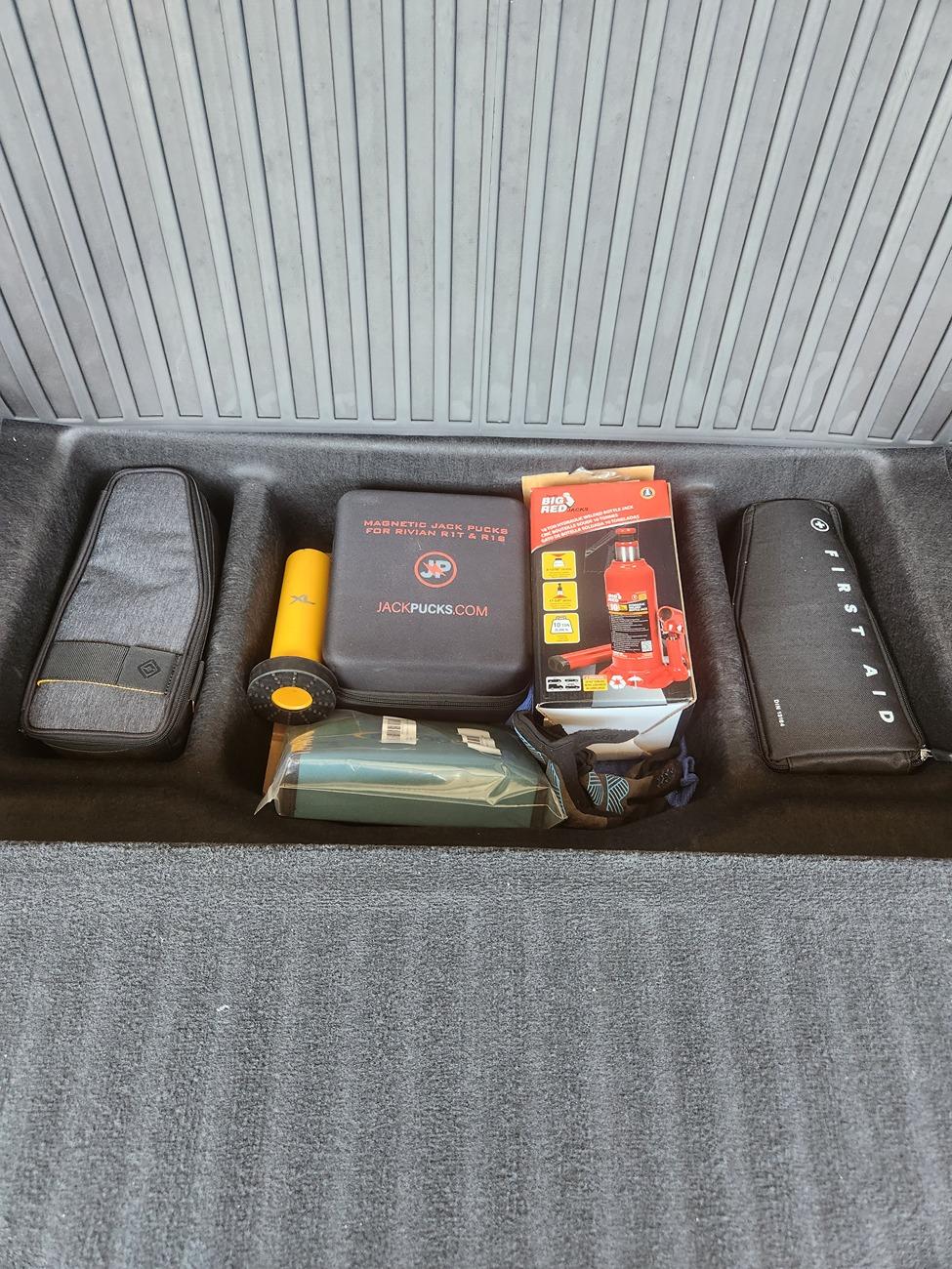

My 2025 R1S didn’t include a jack.
Hmmm. All you need is the following and in my wifes R1S (not sure its the same), everything fits in the rear.
Rivian R1T R1S How are you solving the Jack height problem? 20240731_115142

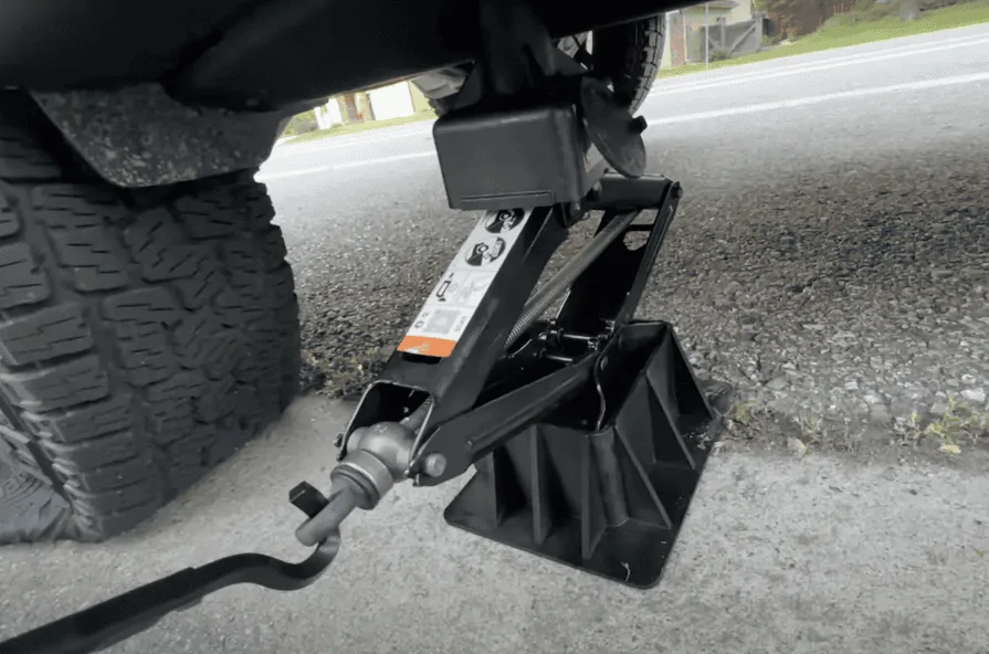

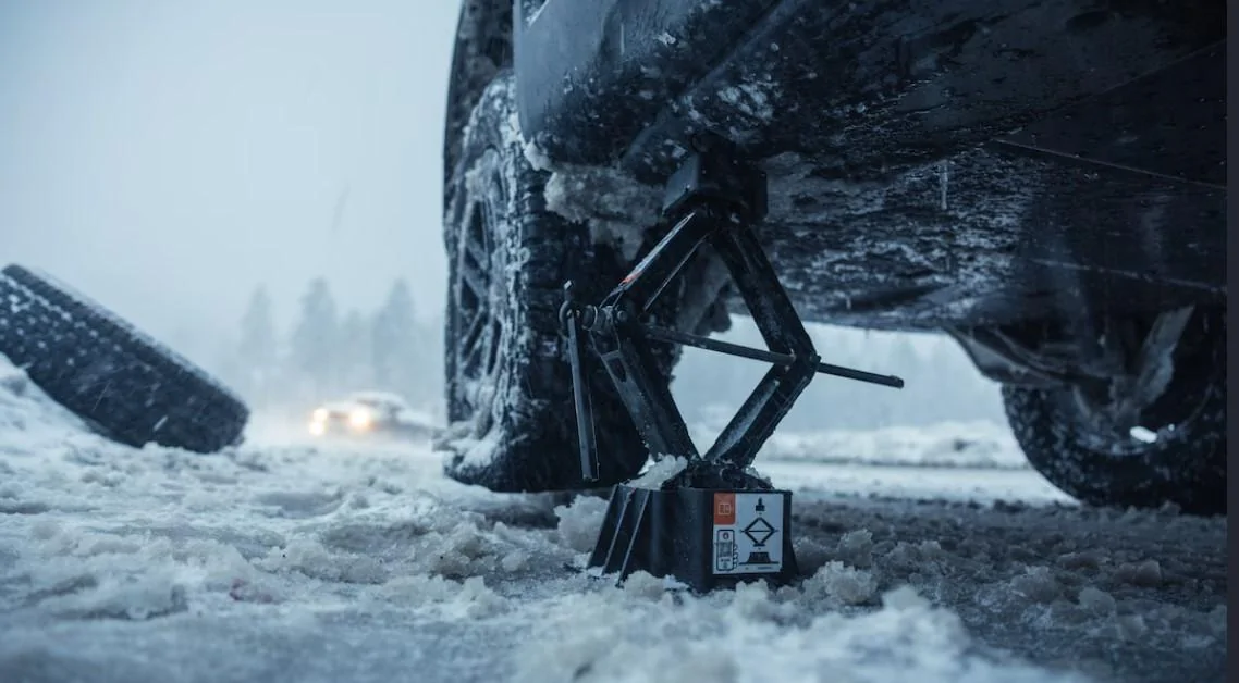

Rivian Tire Change Contraption (below). One of the many reasons why our kits are so well received in the Rivian community. Who wants to use that (base is nice)?
Rivian R1T R1S How are you solving the Jack height problem? Rivian Jack System Klug
Rivian R1T R1S How are you solving the Jack height problem? rivian tire change contraption

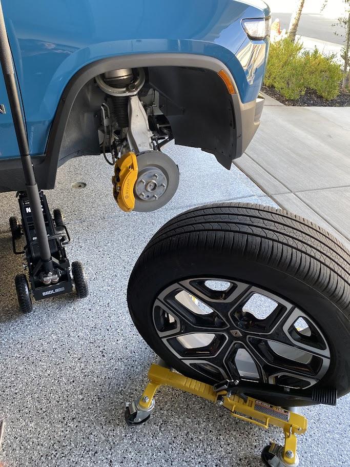

How are you using this dolly?
Lift tire/wheel high enough for dolly to slide under. Then remove the lugnuts and drop the wire/wheel in the dolly. Then roll around as needed ?
Getting older :CWL: and this wheel/tire combo is heavy!! This sounds like it could minimize the energy required to move around to the next location.
I will probably use it the way you do for my rivian wheels from now on.
This far I’ve only used my four (one at each corner) to skate my Rx7 around the garage.

That budget OEM jack/base/puck contraption from Rivian is super sketchy! Once up in the air, if anything moves even the slightest bit I can see a very dangerous situation occurring. Maybe that setup would suffice for a low-slung 3,000 lb economy car, but a 7,000+ lb vehicle that needs a tall jack? No way is that POS safe.

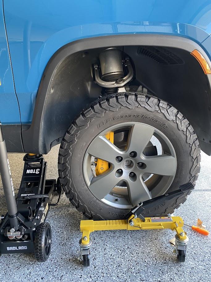

If you're asking me, that's basically it.
The dolly has this little lever which allows you to lift the wheel. You can lift it in very small increments to line up the lug/bolts. It is very heavy for me since I'm used to sports car wheels/tires and the dolly makes things much easier for me.
I'm less concerned with removing the wheel, although the dolly helps. It is putting ON the wheel and lining up the lugs. It is heavy and sometimes you gotta rotate the wheel to line things up. The rollers on the dolly allow for this.
Often on sale at Harbor Freight. Downside is that it's a bit bulky to store. Luckily I have a small shed I can toss it in. Its a little heavy too and not very easily "hangable".
Keep your hands on the wheel/tire as you're moving it around though. It can tip over and you don't want to scratch up the face of the wheel or have it hit anything. I snapped this picture quickly so I could get my hands on it again haha.
I have exact set up. I use the dolly to remove and move tires around in the garage. I found it easier to just use my legs when I'm remounting. Example here:
How to Lift Heavy Tires (youtube.com)
Same principle as the wheel dolly lifting idea but doing it with my legs is easier to control (at least for me).
