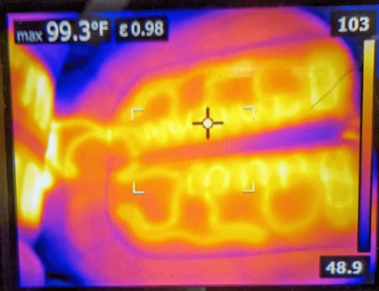

I did a 5 minute test with my IR camera. Unfortunately something is fucky with it and I can't get it to connect to my PC, so here's photos of photos...
I set a timer every minute, got out, snapped a photo of each seat.
Passenger side, which I was sitting in. Seemed to get to max temperature after ~4 minutes and getting out of the seat must have tripped the temperature sensor. The highest at 4 minutes was 101F in that same block but 104F somewhere in the photo according to the automatic scale. Seemed to be hottest before the 4 minute photo. It was cooling down by this photo at 5 minutes.
Rivian R1T R1S How warm does everyone’s heated seats get? 1672269920646

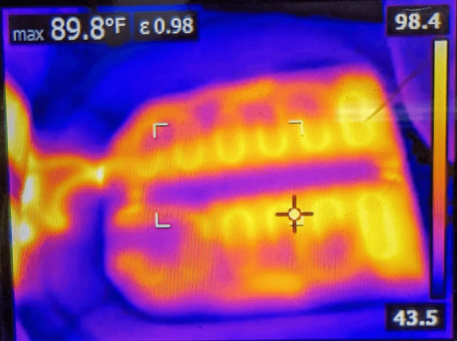

Driver side, not sat in. Every photo showed an increasingly high temperature.
Rivian R1T R1S How warm does everyone’s heated seats get? 1672270059986
Early on the heating wire at the back of the seat was the first to really show up. Seems like there might be inconsistency due to the padding in the seat.
