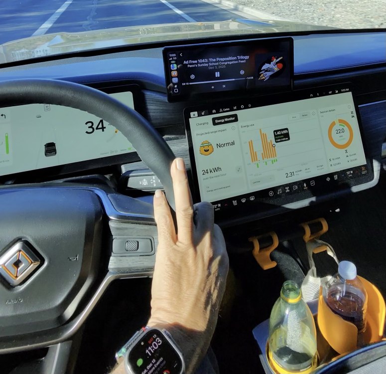

My numbers were wrong on fuel economy on my truck. When I changed tires to the Nitto Grapplers I know it got better, but didn't really watch the usage exactly.
This is after a round trip of 30 miles each way, so we can eliminate road and altitude variations. I was mostly in D+ at 75 MPH. There was a bit of street time but mostly highway, which for an EV, is actually often the lowest economy due to aerodynamics. Also in this case, I had the bed loaded on one leg (delivering bikes to donate for people who need them). Obviously that adds some drag.
Rivian R1T R1S I installed a gasoline engine in my Rivian 4_32_00.thumb.jpg.efe470dafb8660d67d6bd915bb46c9a2
Rivian R1T R1S I installed a gasoline engine in my Rivian _201_a.thumb.jpeg.82e10164b8d78b488a1c5ce4b1d7040c
Rivian R1T R1S I installed a gasoline engine in my Rivian _105_c.thumb.jpeg.bd9ea6a5c8c833536c3eb029cda4d23f

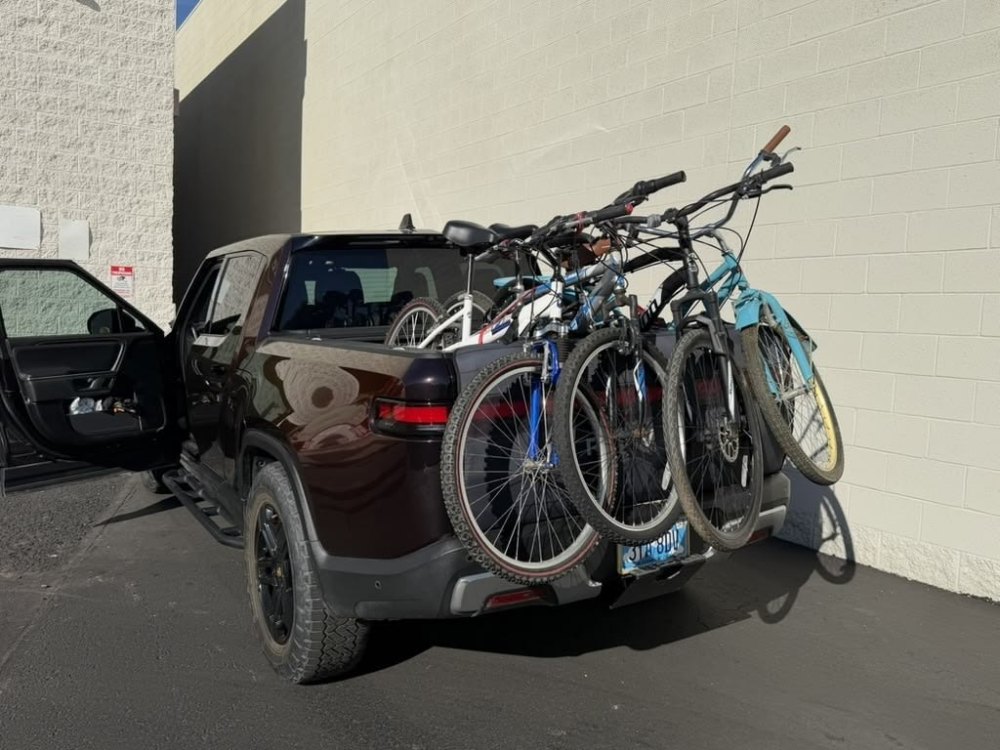

I picked up the wife and immediately left to go to the Rivian toy drive and mini party, also getting the same usage on that trip, but running 80. Which shockingly didn't have as much impact as expected.
Rivian R1T R1S I installed a gasoline engine in my Rivian _201_a.thumb.jpeg.25821031a448077ea5f8a0ec56459809
So, my correct real-world economy is 2.3 miles per kWh. The math then is this:
Full load usage is 0.5 GPH, at 3700w.
Official spec charts put my 3120 load at 0.43 GPH.
The car reported an actual 3kW going into the battery.
2.3 miles per kWh.
16 MPG
2.3 miles per kWh.
16 MPG

Oh, it gets even worse when I ran a real-life test on usage. Probably 13 MPG.

I put exactly 1 gallon of gas in the generator and let it run until it stopped. It had previously run until it stopped so it should be a true 1 gallon test. It fell into the lowest efficiency range that I’ve seen for an inverter generator, and clearly the rated numbers from the manufacturer are overly optimistic. While this generator is five years old, it got a brand new carburetor and full tune up about nine months ago.
Anyway, based on that, 13mpg is the true final number. When I ran it in camp, I had a gut feeling that it was consuming gas far faster than I had expected.

Still cheaper than most the fast chargers. 13 MPG at $3 per gallon is 23 cents per mile. 2 Miles per kWh makes breakeven 46 cents per kWh at the fast charger. If a generator would charge while driving I would get one.
