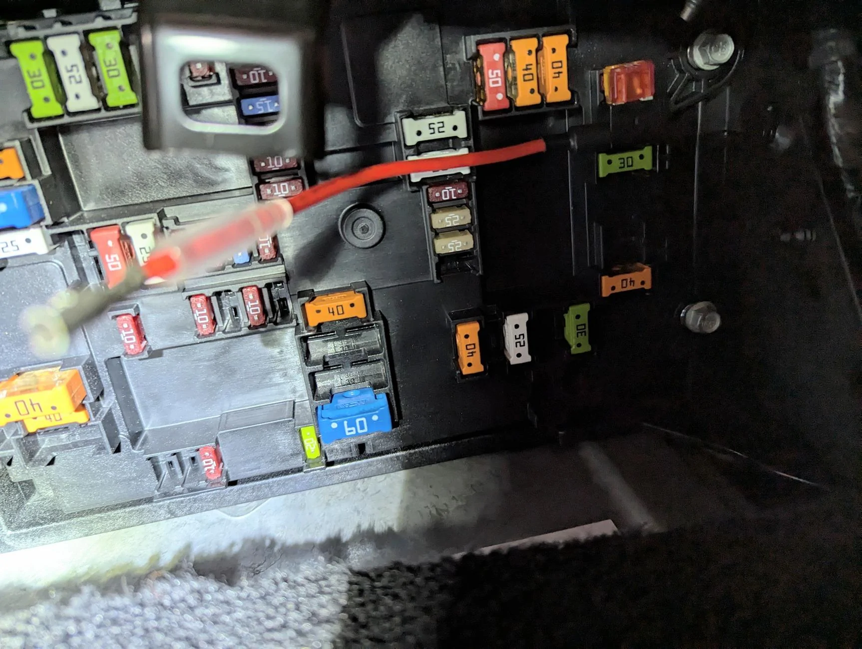

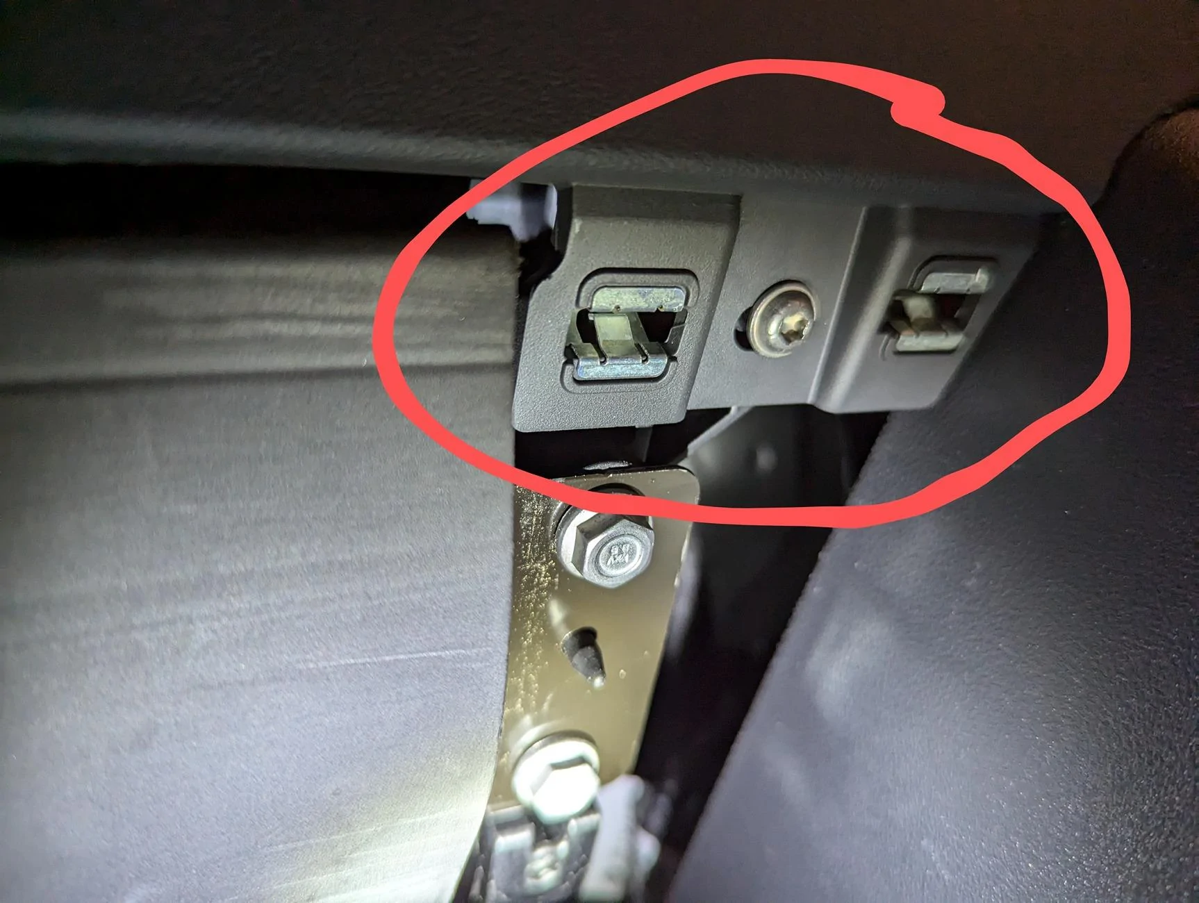

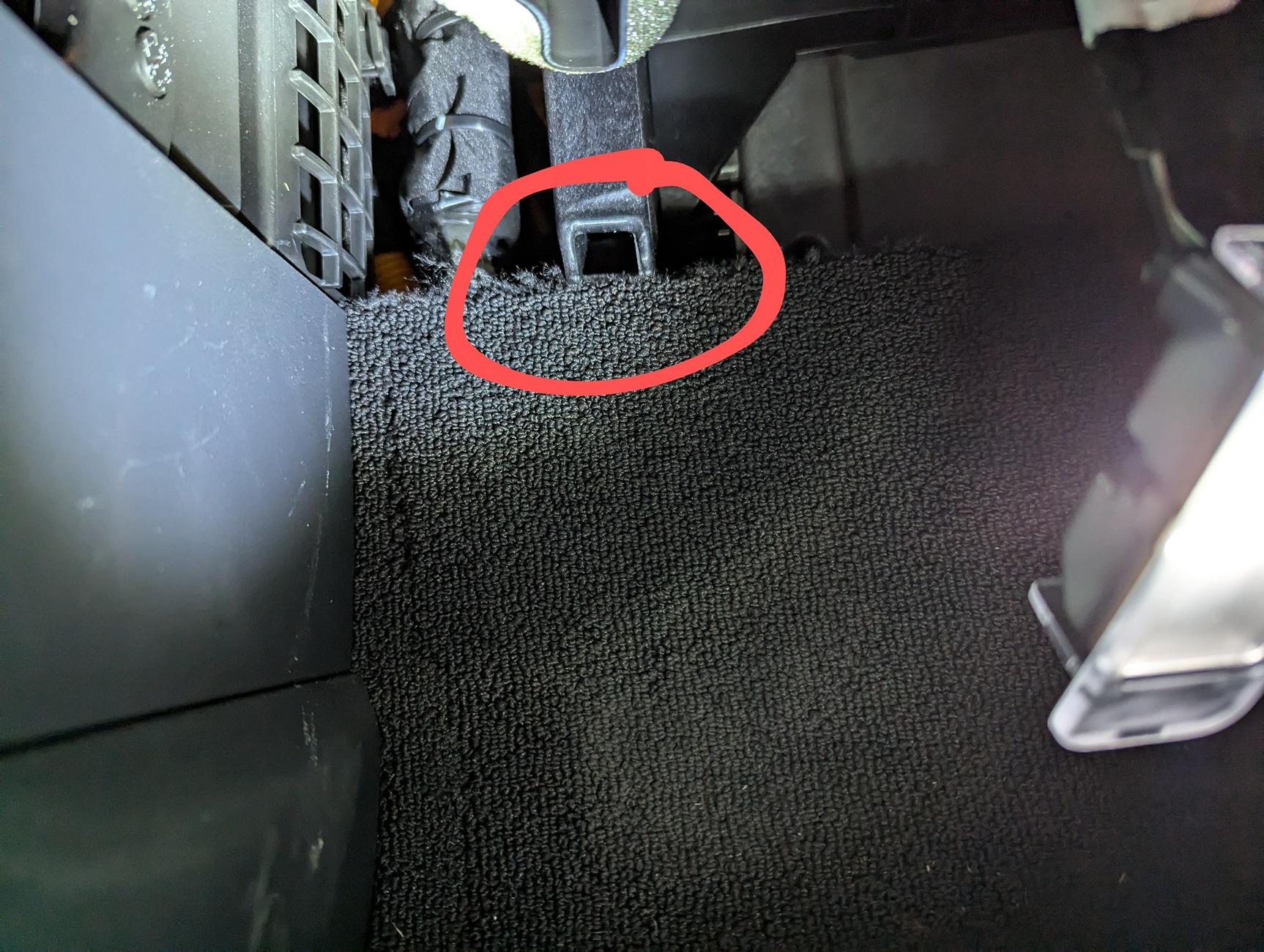

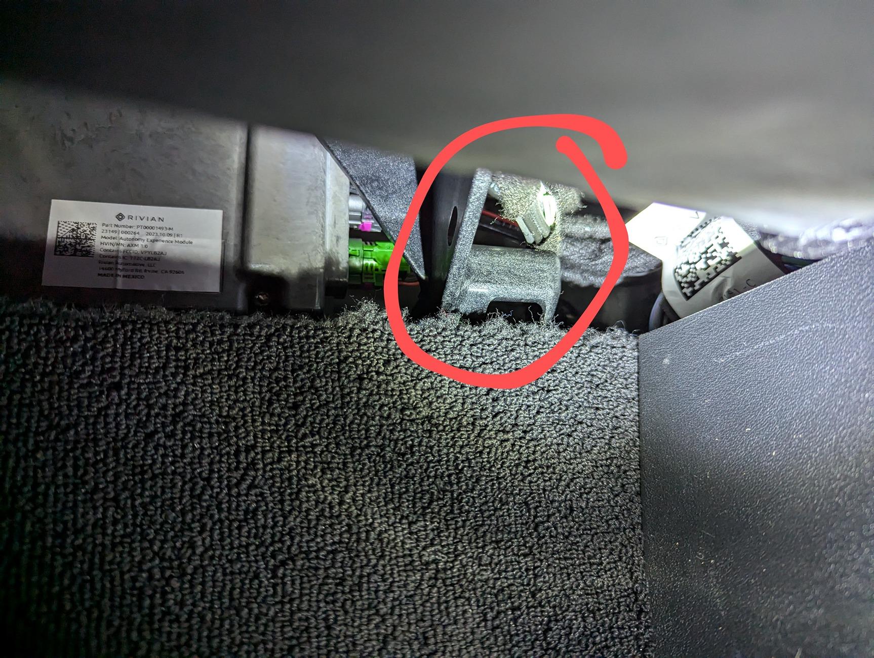

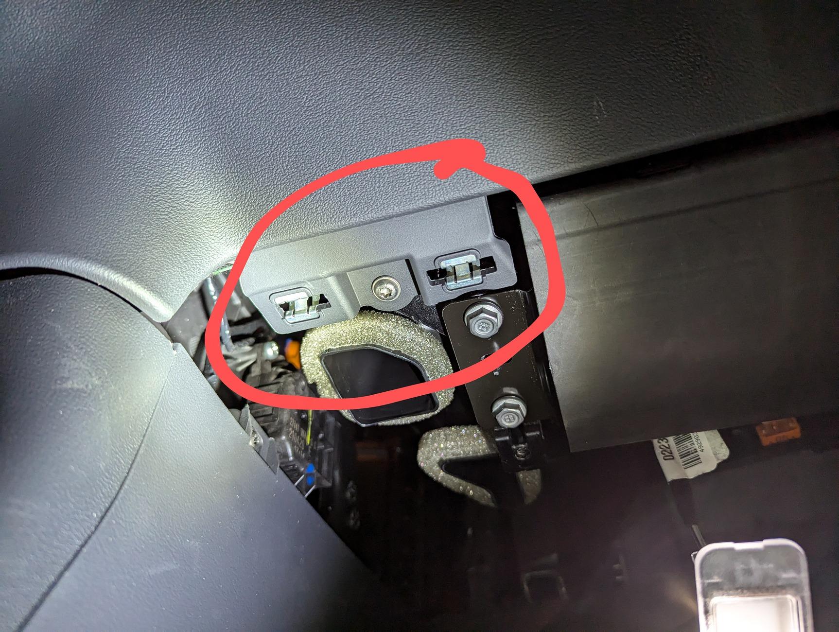

Well, I decided to just dive in...
Here are the locations of the clips
Back side, towards the outside of the vehicle:
Rivian R1T R1S Interior passenger-side fuse box PXL_20240817_162235773~2
Back inside clip:
Rivian R1T R1S Interior passenger-side fuse box PXL_20240817_162239085~2
Front outside clips:
Rivian R1T R1S Interior passenger-side fuse box PXL_20240817_162222257~2
Front inside clips:

Fuse panel itself:
Rivian R1T R1S Interior passenger-side fuse box PXL_20240817_162249304~2
i started by taking out the screws, the popping the back clips out. I was able to do this just by pulling on the panel itself, then with a little more force I was able to take out the front clips. I never needed a trim tool, and none of the clips broke.
I did have to pop the whole foot well light out of the panel, as I couldn't get the cord itself out of the light without feeling like I was going to break it.
Was able to get to the panel and tried putting in my fuse tap (F64), but wasn't able to get it to power the screen I am installing. However, the USB-C ports next to the rear screen seems to be powering it just fine. Not sure what's up with that...
