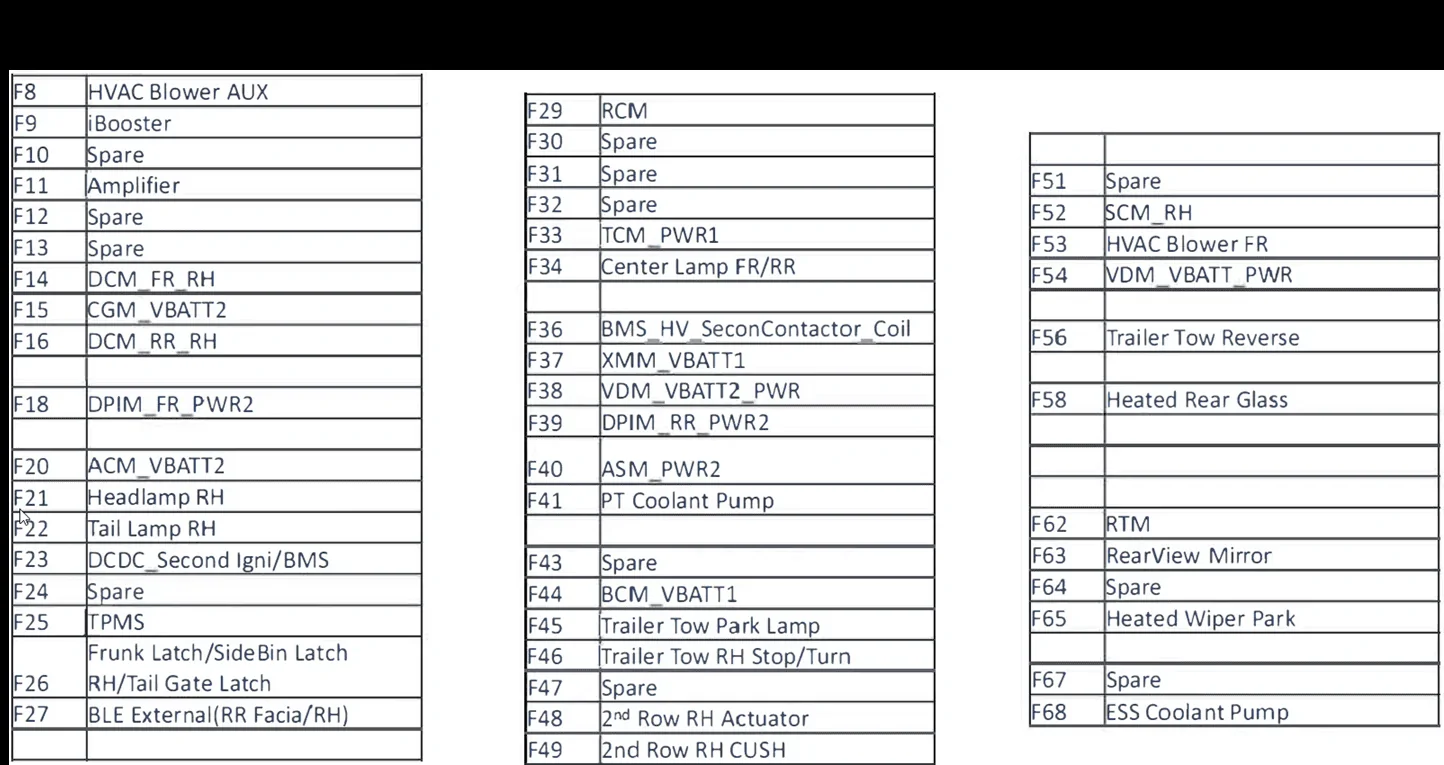

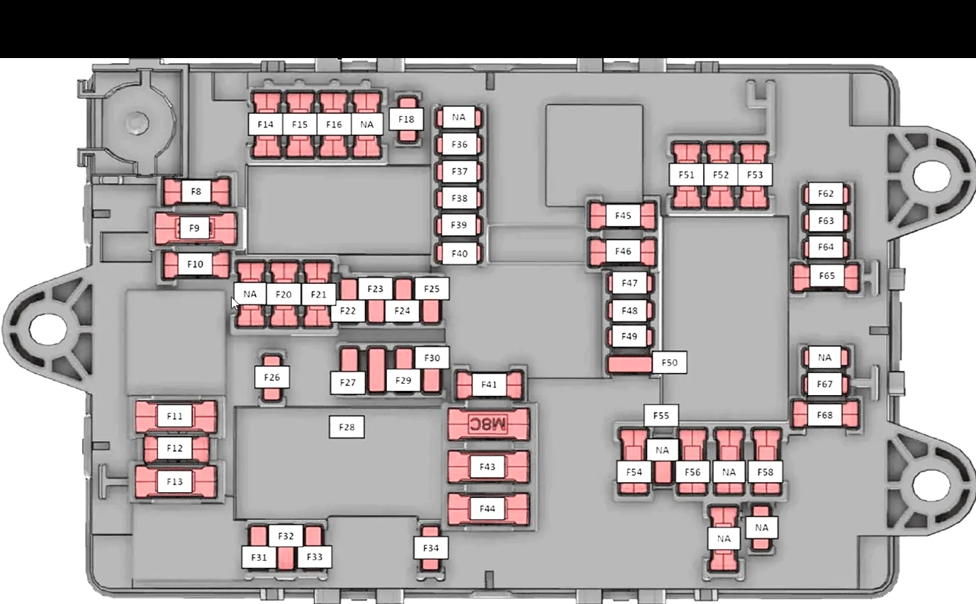

I see a bunch of posts about hitting the driver's panel for fuses that go to sleep/switched. Any on the passenger side that also are switched?
Looks like the R1T and R1S share the same fuse panels, with that in mind.. check out the R1T passenger side fuse panel below and the circuit description key below that.
I'd look at fuse F11 "Amplifier" as that is definitely switched.
Rivian R1T R1S Interior passenger-side fuse box 1704210404189
Rivian R1T R1S Interior passenger-side fuse box 1704210424504

Thanks - hoping for one the standard sized fuses. F11 is a 40amp proprietary fuse.

I ordered the hardwire kit from the dashcam manufacturer so I assume the provided cable and fuse taps will be sufficient. In reviewing the list of fuses, I was hoping to tap the passenger side but it's unclear which fuse to tap. I've seen F11 (amplifier) mentioned a few times. Have there been suggestions on other passenger side fuses to tap that will supply sufficient power when "ignition" is on?
Otherwise I think I might go with one of the 12V Port fuses. Do we know which is which? I'm unclear what F46, F51 and F54 for the R1S are. My guesses below.
  1. F46 12V Port #1 Frunk/Under Dash?
  2. F51 12V Port #2 Under second row screen?
  3. F54 12V Port #3 (GG Tunnel for R1T, but what is it for R1S?)
  4. F59 12 V Port #4 R1S Luggage
