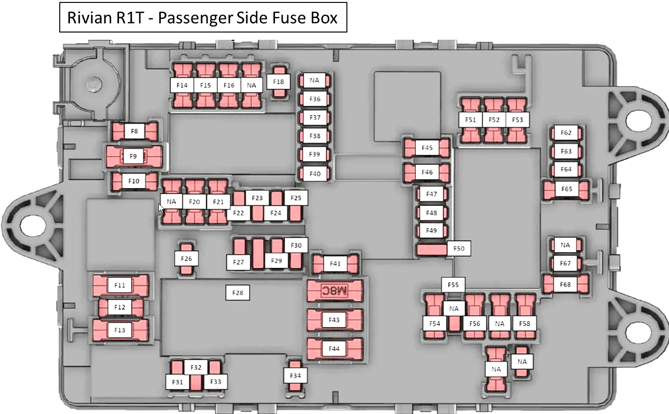

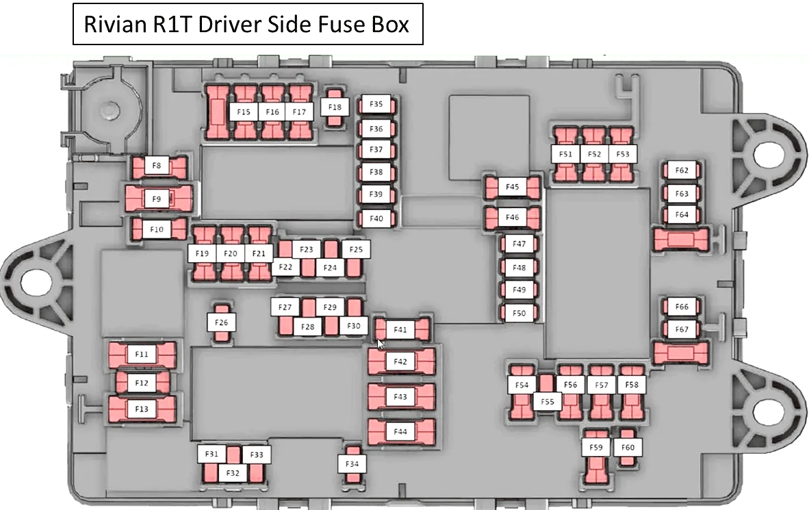

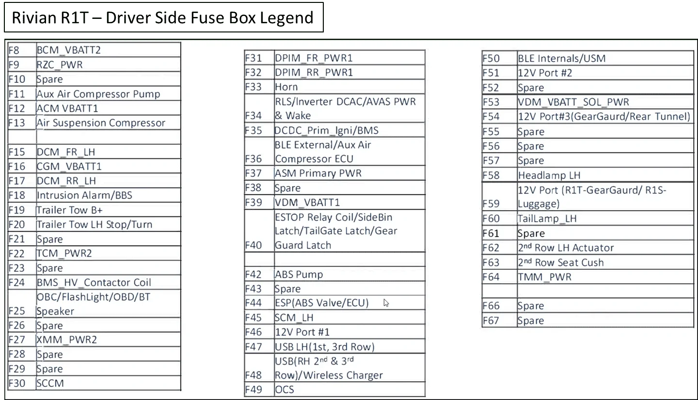

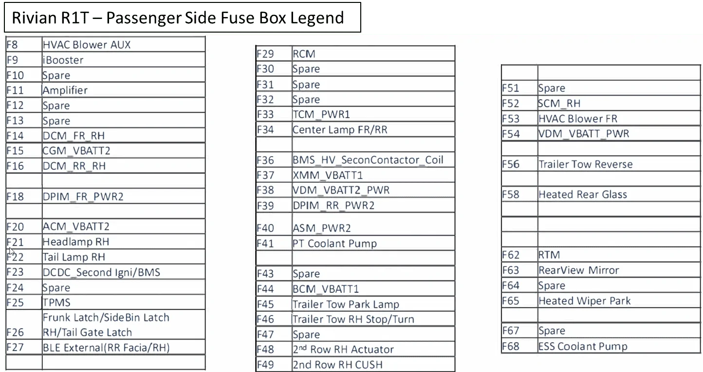

I found these on Reddit a while ago, probably good to have them archived here as well.
Rivian R1T R1S Interior passenger-side fuse box Rivian R1T Driver Side Fuse Box
Rivian R1T R1S Interior passenger-side fuse box Rivian R1T Driver Side Fuse Box Legend
Rivian R1T R1S Interior passenger-side fuse box Rivian R1T Passenger Side Fuse Box
Rivian R1T R1S Interior passenger-side fuse box Rivian R1T Passenger Side Fuse Box Legend

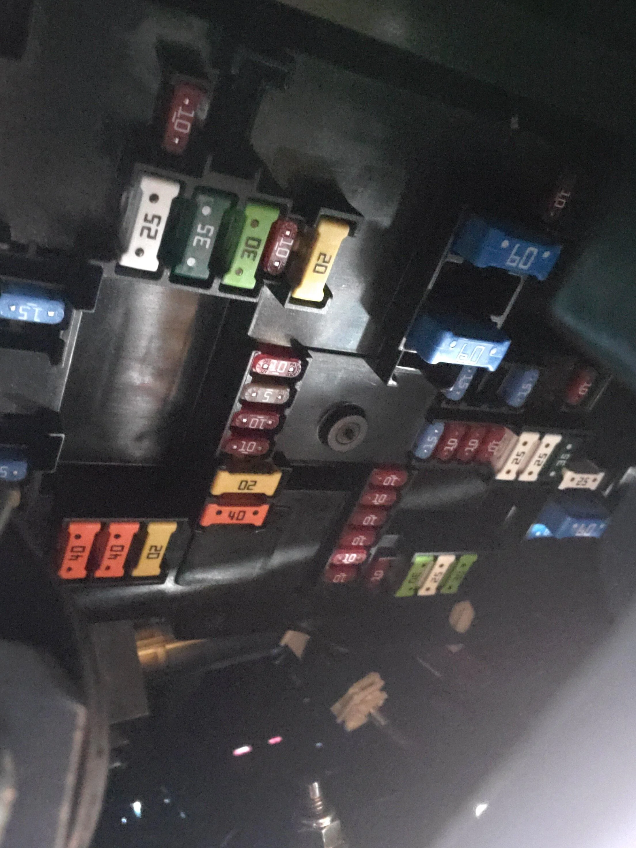

Here is a picture of my R1S driver's side fuse panel. I did not have to remove any panels to get this angle - taken upwards from just in front of the brake pedal, next to the steering shaft, cell phone in selfie mode.

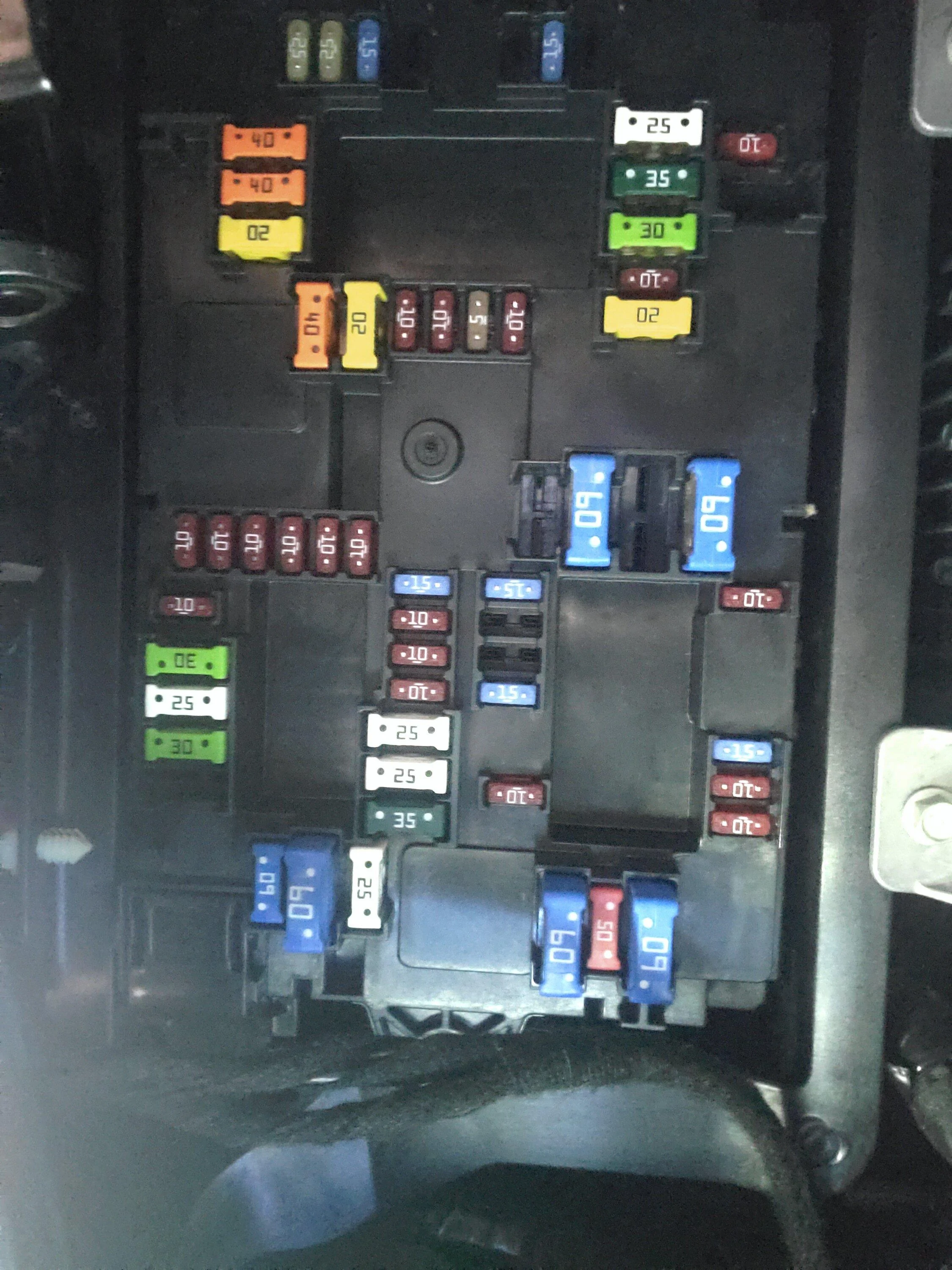

Here is a better picture of my driver's side fuze panel. R1S VIN ...011055
I am going to check a few circuits before posting my spreadsheet as there are some anomalies between what I see and what is in the previous diagrams.
