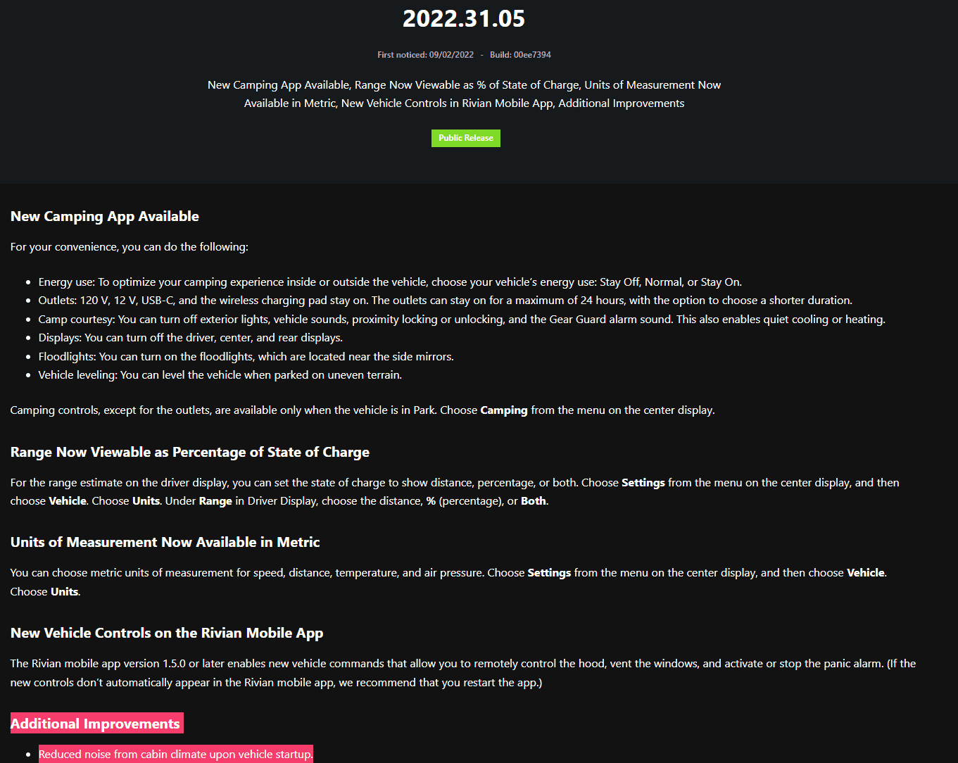

FWIW, and I haven't seen this mentioned here recently: I had noticed the extra loud compressor last summer, but update 2022.31.05 actually made it a lot better. The recent 2023.22 update has perhaps reversed some of that that, in exchange for more cooling, faster. So I do think software plays a factor.
