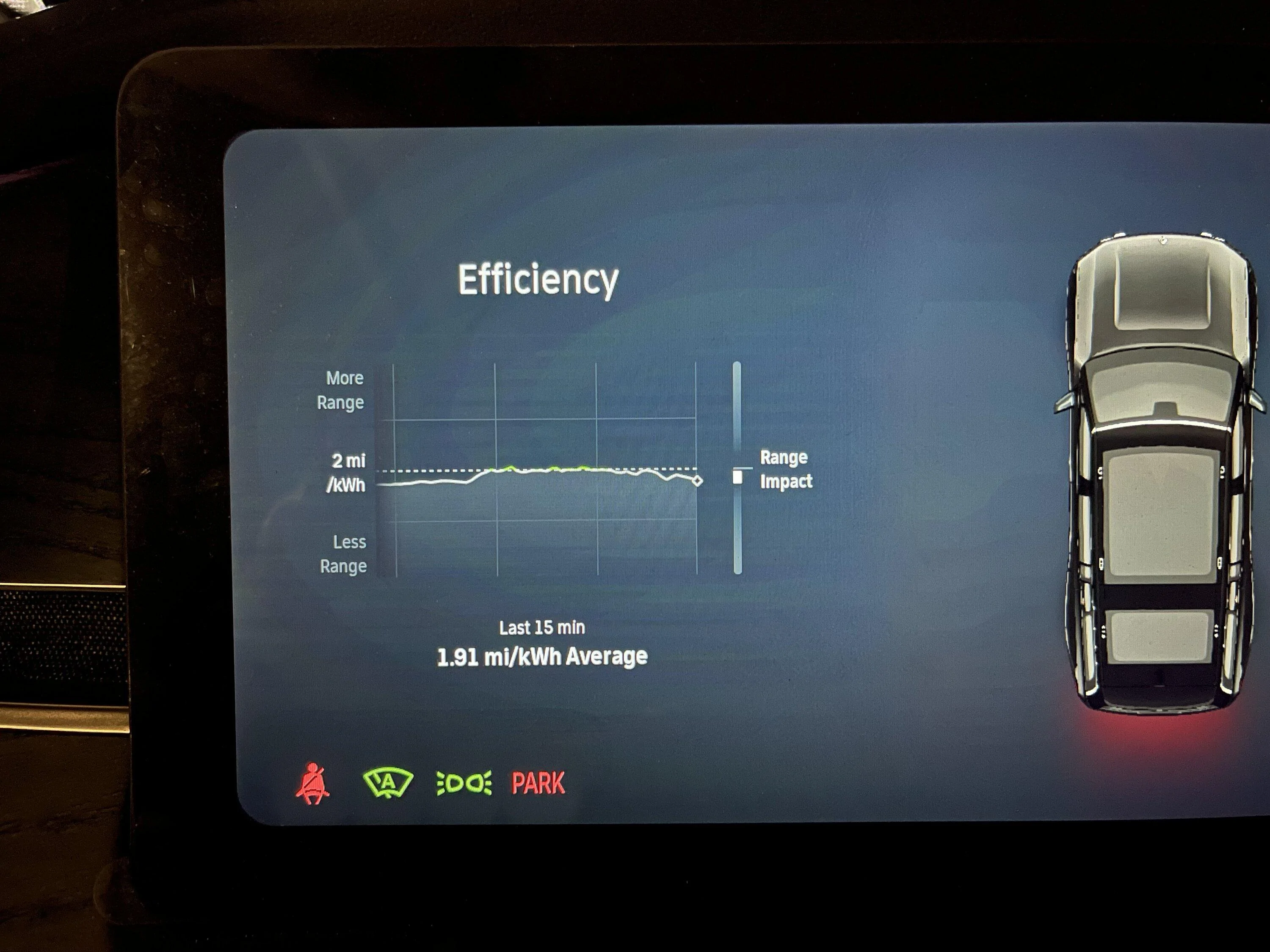

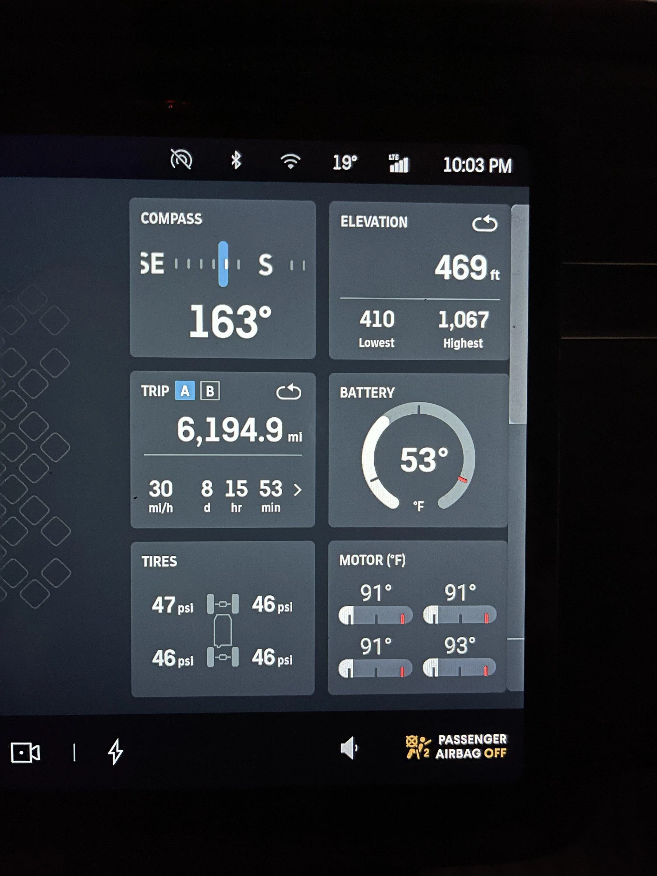

I’m loving the cold weather performance.
I used pre-condition feature and the update came just in time for 14 degree temps.
Before warming up the vehicle, cabin temps showed 41 degrees in my garage.
I’m getting 1.91 mi/kWh on 20” AT driving mainly on the highway between 65 mph and 74 mph. This is with snow mode which has low regen.
current temps outside show 19 degrees on the dash with battery at 53 degrees.
