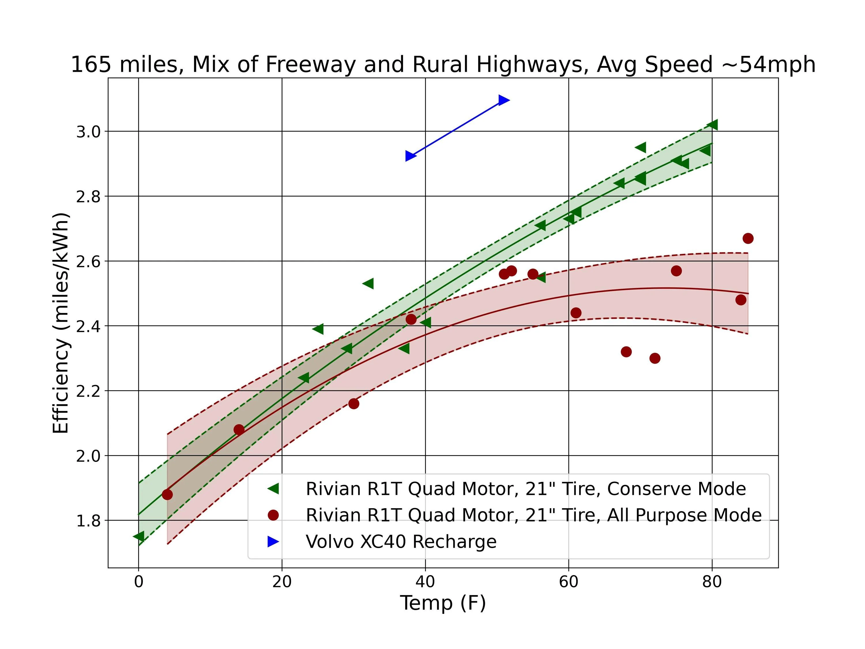

I want to caution everyone to remember that this OOS video/"test" is just a single data point at one specific condition. All these you-tubers do a single "test" and make a video to state "this is the answer".
An EV is a complex device with many competing variables and components. Temperature is one huge variable and how the different mechanical systems respond can change the result significantly. For example, in the All Purpose vs Conserve efficiency data I've posted several times (see below) the results change significantly with temperature. If somebody like OOS does a single one-off test at 70 degrees you get one answer (Converse is much better than All Purpose). But if they did the test at 40 degrees you get a very different answer (No difference).
We really need data across a wider range of operating conditions to make meaningful comparisons. Single data points won't do it. Engineers don't design systems based off single data point tests, consumers shouldn't make large decisions off of single data point tests either.
Rivian R1T R1S Max Pack vs Large Pack range test (by Out of Spec) R1T efficiency vs tem
We really need data across a wider range of operating conditions to make meaningful comparisons. Single data points won't do it. Engineers don't design systems based off single data points tests, consumers shouldn't make large decisions off of single data points tests either.
I agree with this...its a datapoint. I can get 2.6 mi per kwh fairly easily in my quad conserve in mild conditions going 65-70.
I have enjoyed a lot of OOS content but this whole series of videos is disappointing from OOS.
He says he is not but most definitely is implying Rivian is strong arming or trying to discredit his testing procedures. He also implies their doing shady things with EPA.
It's too much opinion and not enough fact. Mostly a regurgitation in the last video of things that have already been discussed either here or by other YouTubers.
It's disappointing. I mean why share all that stuff about Rivian communications? I'm sure Rivian didn't give him the liberty to speak for them.
Not sure what to think about this whole series of videos. ?
I agree multiple tests would be nice but max vs. large is almost entirely a capacity discussion (perhaps max is more efficient in the city with both motors engaged). We know the capacity difference so we know the expected range impact if we know efficiency.
It's not a definitive test, but it's done in the real world with all the real world variability that comes with a 300mi drive (wind fluctuations, speed fluctuations, elevation, temperature, etc.)
And given that the 2 trucks were treated in identical ways, there's no reason to believe one was given more favorable treatment.
The resulting data is in line with Rivian EPA data.
The result is that, with a relatively high degree of confidence, the max pack has 20-25mi more range on a long distance drive at 70mph in cool temperatures.
Based on everything we currently know, it's unlikely for this delta to be significantly different at different temperatures or modestly different speeds. There is a small chance that at very high (or as as suggested by EPA data very low) speeds the difference may grow. But I would not count on it.
Kyle is trying to be very clear on what is speculation vs fact. All the data shows the max pack capacity doesn't account for the entirety of the advertised range difference. And that's OK, but people should know.
