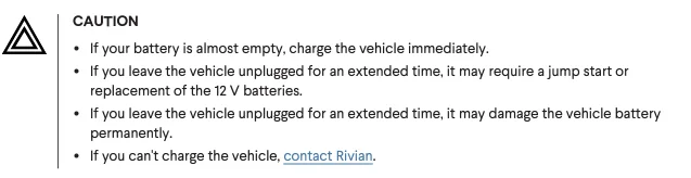

If this is directly from Rivian,”12-volt batteries may be damaged or drained if the vehicle is left unplugged for an extended time.” then I think they need to define “an extended time” as an objective duration (e.g. more than 2 weeks) in order to enforce it.
I don't think they do, because it's highly dependent on the SoC you left the vehicle at and what you had the vehicle doing. If you left it for 3 weeks at 5% SoC, it should be obvious enough that it could potentially cause issues from being unplugged, the warranty guide is just informing you of that. Rivian should be indicating this requirement in their owner's guide, however, and they are.
Rivian R1T R1S More 12V Problems - Always Keep Your R1T Plugged 1691079764286
I should note that the originally quoted text was part of the update of their warranty guide that happened on June 7th, 2023. The language isn't present in previous warranty guides so it technically only applies to vehicles sold since then. Rivian has done a lot to reduce instances of dead 12V batteries that they caused, and they likely have improved their ability to determine fault here as well.

If it depends on the SoC then they should write guidance in SoC% rather than time. Their Caution wording including “almost empty” and “extended time” makes the content nearly useless. We all know people who think almost empty = 1% and other people who think almost empty is anything below half.
In the final part you quoted, what is “long- term,” considered? Again, this should probably be specific. e.g. More than 3 days or when down to 20% charge, whichever comes first.

Hey All,
TLDR - Always Keep Your R1T Plugged In
I haven't posted in a while since I've been generally happy with my R1T. However I am pretty incensed right now and wanted to let you all know about my experience.
I left my vehicle unattended for roughly 8 days, from July 25 until today August 2nd. It wasn't plugged in and I had left it with 80% charge.
When I checked last night August 1st, I still had 64% left, and this morning August 2nd, it was at 62%.
I saw a bunch of 12v errors and vehicle battery issues and proceeded to call Rivian Service. They had me reboot the vehicle and when it came back up, my vehicle showed 46% battery and more critical faults.
I couldn't put the vehicle in drive since the brakes wouldn't release even though it recognized my key and I lost power steering. The brakes also made a nice crunchy sound and was very hard to depress.
I was told depending on what they find at the service center that I may be responsible for the associated costs for this repair and car rental because I didn't have my R1T plugged in for the week I was away.
I'm awaiting a tow now to the service center even though their earliest appointment is for Aug 11.
Thought all the 12V issues were solved but I guess they aren't.
I'm really starting to sour on Rivian.

My truck is now back in my hands. The secondary 12V had an internal short which they replaced under warranty and I was told there is no charge for the tow and rental.
I still don't understand the CYA language especially when I clearly didn't drain the HV pack and let the 12V die.
