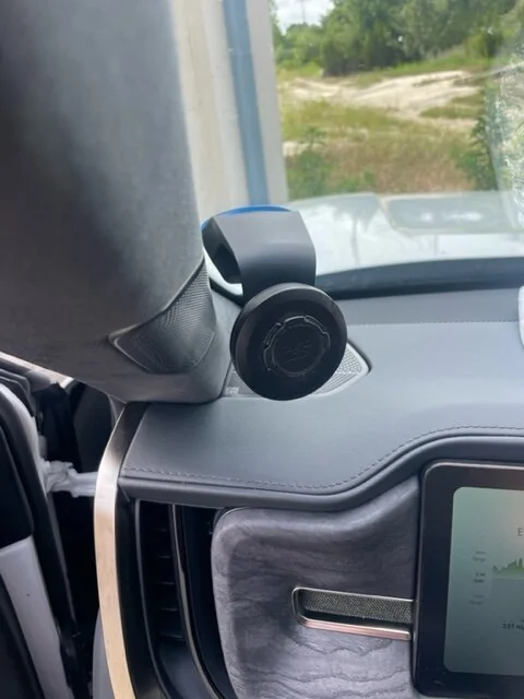

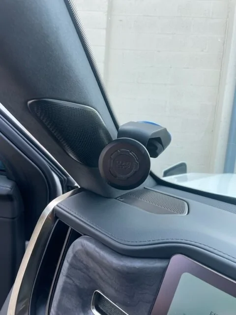

I use a Quadlock case, wireless mount and car mount for my travels, and dam near everything (Car, all of my bikes, etc.) and have been very happy with their products. I have their wireless charger mount in my R1T. It nice to not have to plug anything in. I will wire up the power to the R1T this weekend as I have been using the mount alone for a few weeks to determine if its the best solution.
https://www.quadlockcase.com/
Rivian R1T R1S Mounting a cell phone.  Has anyone done it? Quadlock Mount 1
Rivian R1T R1S Mounting a cell phone.  Has anyone done it? Quadlock Mount 2

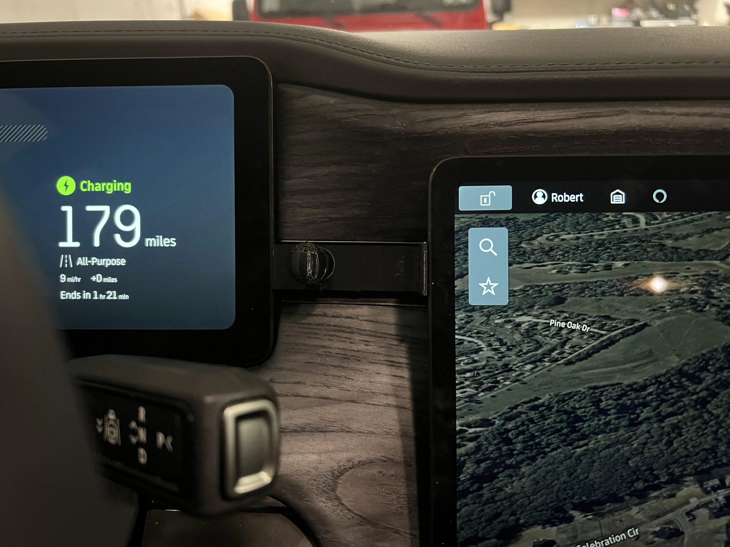

Update:
It works and it's clean.
I'm a fucking wizard, Harry. ?
The print itself was pretty crap as I had the printer speed turn up to 11 to get it done tonight. I need to tweak the ball just a bit (maybe 1.5mm) to bring it back a little further toward the dash. Both mounts clear the screens, wood, AND the stalk. Both are seemingly as secure as I hoped.
The phone is somewhat obscured by the wheel though - not sure how much that will bother people.
More, including phone in the doc pics, soon as it's 2:00 AM and I need to get to bed.

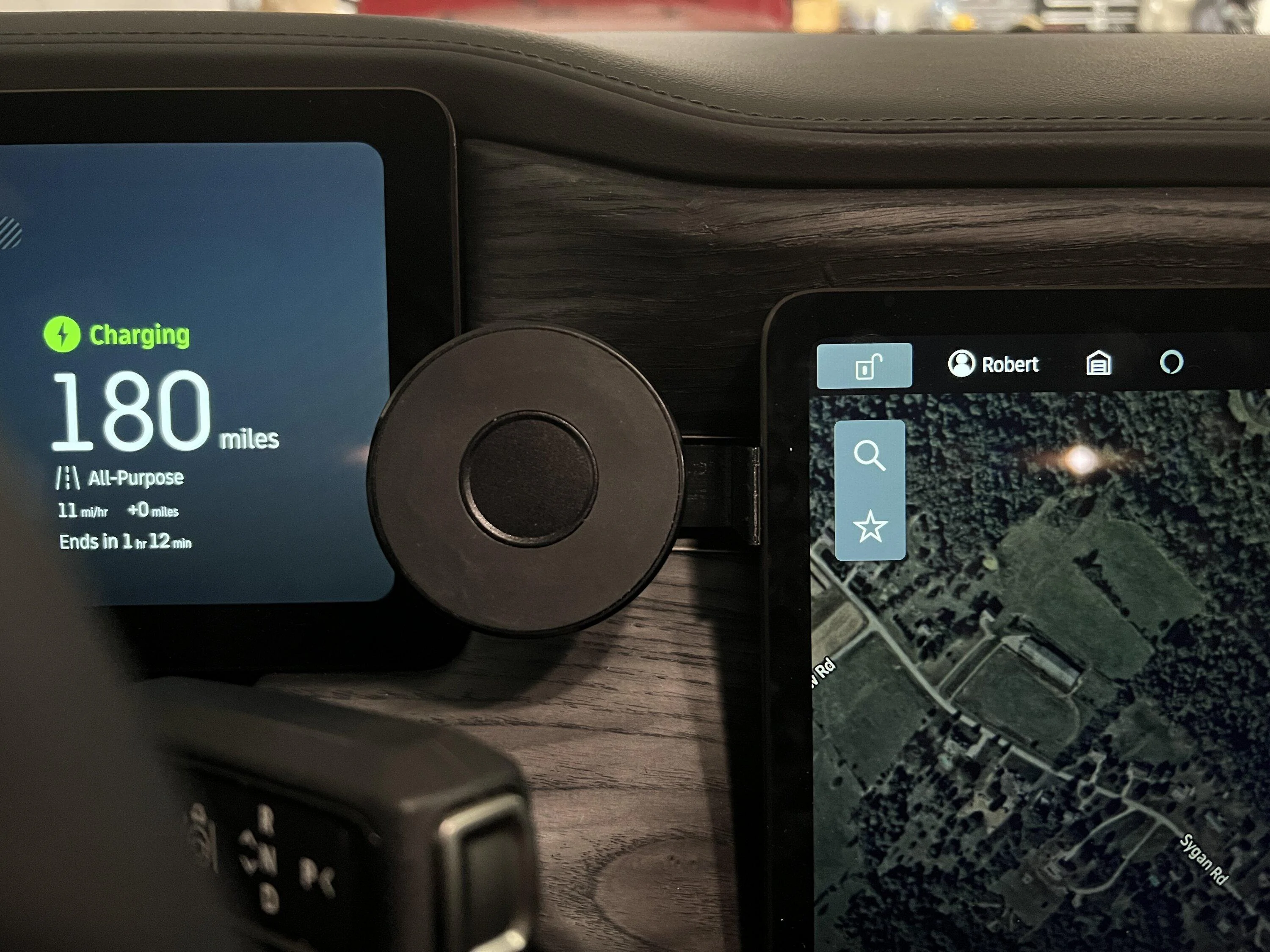

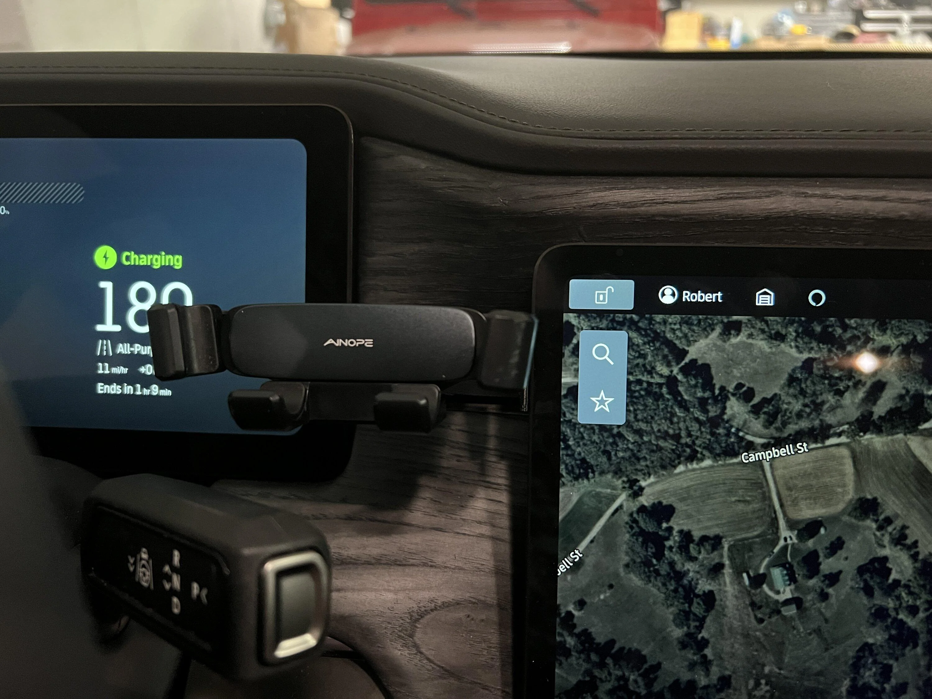

Rivian R1T R1S Mounting a cell phone.  Has anyone done it? ezgif.com-gif-maker (3)
So, it seems to work well for regular driving, despite the type of mound that is on there - Magsafe or Gravity. (gravity shown animated above) Keep in mind that this is with a comparably light iPhone 13 Pro - larger phones may have issues, but I don't have one to test.
The view of the phone is obstructed as you can see.
Based on what I see, I've already updated the model to have the 17MM ball 1.5MM closer to the dashboard. That will give the gravity mount just a bit more room and will make everything attached to it slightly more stable.
The 3D model, like all of my other designs, is posted on Thingiverse and is available here. Please keep in mind that this is only for the ball mount itself, and you'll need a actual phone holder to attach to it. Also - this is VERY much an early WORK IN PROGRESS - it might not really work as I haven't tested it thoroughly.
If people are interested in purchasing one, I'm going to do a very small production run of about 25 of these. They'll go for between $10-$12 each on Riviparts.com. (that's my upcoming site that I'll be selling the other small-batch 3D printed items I've designed, like the sunglass holder and Magsafe pad) If you're interested in testing one, the site will be live later in the month.
Feedback is very, very welcome.

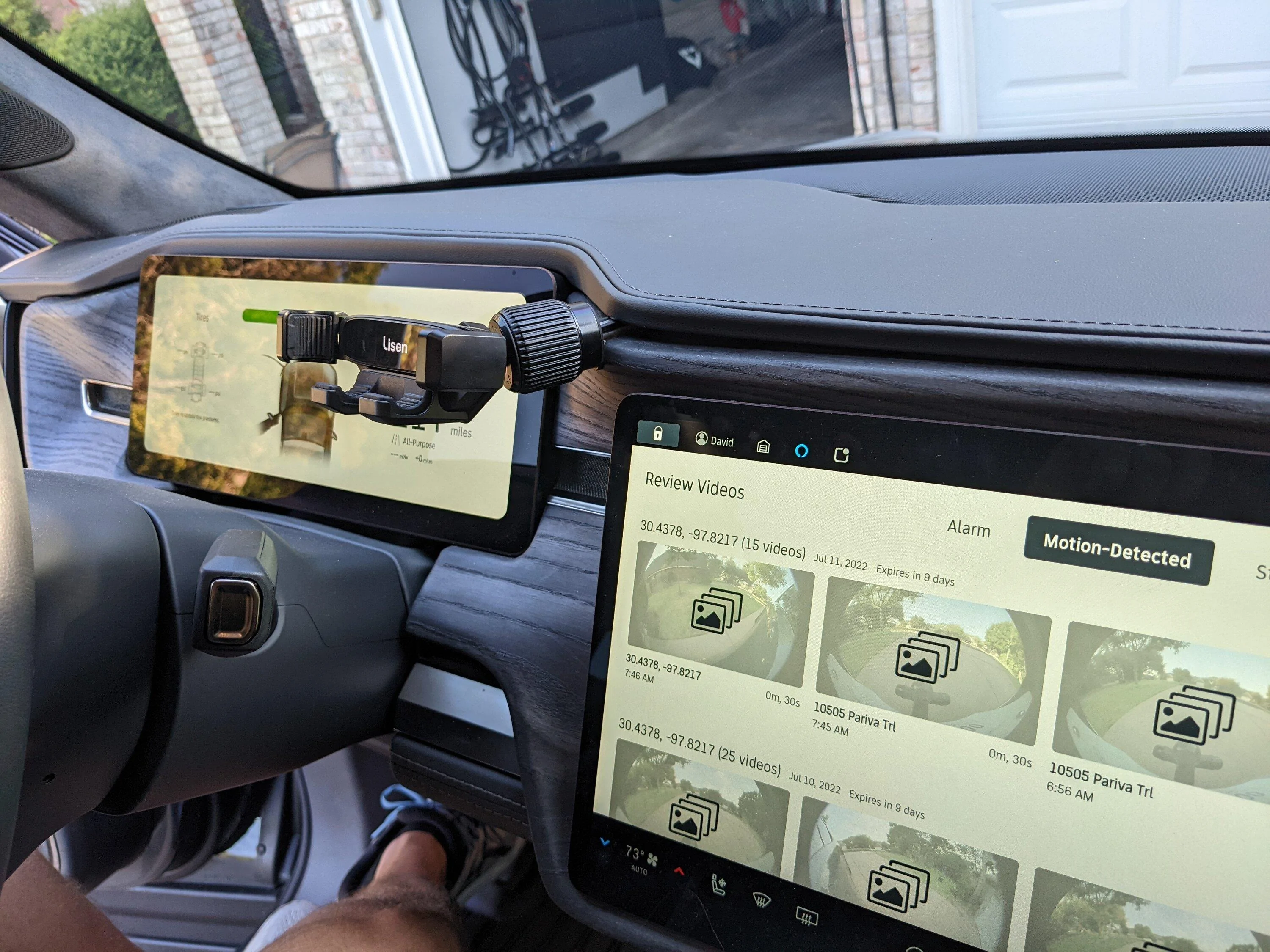

I used the following. The cons are it does pull up in the dash a bit and a bit low (wheel covers bottom half).
But it sits above the stalk with phone and doesn't block either screen.
https://a.co/d/crLRLwE
