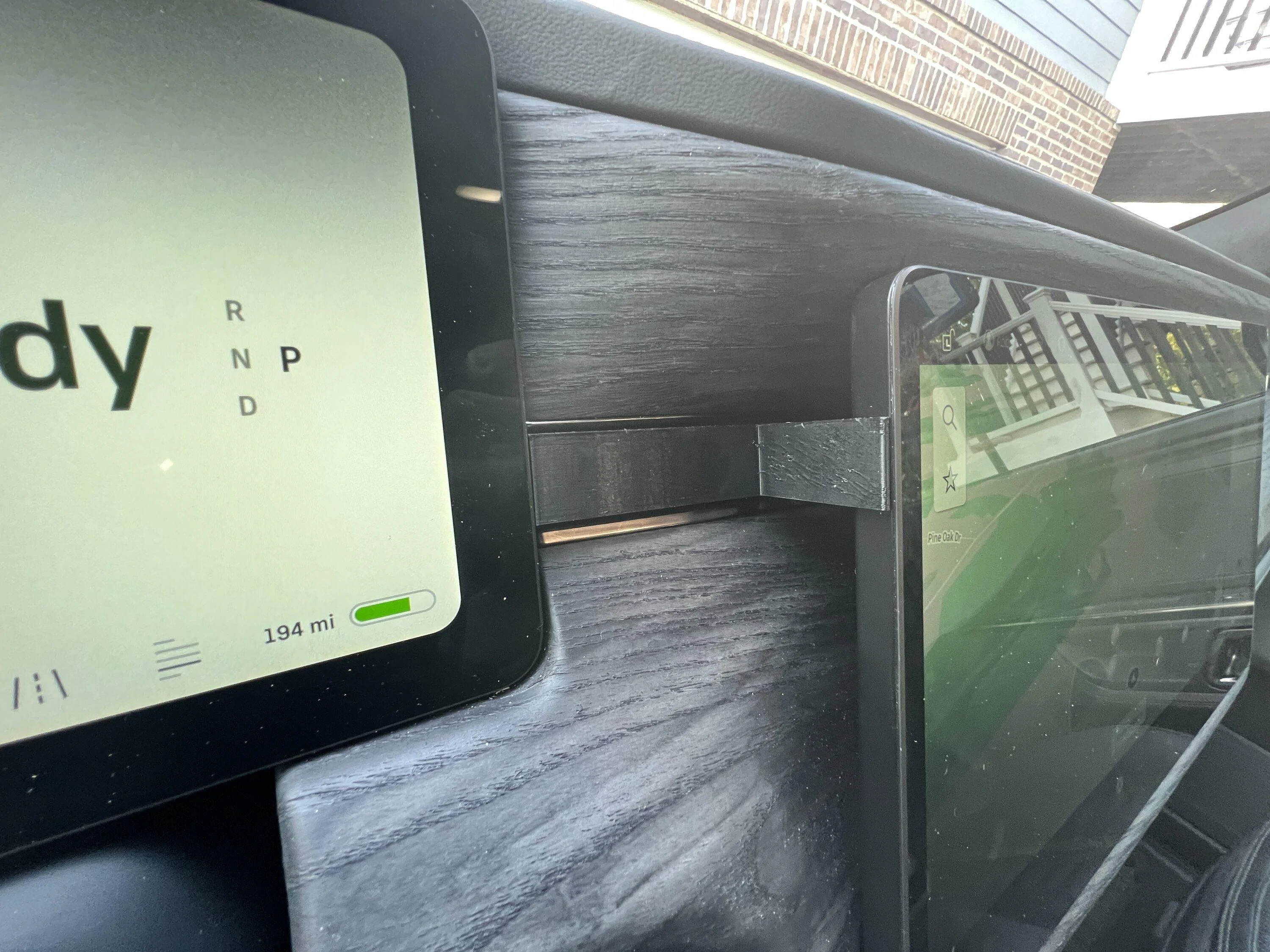

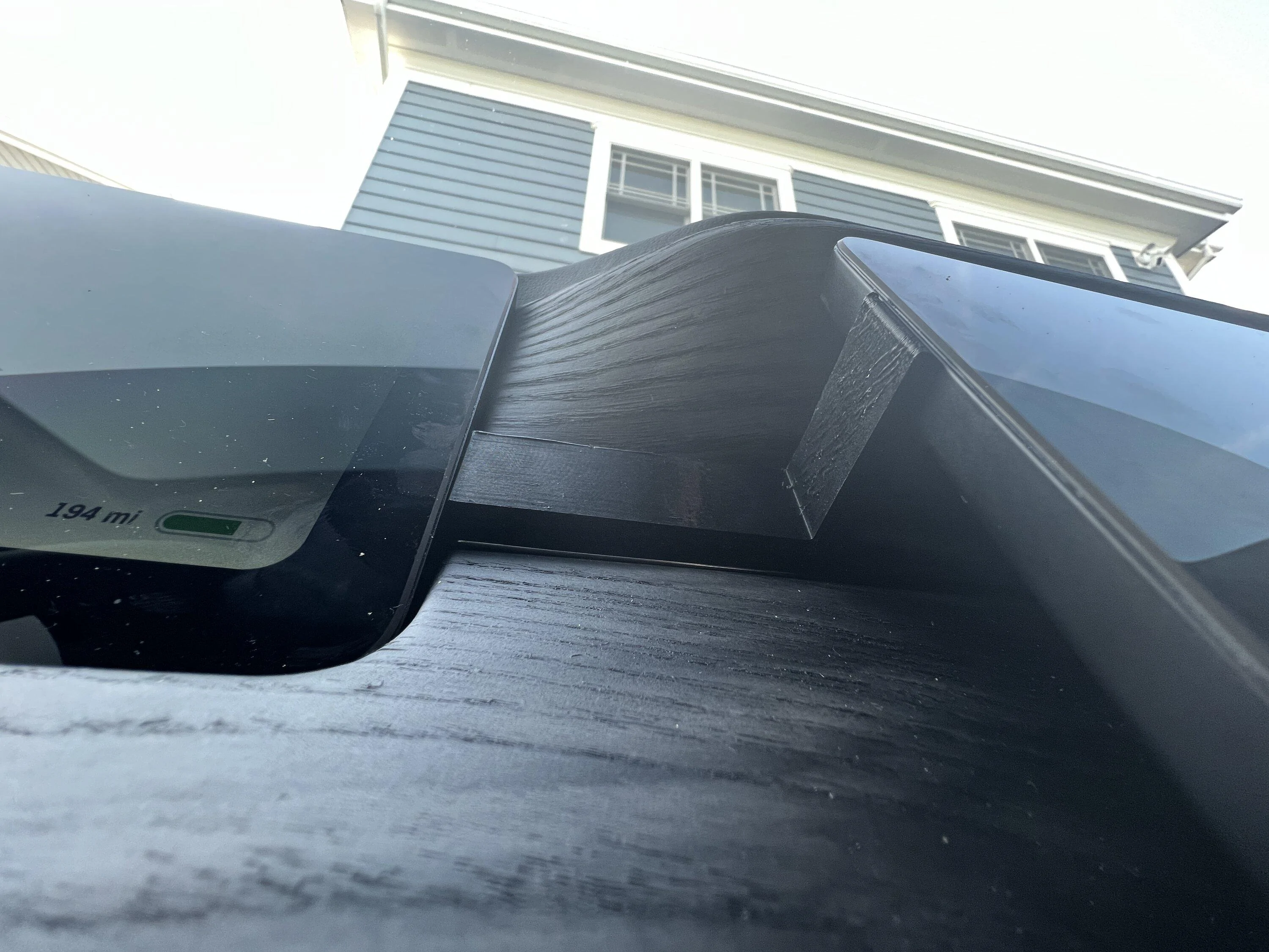

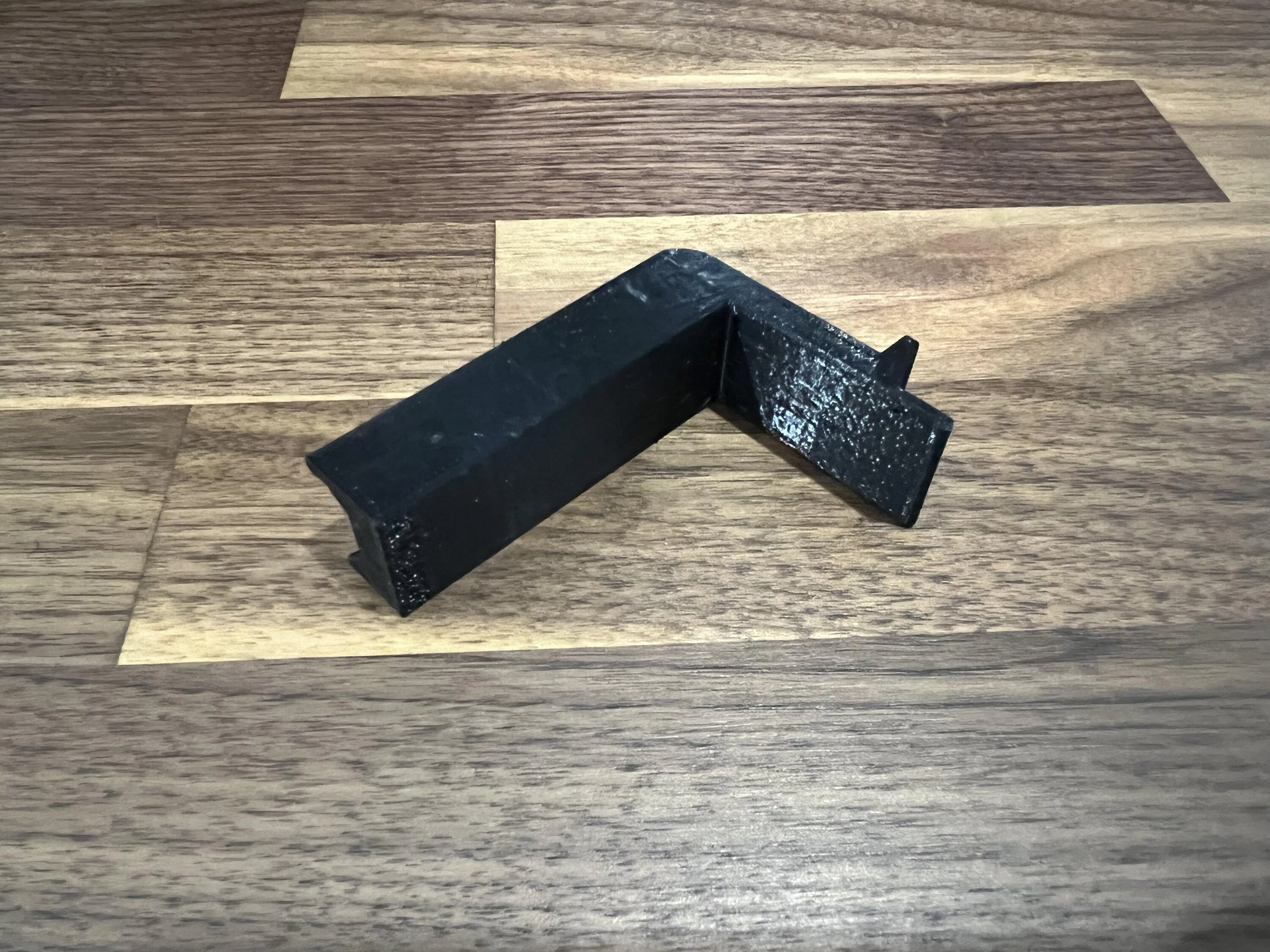

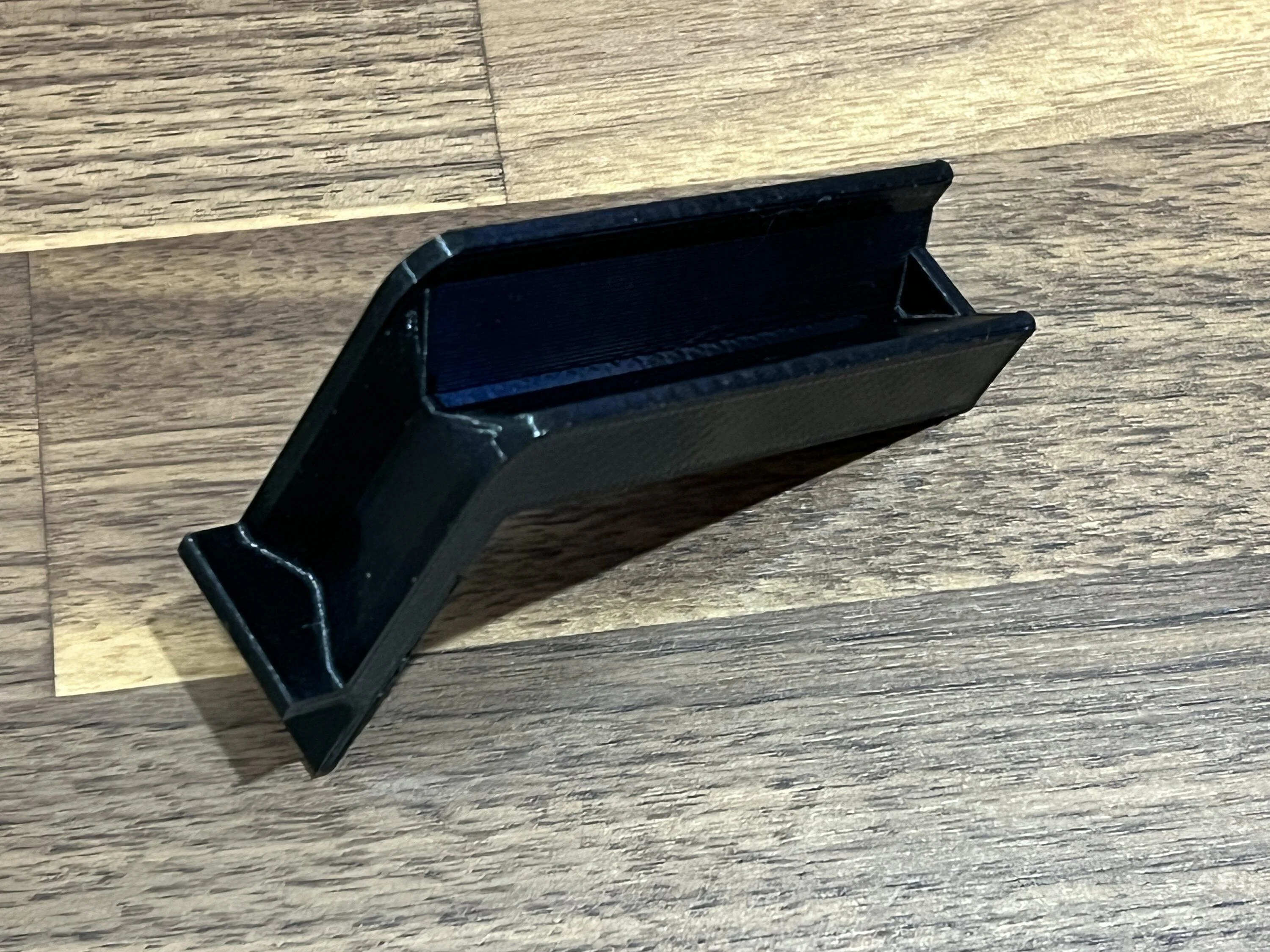

I've also been working on something for this, thinking that mounting a phone as shown in the above location would be ideal. Ideally, I don't want to use any adhesive, so I opted for basically wedging something in.
The left is held in place by the gauge cluster - the right and front to back by the infotainment screen. It sits in the trim channel for up and down. Overall, it seems to be pretty stable, but I haven't tested it significantly yet.
Rivian R1T R1S Mounting a cell phone.  Has anyone done it? IMG_0497
Rivian R1T R1S Mounting a cell phone.  Has anyone done it? IMG_0499
As pictured, it's basically a very early prototype to see if the approach will work. I still have some work ahead:
  1. The dimensions need refined. It fits, but only after I trimmed it by hand. The bend around the infotainment screen also needs some help, as you can likely see.
  2. I am likely going to need to bring out the mounting surface as it's pretty recessed in there, especially considering the overhand of the dash pad as seen in the last photo.
  3. I'll need to build in some attachment mechanism. I can either capture a nut in there for ram ball mounting, or cut slotting in there for one of the mounts that are designed to attach to a vent fin like this - mount
All this said, I'm still not sure if this is the best place for a phone to be mounted. It's slightly obscured by the wheel, and besides that, I don't generally mount my phone on the dash.
Feedback is very, very welcome. If people are interested, I'll likely produce these too.

looks great, i'd be interested in something that includes a ram 1" ball mount
that location is good because it also hides the bad wood bend corner when a phone is mounted

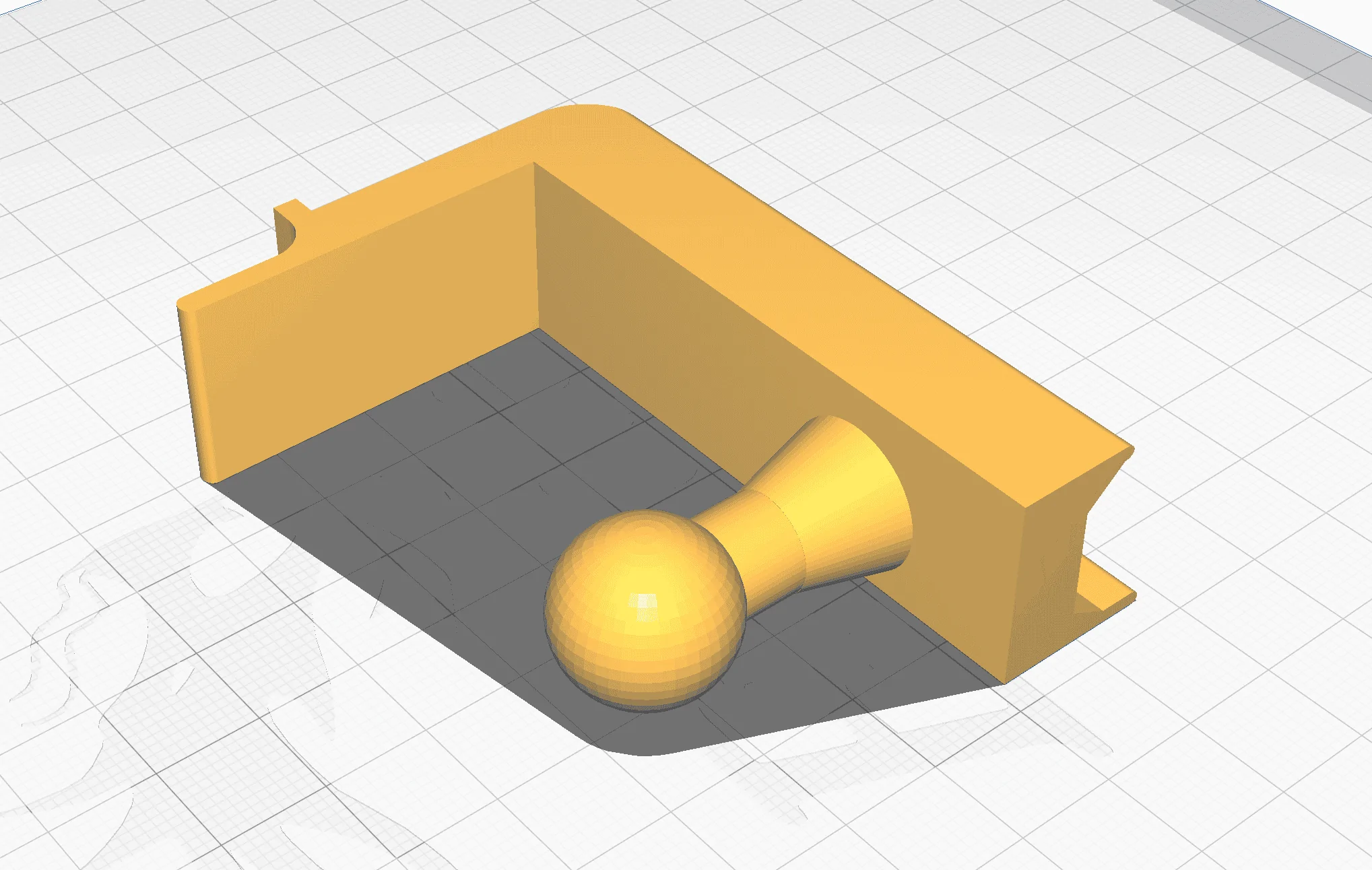

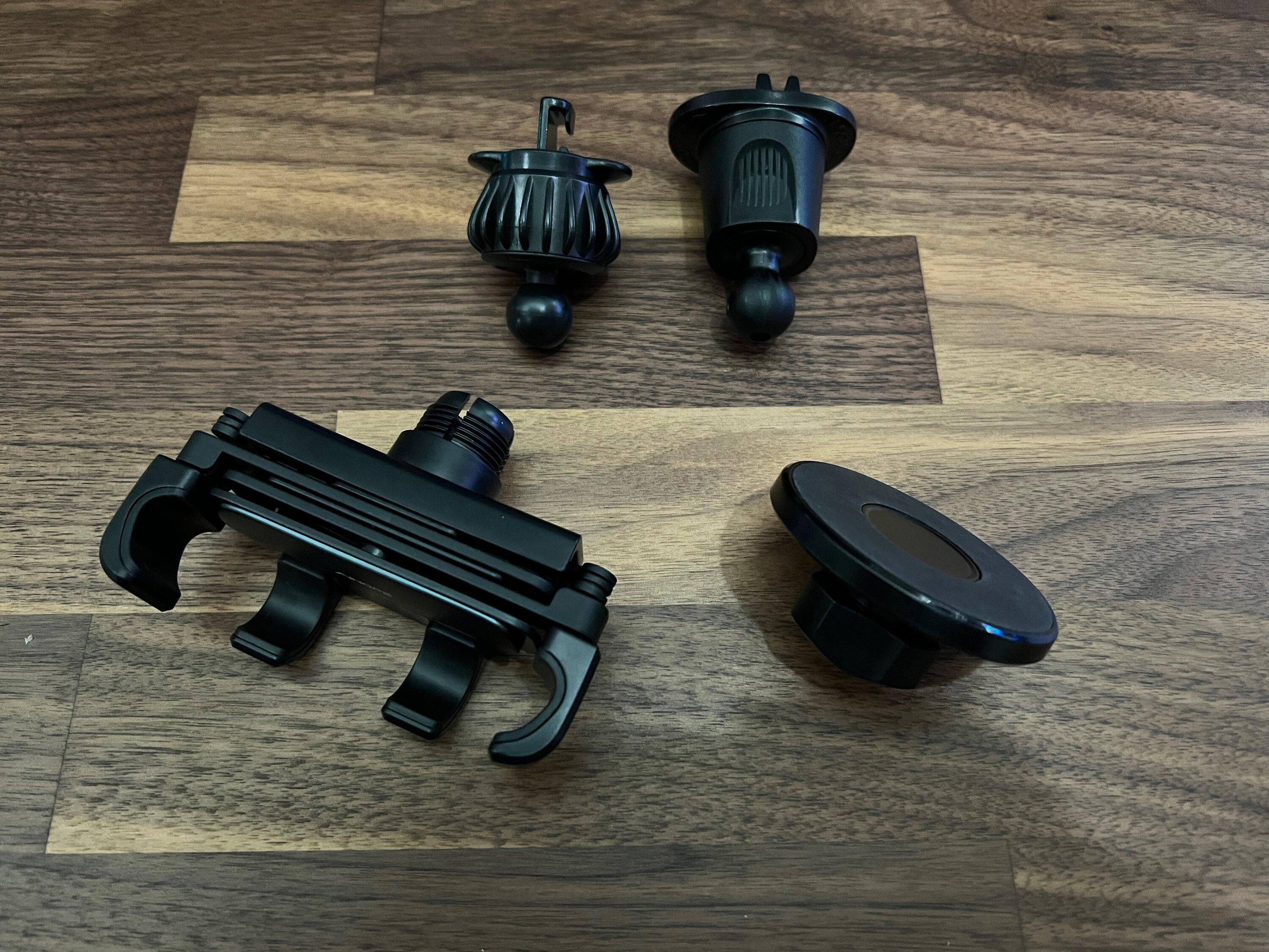

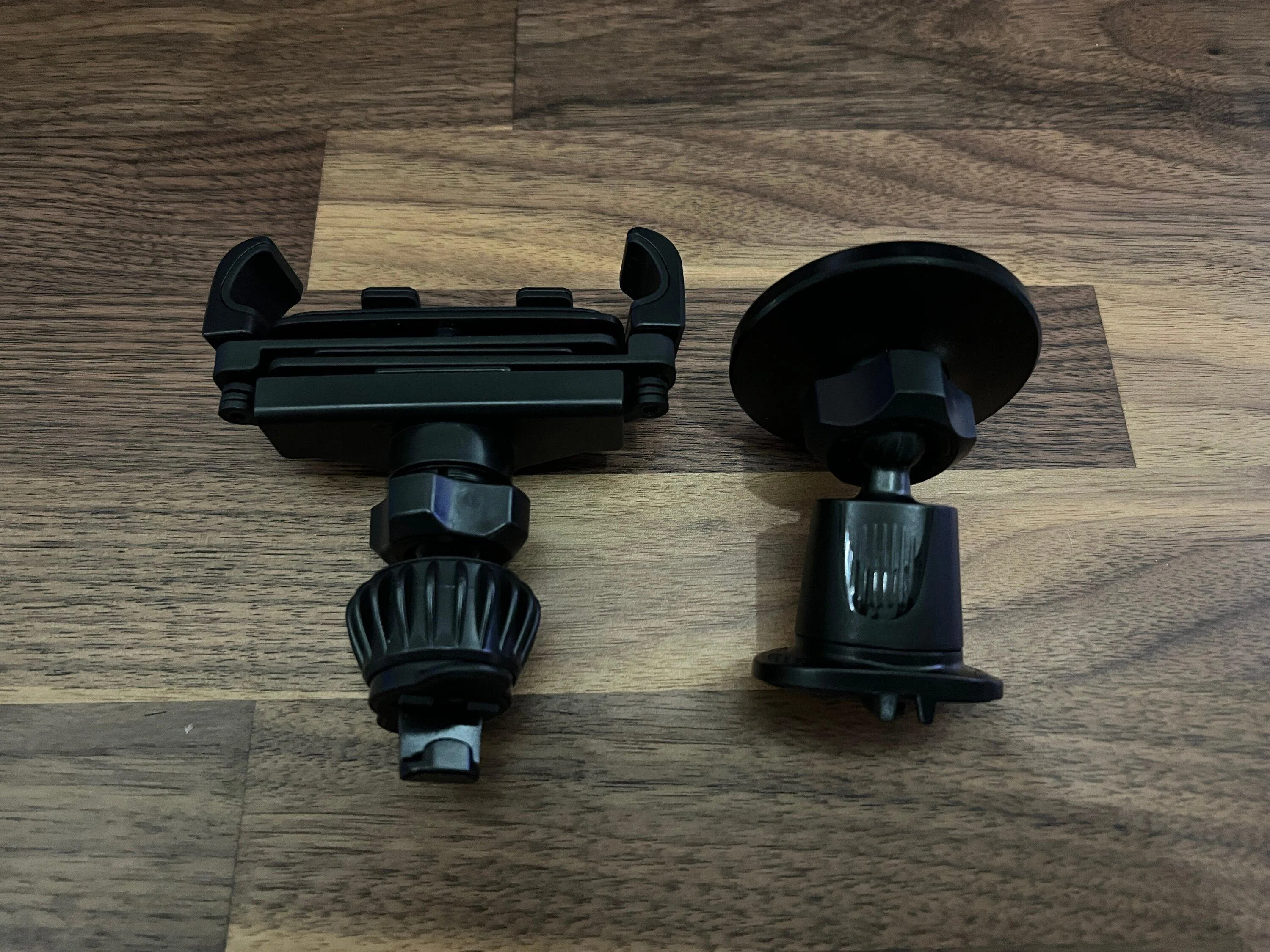

So, I ordered two different phone mounts and they both arrived today. Initially, I was planning on putting a hole in the mount that I made and using the included vent fin attachment on each to basically larch it together. Long story short - that ain't happening.
Upon disassembling both, it was evident that I didn't need to do that. BOTH use what looks like a standard 17mm ball mount. The ball mount connects to the vent fin and the mount connects to the ball. It's even like they planned it that way. ?
Rivian R1T R1S Mounting a cell phone.  Has anyone done it? IMG_0513
So, I am going to stand on the shoulders of phone mount giants by making a 17mm ball mount. Here is what it looks like:
Rivian R1T R1S Mounting a cell phone.  Has anyone done it? Screenshot 2022-07-08 005726
Not sure if it will work or whatnot, but it's on the printer now. Not sure if this is going to work, and if so how well, but I should find out shortly.

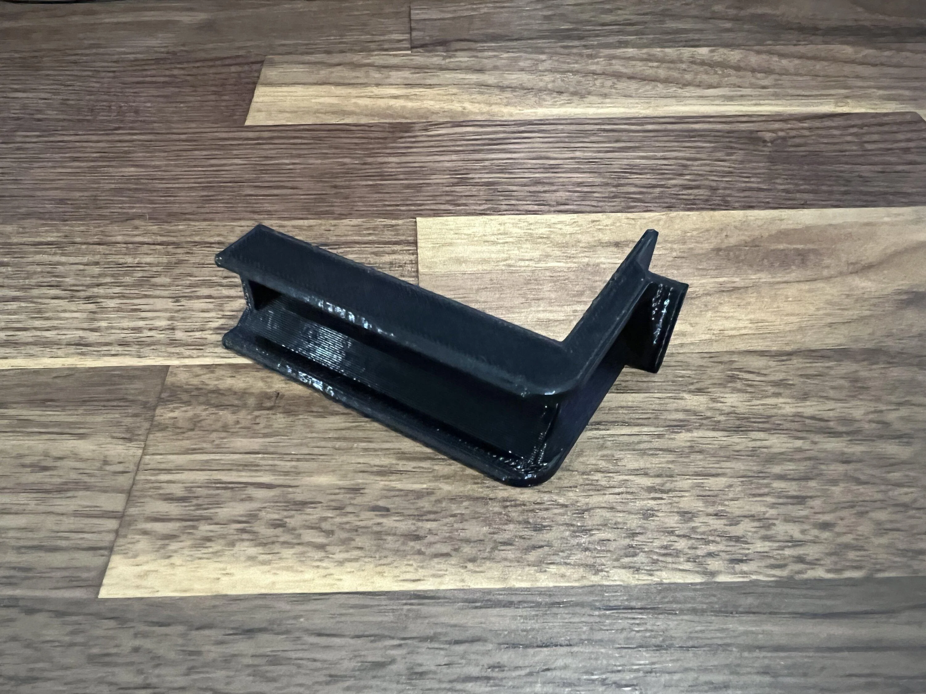

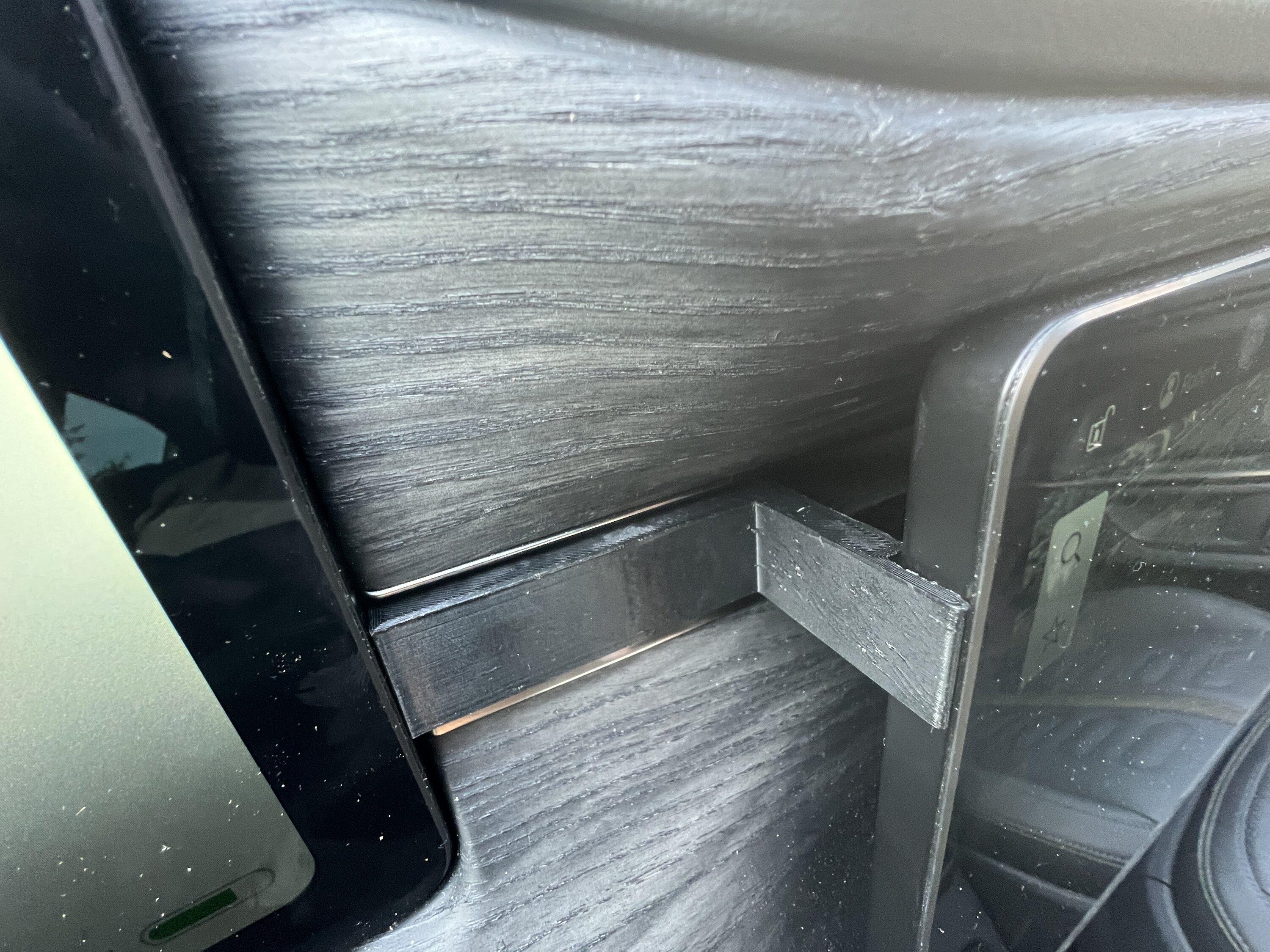

Update:
It works and it's clean.
I'm a fucking wizard, Harry. ?
Rivian R1T R1S Mounting a cell phone.  Has anyone done it? IMG_0517
Rivian R1T R1S Mounting a cell phone.  Has anyone done it? IMG_0518
Rivian R1T R1S Mounting a cell phone.  Has anyone done it? IMG_0519
The print itself was pretty crap as I had the printer speed turn up to 11 to get it done tonight. I need to tweak the ball just a bit (maybe 1.5mm) to bring it back a little further toward the dash. Both mounts clear the screens, wood, AND the stalk. Both are seemingly as secure as I hoped.
The phone is somewhat obscured by the wheel though - not sure how much that will bother people.
