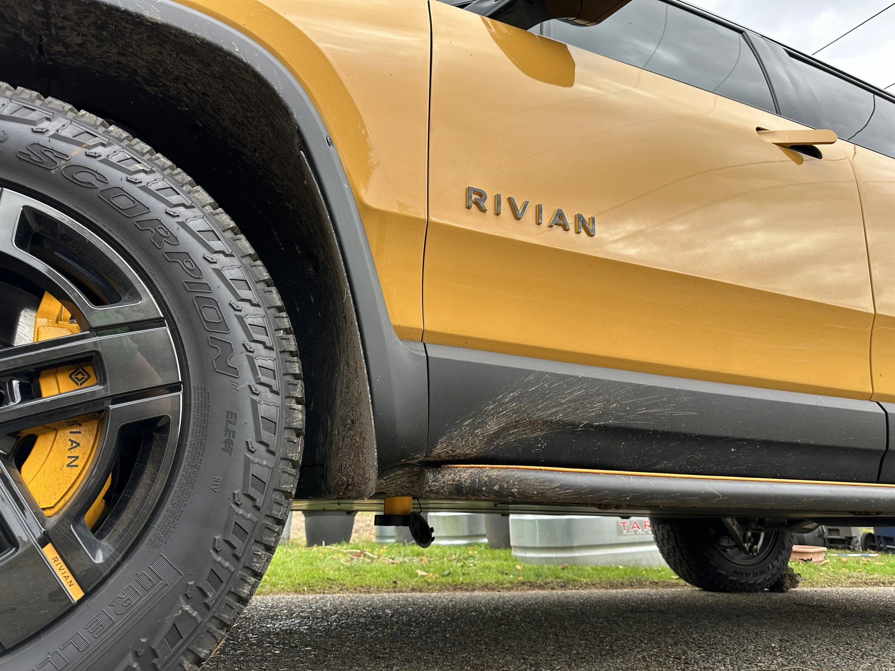

@pangpang77 here is what they look like and @madgrey the ABS when new as below had a bit more of a sheen than OEM plastic, a couple months in though they have lost some of that and match better.
Rivian R1T R1S Mud Guards options? IMG_0050

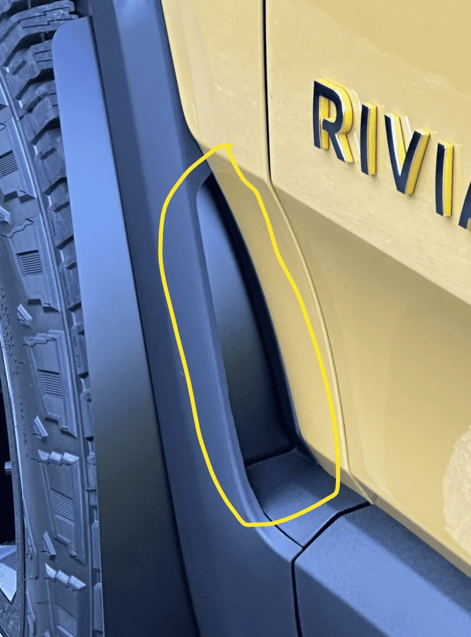

This image shows just how much protection they provide from the “aero gap” (also shown my yellow jack puck)
Rivian R1T R1S Mud Guards options? IMG_0907
Looks much improved. Thanks for the pics!

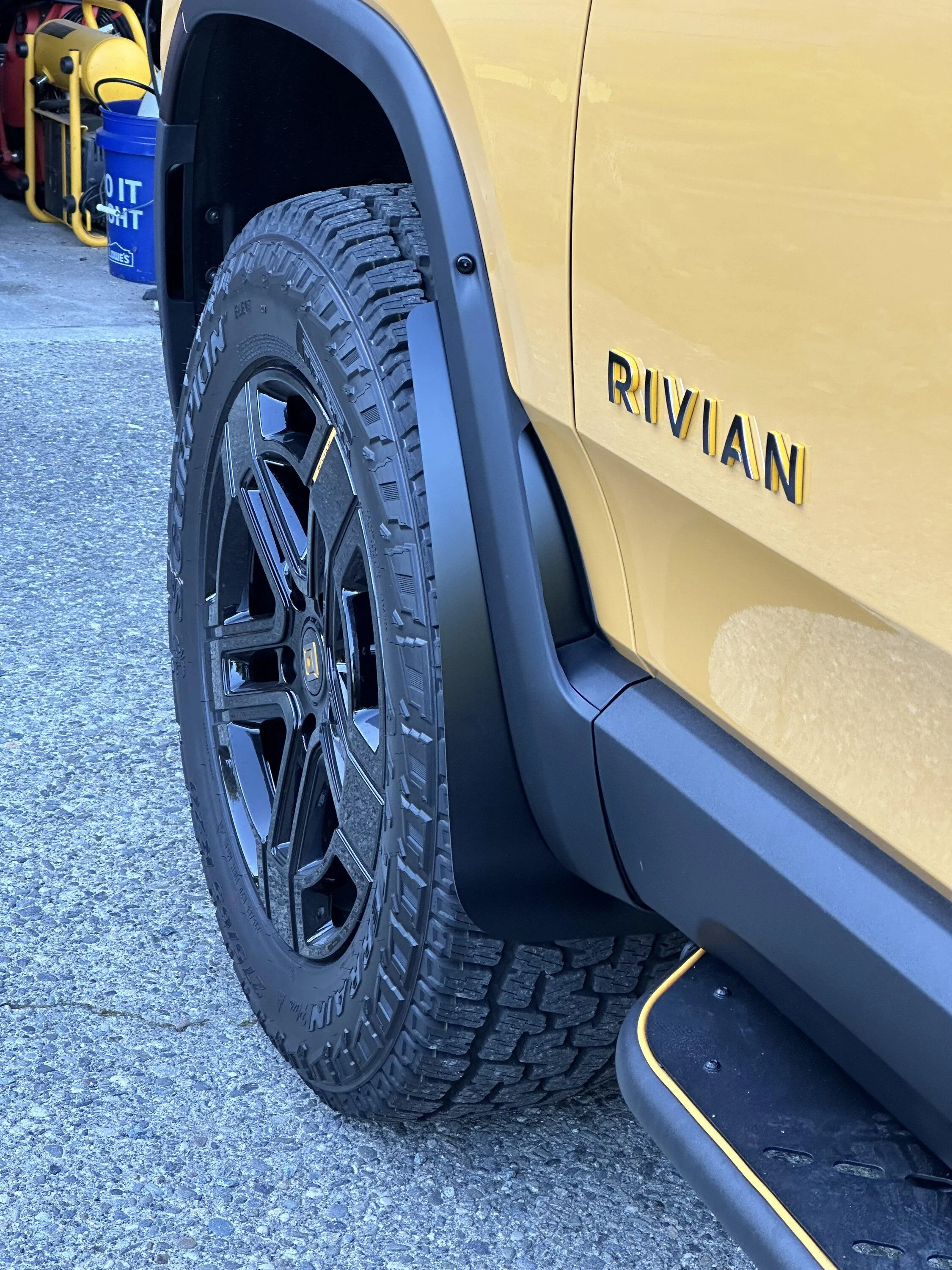

Do the new ones have the aero hole?
Rivian R1T R1S Mud Guards options? 1701892259007
Nope not yet...I will make a variation with the aero hole as soon as I have time... I have a lot of products on my todo and hope to soon ramp up to be able to list them, this being one of them.
