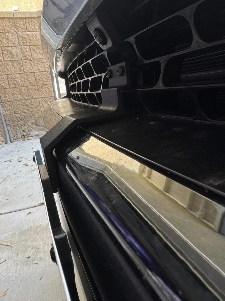

For anyone having trouble with bracket positioning using the BuiltRight tow hook mount to not interfere with the proximity sensors, here's what I found works. I was lucky enough to nail it on the first try, so I haven't actually seen what a bad result looks like. But there are no prox alarms as I start the car and creep forward/backwards, and as I approach a wall, all of the orange/red alerts corresponding to the sensor positions light up correctly, they're not seeing the plate at all (the pictures are with the actual plate removed, so you can see how I lined up the mount and bracket, but I tested with the plate fully installed of course).
One thing I did - since I saw people were having problems, I started with the unintuitive thing and mounted ti high rather than low. I suspect the sensors are pointed down a bit, so maybe this helps.
As a quick update, this wasn't quite right. Everything was OK on a test drive around my block. But tonight, Every time I came to a stop, I would get a beep and the front-right sensor (closest to the middle) registered a proximity alert (it goes away above 10mph).
So I had to move the plate about 1cm closer to the corner (this required flipping the mount upside down and moving the bolts up by one slot). I'll grab another picture when I can, but I took a longer drive with it mounted this way, it seems to be perfect.

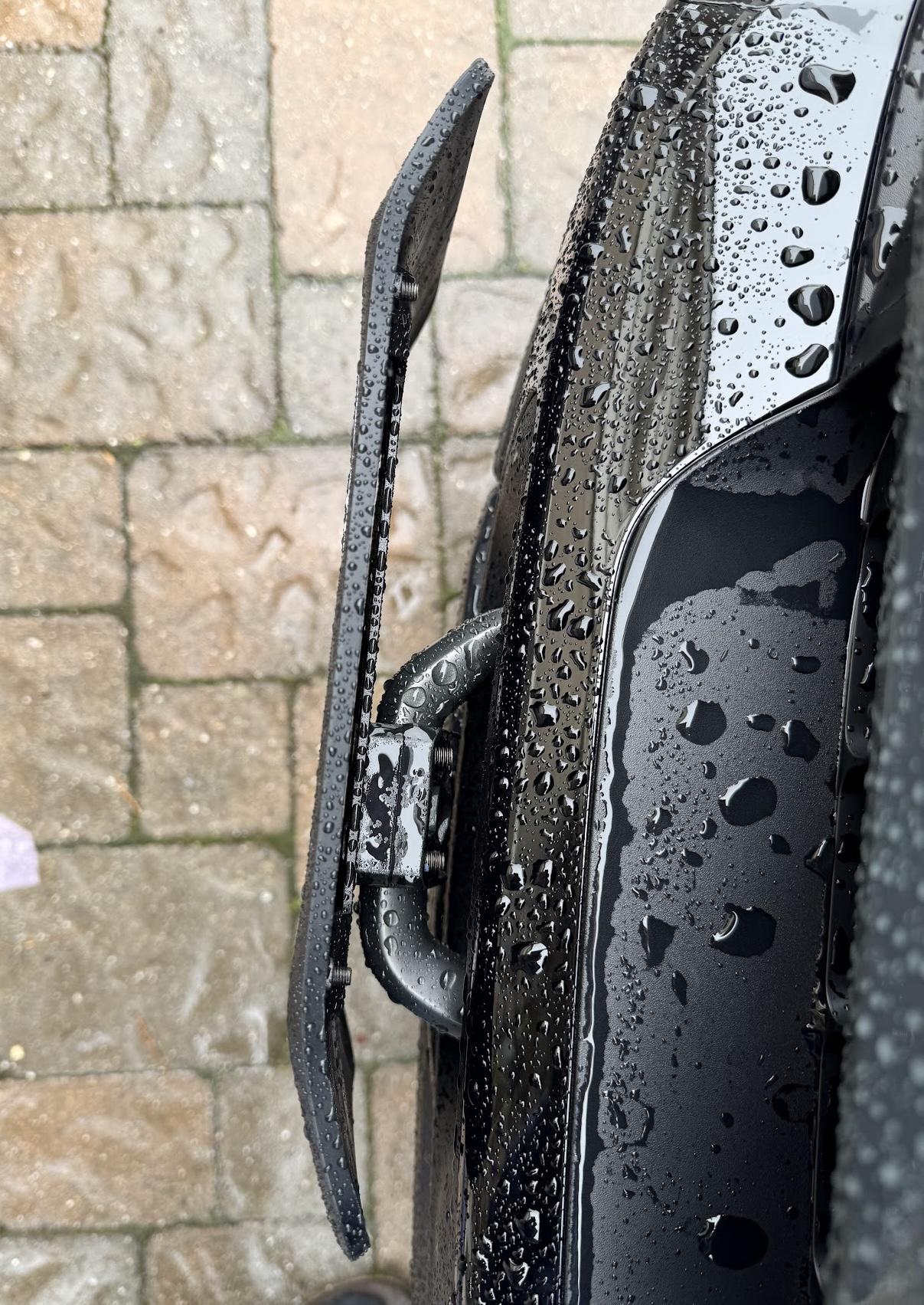

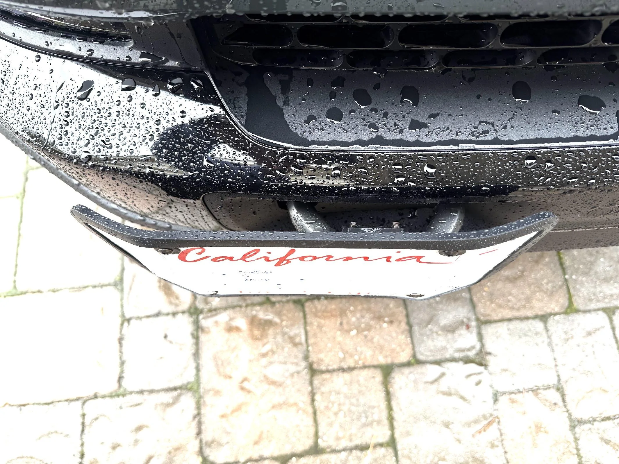

So plainly put, this was more complicated than I first thought.
After a day of driving, I started getting a prox alarm again. Turns out you really have to crank down the mount, if you don't, you might leave enough play for the plate frame to torque/rotate against the mount. Really cranking down into the nylocks helps that.
But then, after I thought I had it down, it rained, and I started getting prox alarms again. I think the rain on the sensors OR on the back of the rubber plate frame was causing reflections that were being picked up.
Rather than continue to spend time with it, I just decided to bend the plate. It was super easy, you don't need any tools or strength. I just put it against the edge of the table and applied light pressure. So far, seems ok. Will keep testing to see if any other edge cases present themselves.

So, how is it working out for you?
100% satisfied. Without any hint of copium, I actually like the "bent plate" look much better, and it doesn't stand out or look modified or sketchy at all. Over the last 2 weeks, the only false prox sensor I got was a single blip while slowing down for a stop light in heavy rain. I suspect the wet surface of the license plate frame caused a reflection to hit the sensor. I'm sure bending the plate a bit more would fix that, but I'm not even gonna bother.
