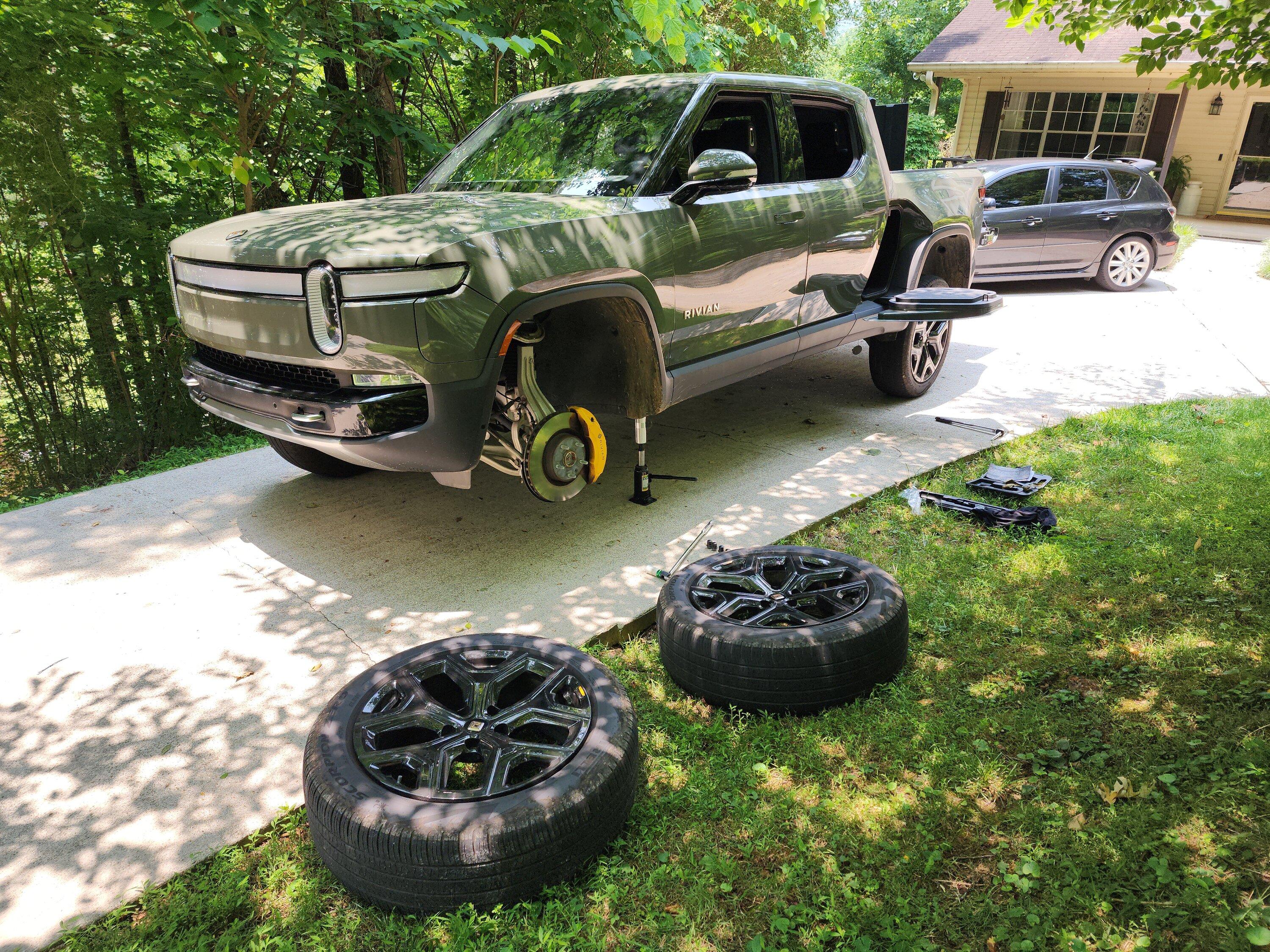

I originally bought a jack kit from EV Sportline, only to find out it can’t actually lift the rear of the truck off the ground when following Rivian’s guidance to use the highest suspension setting for jacking.
I have the EV Sportline jack and have used it for two DIY tire rotations so far on my R1T, no issue. I'm curious why your experience was different. I was in highest suspension setting.

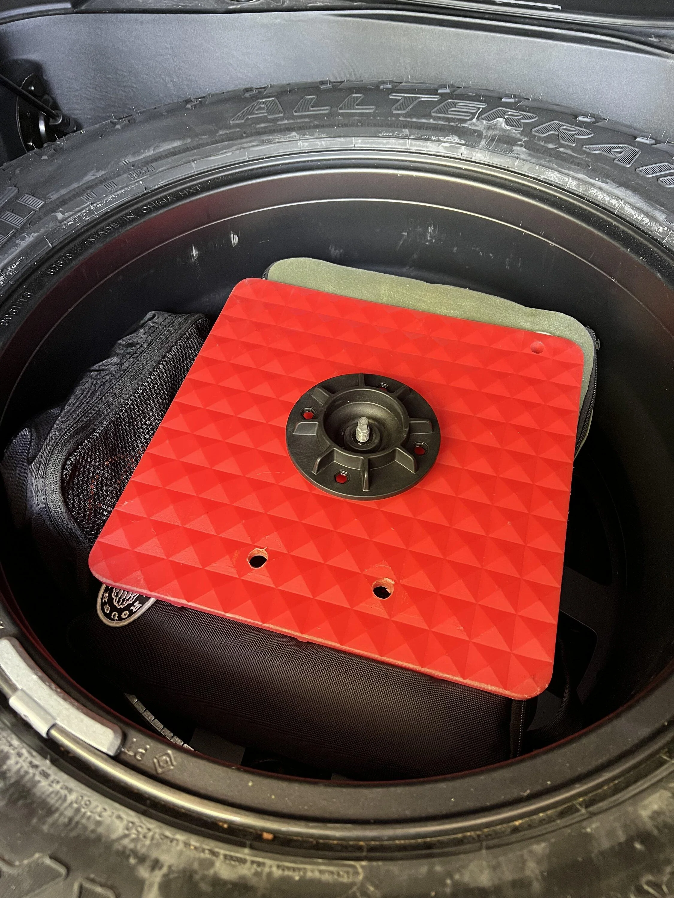

I did something "similar" but not nearly as cool looking. Found some canvas bags that hold some recovery equipment (soft shackles, etc.), the 1EV tall puck and jack, and straps. Used an old Hilift base with a bigger hole drilled in the center. Works great and nothing moves around. I also keep my large bungee recovery rope on top.

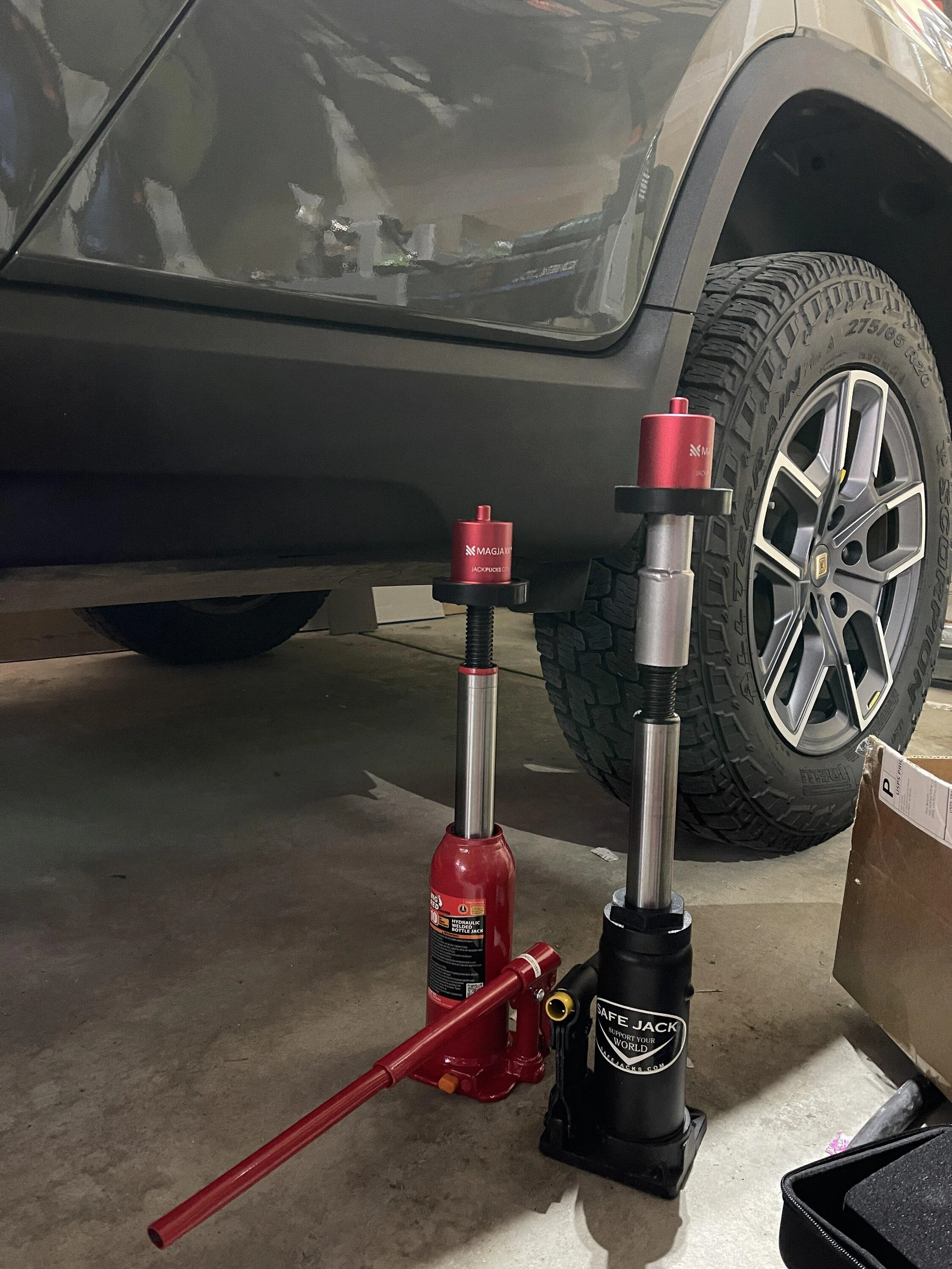

Also, another recommendation for a bottle jack is the one from SafeJack. Their 6ton starter kit is plenty tall. You can also buy a steel base plate as well. I've got one for my lifted Jeep and it's plenty tall for the job.
https://safejacks.com/products/basic-bottle-jack-kit
Here it is compared to the big red 10 ton bottle jack.

I got my foam from Rockler. It's 2.25" thick, comes in 2x4ft sheets.
https://www.rockler.com/rockler-foa...5HC6ze3_C8HUKAXQeJw_8YG8jFxUYSU4aAkVeEALw_wcB
My "plug" has two pieces glued together with contact cement (so it is 4.5" thick total). The top layer has all of the cutouts (jack handle sections, lug nut wrench, jack, and center cap), the bottom layer only has a cutout for the jack.
The diameter of the foam is 19.75". This is just slightly wider than the ID of the wheel, so it squeezes in tight (but easy).
I wish I had a better way to cut the foam. I have a 7w diode laser on my CNC router, but even at a slow feed rate it would only cut about 0.75" deep on each pass. Also with such a deep cut, the laser beam gets a bit diffused so the cut isn't as clean. It would be much faster to just cut the foam by hand with a long sharp blade, just harder to get the odd shapes just right.
TBH changing a tire in an emergency set up where the vehicle is on a slight side, or front to back slope, never mind off-road, looks like it would be very sketchy with any of those three set-ups. They look like Jenga blocks
I like the @twizzstyle option much better, especially the bottle jack base. Although if I were contemplating a tire change off-road, I might add a couple of wheel chocks and embed them into the foam cutouts.

I've done a lot of off roading and that bottle jack is rock solid.
But you're right about using a base. I have one myself.

@twizzstyle can you tell me what foam sheets you used and how many layers you needed?
Does the safe jack adaptor fit the big red? Does the adaptor fit firmly in the jack puck (I have the same puck)?
yup
