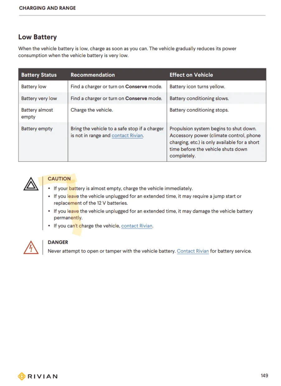

it doesn't imply anywhere, including the owners manual that leaving it over night will brick the truck.
Ummm, yes it does...
Rivian R1T R1S my R1S charging nightmare Screenshot_20240104-090927
For the record, I agree this SHOULDN'T be something owners have to do, and that a 12V jump and/or L2 charge should remedy easily without Rivian involvement.
