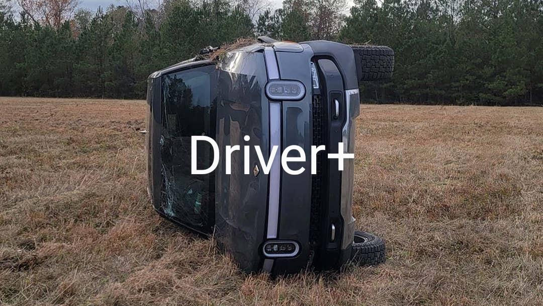

Several months ago I had an incident with Driver's Plus that came very close to taking my life. I have been working with Rivian since that time to try to get to the bottom of the issue and figure out why it happened. I would have posted about this earlier but I wanted to some answers before sharing my experience with the community. I have been a staunch advocate of the Rivian brand so this isn't a 'hate on Rivian' post but rather a fact based (at least as I recall the events) warning to those who own Rivian's and use the Drivers+ feature.
Here's the facts...
  • Driving at highway speeds in southern Wyoming
  • Road was straight as an arrow (no obstructions etc.) and dry pavement (not slippery etc.), weather conditions fair (no rain etc.)
  • Using Drivers+
  • Occasionally would take both hands off the wheel (will never do this again) until the car 'chirped' and then would put hands on wheel again
On one of these occasions Drivers+ lurched the steering wheel to the left violently (at highway speed) as if it had detected some sort of obstruction on the road (there was none, bare flat as far as the eye could see). I grabbed the steering wheel with both hands and fought as hard as I could against Driver's+ to prevent it taking me off the road at highway speed (it was trying to take me off the left side of the highway). This was not a 'passive hands off loss of control' type incident, this was absolutely fighting the fully engaged automatic steering for control. I managed through brute force to overcome Drivers+ and proceed to fishtail on dry pavement for quite some time as I fought to correct the initial engagement (which was now disengaged after I overpowered it). I can honestly say this is the closest I have ever come to dying in a vehicle.
I reported the incident to Rivian immediately and asked them to pull the telemetry on the vehicle to try to figure out what happened. I won't go into the 10 hours of calls, failed follow ups, outright lies etc. with the call center as that in itself is another sad (and quite frankly surprising) story. I will tell you however that the determination of the engineering team (after 4 months) was that it was caused by the driver (apparently according to them I initiated a sharp left turn at highway speed into the ditch as I had a death wish) All I can tell you is that factually that isn't what happened and while I understand their desire to absolve themselves of liability due to the seriousness of the incident that doesn't protect other drivers who may face the same issue. Though I remain a Rivian fan I can't in good conscience not share this experience with the community knowing what happened and that it could happen to someone else, I certainly hope it doesn't.
Should I have taken both hands off the steering wheel at any point? Absolutely not, stupid, risky and will never do so again. Does that in itself change that this system catastrophically failed and almost killed me and may kill others? Nope, not a bit.
