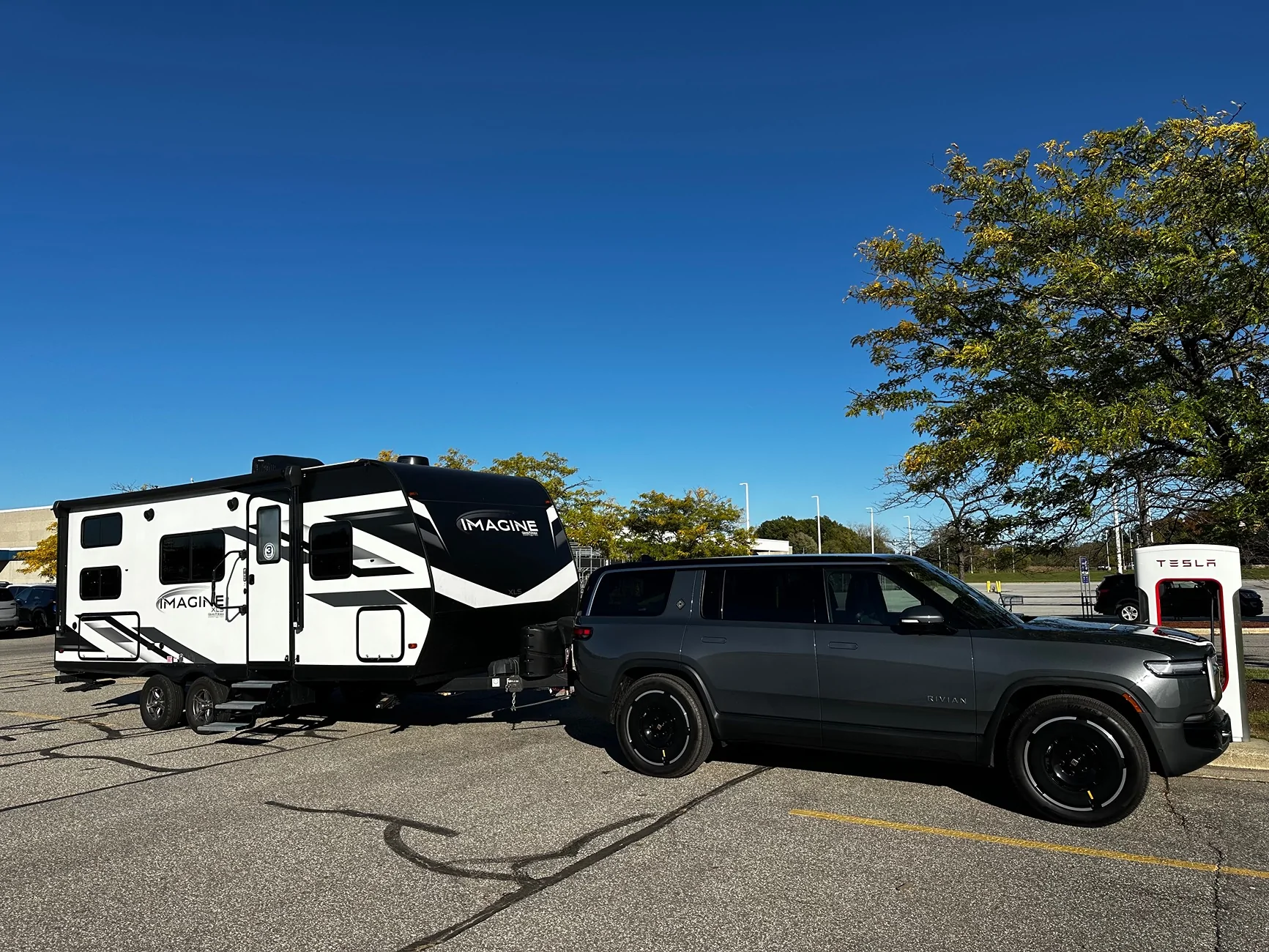

For #1, this is a limitation of how Rivian currently calculates 100% range on that screen. Rather than using the data it accumulates on each trailer, it largely generates this range value based on the estimated weight of the trailer. I've towed 10,000km with my Airstream 20FB and it displays an average efficiency of 2.0 km/kWh (about 1.25 m/kWh); this is accumulated data from towing anywhere from 90 km/h on secondary highways up to 120 km/h on Interstates and over huge mountain passes.
However, the 100% range is ALWAYS higher than what I can actually achieve, and I can watch it vary directly depending on what it estimates my trailer to be for weight! I've seen it range from about 300km up to 350km, when the actual, based on displayed efficiency, should be about 260km. The weight estimate varies between 4000 lbs to 5500 lbs (depending on how much load is actually in the trailer plus the types of roads I've been driving). The 100% range varies the most with changes in estimated weight. It does change a small amount based on the average efficiency. I'm not sure the internal algorithm they are using to show the 100% range value, but my guess is that for most people it is inaccurate.
But, as you've found out, the navigation system itself is quite accurate, so just ignore the 100% value and use the navigation system.
For #2, there are no settings on the vehicle you could tweak that would make a substantial difference to your range. Your best bet would be to lower your speed, or tow a more aerodynamic trailer.
For the conditions you mentioned and the trailer you showed in the photo, I'm not surprised at your achieved efficiency (cross-winds add drag too, not just headwinds).

Good morning all! I’ve been in the market for a travel trailer for awhile now. I wanted to experience towing with my R1S and get some idea on the actual towing range I should expect so I rented the exact model I’ve been looking into and towed it to a campsite 180 miles away for a few days. While the truck did a great job towing my range was much less than expected (I’ve been reading up on Rivian towing for months). I’d love to have any thoughts/ideas on things I should consider checking or changing for the trip back to try to increase my range any. I’ll list some details below about the trailer and how I towed it…
Gen 2 R1S Dual Motor Max Pack
-Set to FIRM with Regen HIGH
-Max speed on highway 65mph (used cruise control most of the trip)
-Very gentle with acceleration and tried to utilize regen braking over manual braking as much as possible.
-Trailer brake gain set to 5
Trailer:
-Loaded weight approx 5,200-5,500 lbs
-Tongue weight approx 460 lbs
-Dimensions 25L/8W/11H
-Weight distribution hitch
Initially when I hooked up and started driving the Rivian estimated the trailer weight at 4,500 lbs. but after awhile I checked it again and it updated to 5,500 lbs.
The outside air temp was in the low 60’s. Winds were fairly gusty a good portion of the trip approximately 15-20mph. There was a bit of stop and go traffic and a few back roads but the high majority of the trip was flat highway, averaging around 60mph (no faster than 65mph) with cruise control on.
My normal range charged to 100% is 410. With the trailer plugged in and driving for a bit both the energy screen and my driver’s side display estimated the full charge range at 225 miles. However the nav display was calculating my charge/mileage at arrival much lower (initially 50 miles less, with the delta slowly growing as the drive continued). As it turns out the nav display was much more accurate.
Then end result was an average of 0.93kwh/mi or approximately 125 miles for a 100% charge.
So first of all can anyone tell me why the energy and driver’s display range estimates would differ from the nav estimates?
Second of all does anyone have any ideas on what I can check/change to possibly increase my range? My only idea so far… while stopped at a charging session I noticed that the trailer was not longitudinally level. The front was sitting higher than the back. Could that be affecting my range that much? I plan to adjust the WDH to have it sit closer to level for the drive back. I’ve attached a photo where you can see how far off it is from level.
Sorry for the dissertation but any help would be sincerely appreciated.
There is really nothing within your control (given your trailer)
except speed and acceleration.. Wind, elevation changes, temperature, traffic all affect efficiency. I’ve averaged 1.1 kWh/mi for over 14K miles towing a 7500 lb 28’ Airstream with my Perf, Dual, Max R1T. My 21” road tires are the most efficient, I’m now running Michelin LTX2 M&S at 48 psi. Increased psi might help, but I like the ride at 48. Speed really matters, and like you, I generally keep it at 60 mph. On the ‘Blue Highways’ which we prefer, I do 55 and see a marked increase in efficiency.
Increase your tire pressure to 53 - 55 psi to reduce rolling resistance, of course verifying that you don't exceed maximum tire pressure for the tires on the vehicle. This will give a rougher ride and possibly increase wear on the center of the tires. But for short distances, meh....
