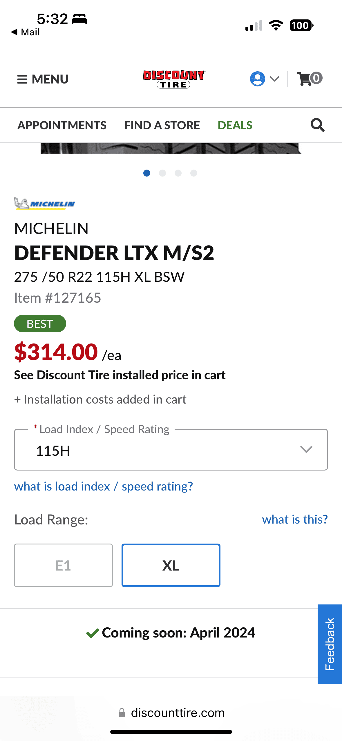

Discount tire now has listed for the 22”, that Michelin will have a 115 or XL rated 2nd Gen tire for $314/tire, 70k warranty @ 38 lbs.. Coming in April.
Rivian R1T R1S New Michelin Defender LTX M/S2 coming soon IMG_6287
Is the 115 load rating OK for the R1T/R1S?
I would LOVE to have a straight answer to this. Rivian used to ship R1S with 115 tires but now everything ships with 116.
Not marked on the door sticker like it should be.
So are some R1S vehicles ok with 115 but new vehicles no longer are?
In theory you could go as low as 113 for a rating. Looking at the door sticker the rear axle carries the most weight of the GVWR at 4960 for the R1S and 113 is 2535 which covers the rear axle and still is over 10k for the vehicle with a GVWR of 8532
