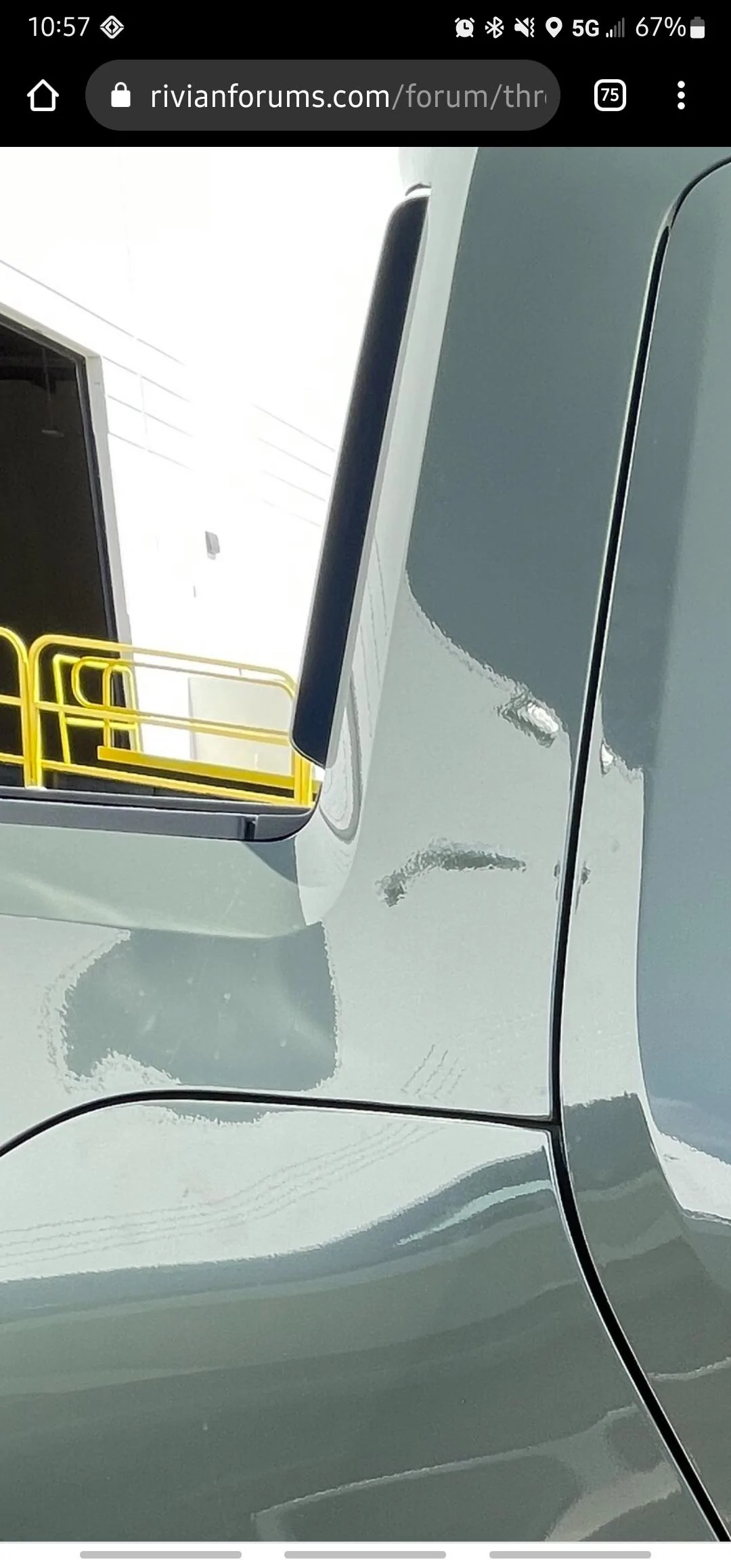

I guess it is acceptable from the factory. To me in this photo posted shows the same thing I see on my truck when reflections hit the surface.

I have had my truck 3 days now (which i love), and it's becoming clearer and clearer that my Limestone truck is covered in orange peel texture in the paint work. It is extremely difficult to picture with my phone and I can see it everywhere on the truck in the right lighting conditions amd angles in my garage and bright light. I was wondering if anyone else has had this issue and what the outcome was. I submitted a service request last night and will call my guide today to escalate as it's approaching he my 7 day window. I added my screen shot of the service request...look at the texture around the reflection of the light. It was the best I could do.
Normal, unless McLaren's and G Wagons and S classes are not an exception because I've seen literally every car have orange peel. The only caviat is if there is enough clear coat people can pay to have it smoothed out and still have plenty of clear coat leftover.
