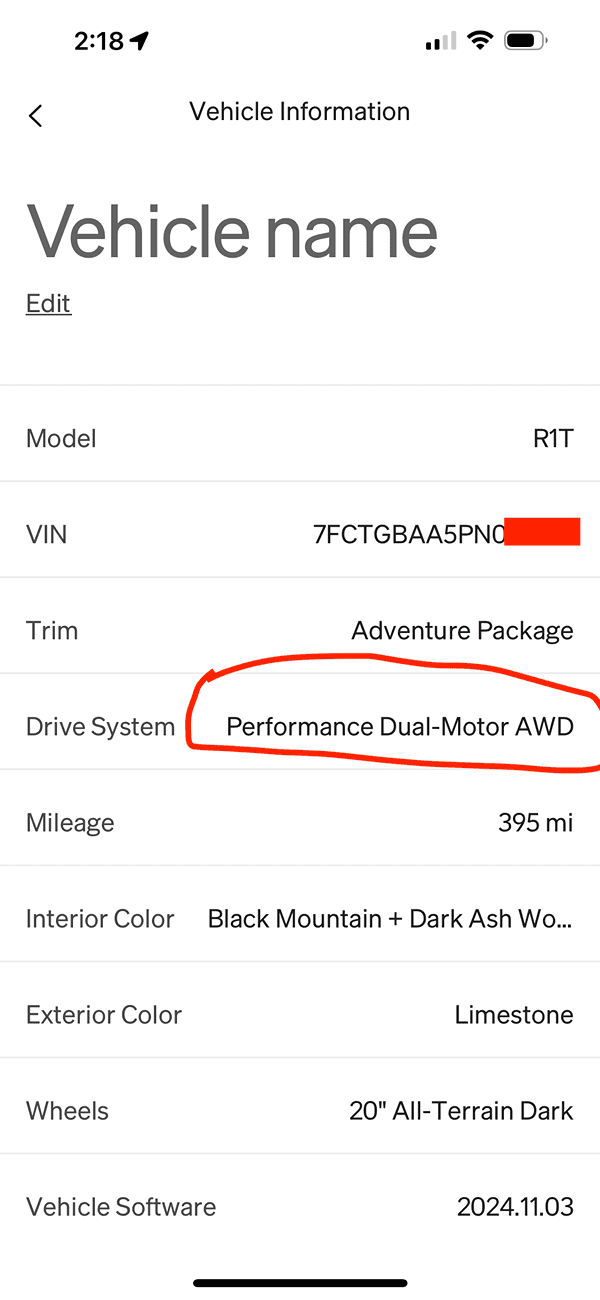

Something got mixed up. This should just be a software fix??
So it looks like your vehicle doesn’t think it has the Performance option but your app does. Really interesting but agreed it should be a software fix.

Did you try a reset?
No, I don’t know how that works. I called Rivian Service and they see that it was a mistake and are supposed to be setting up a mobile service appointment.

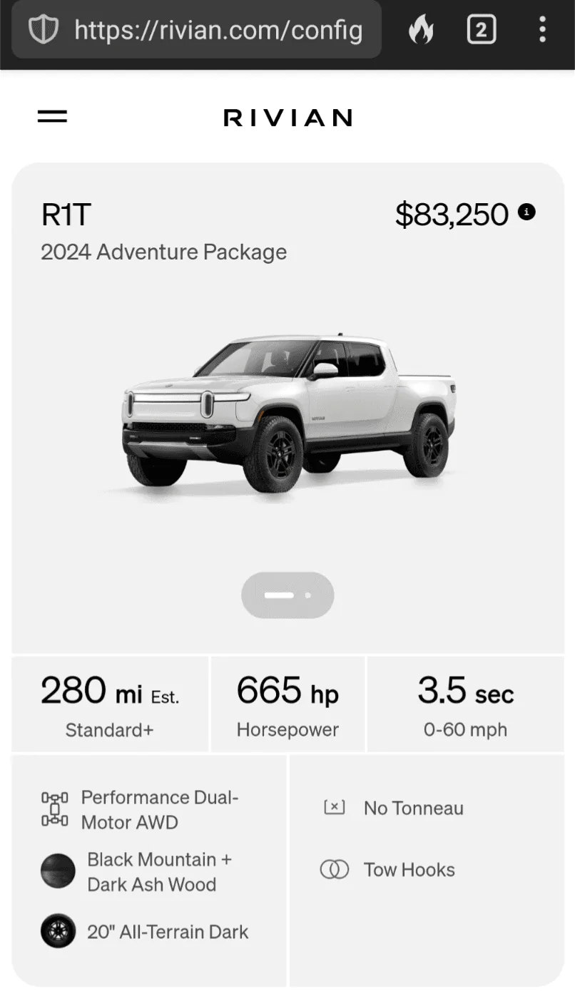

There might be some misunderstanding then. You can only option a Performance Dual Motor with the large pack. I wasn't aware that PDM was gated behind anything smaller than a large battery.
I found a standard+ with Performance DM in the shop.

You can definitely get the Performance with Standard+ now. Only the Quad requires large.
OP that’s wild. I would have anxiety through the roof upon discovering that. There’s no hardware difference between the dual and performance dual luckily so def should be fixable as others have said.

They set me up with a service appointment next week to get this fixed.

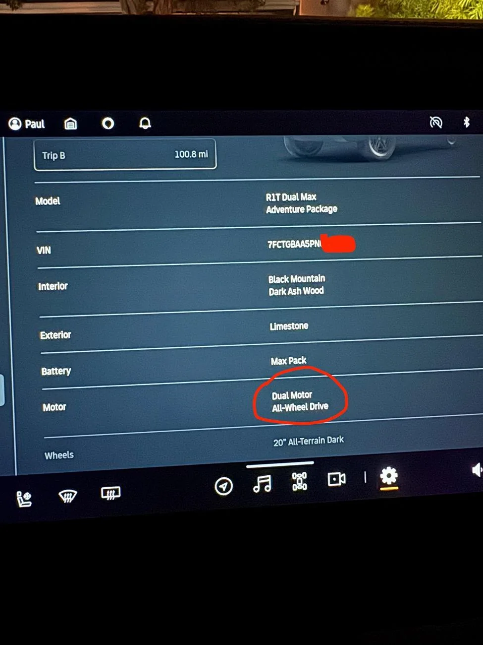

I have same problem. It's been a month since delivery and dont have a resolution. Bought PDM and have no sports mode and inside vehicle setting shows DM. Aside from a bunch of other issues... Mine sounds like a shopping cart with loose items and rattles all over the interior. Rivian service dats set for September 23, 2024, delivery was June 4th. Thats a 3 1/2 month wait... and powered Tonneau cover was not delivered with vehicle either.

Delivered on June 14, 2024, my R1T was supposed to include Performance, did not, and in less than a week after taking delivery, the Denver Service Center truck came to my location in Boulder and updated the firmware, fixing the issue. They also took the time to answer some other questions. Kudos to the Denver Service Center.

Interesting. I am in Los Angeles... not a peep from anyone other than from the robotic sounding customer service department
