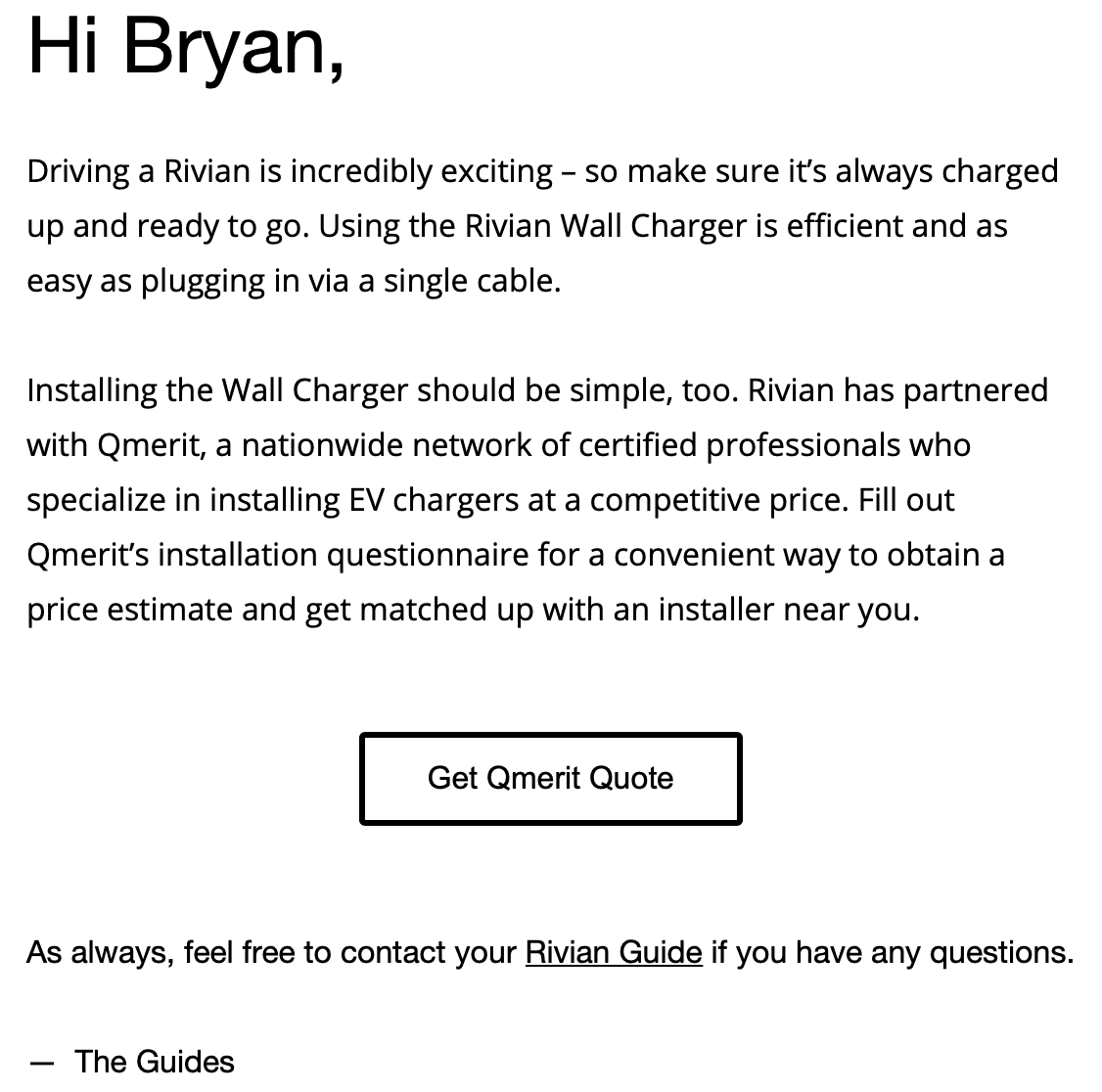

Update...
Within a day of paying the $149 deposit, I was contacted by a local company that looked at the photos I took and updated the quote... including a $250 permit cost (ouch... but not their fault). We'll see, but it looks like this company has good reviews...
In parallel, inquiring with the Guides about when I might actually be able to get a hold of the Rivian wall charger for the electrician to install. Seems like I should have it in hand prior to bringing out an electrician?

I received an email from Rivian today with a link to get a quote from Qmerit for installation of the Rivian home charging station. The link took me through a multi-step survey and had me upload photos of my electrical panel, proposed charging station location, and other aspects about electrical load in our home. At the end of the survey, I received a quote for $699 with $149 due to initiate the next step. Given other recent experiences with electricians in our area, I thought the quote was reasonable. In reality, I think the bill will be much higher once the electrician carefully inspects my old loaded panel and all of the various loads potentially drawing power from it!!! ?⚡
I am prepping myself for... 'yeah, we're going to need to upgrade your service, install a new panel, and rewire your whole house'. Either way, feels like progress.

From the Guides... I am going to move forward and see how the back and forth between Qmerit and Rivian goes.
We do not have any updates related to the wall chargers shipping. Those chargers will need to be hardwired into the home. The Qmerit crew can begin the process, but will not be able to finish until the charger is delivered. Qmerit will work with Rivian to help schedule the process. I'll update you as soon as I get any additional shipping information.
