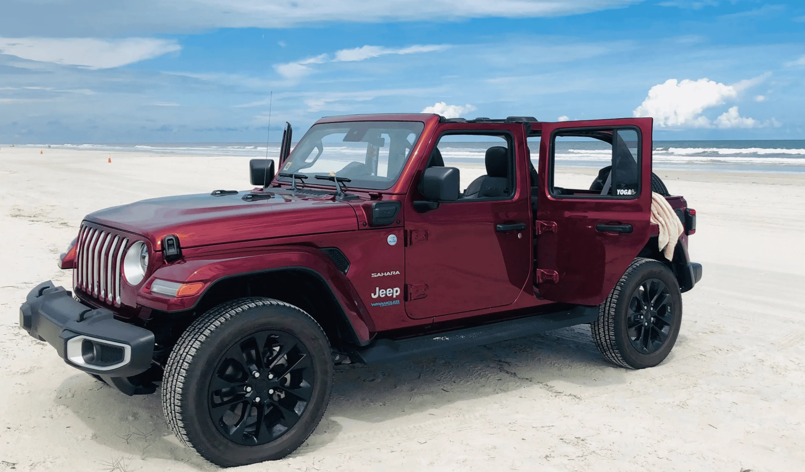

But on a different note, now do you like your 4xe?
It's solid. If I may derail the thread a bit ...
It was our first EV, after deciding we wanted to give EV tech a shot. Funny enough, my original motivation came from all the friends/associates I knew with EVs (mostly Tesla) but from a Dad's Day gift a cordless, electric blower (to replace a broken corded blower).
Got other Greenworks yard tools without the battery/charger, making them super inexpensive (and I figured with my light use, I could easily share), so I scored a string trimmer and a pole saw, eventually got a mower for, a killer deal came up on Woot (that included TWO batteries and charger). Then something clicked, batteries, no smell, no gas ... I could drive a vehicle like this! YES!
But we were a little apprehensive to go full on BEV. About this time, our previous 2nd car/family/wife's ride, a DD/RT was coming off lease, we decided we'd just try something without 3-rows, we both kind of wanted a Wrangler (around here, every 4th car is a Wrangler ...) We bought the DD/RT off lease, and turned around and sold it to Carvana for a $12K profit :D
So we got the 4xe, we were a pretty early adopter, got ours in April '21, got the $7500 tax credit immediately as a cap reduction, even a discount (this was pre-multiple-price-hikes).
Once I got the 50a circuit installed, and a 40a EVSE it was a total epiphany. So much so, that I sold my '19 GT convertible and picked up an M3P (they share the Grizzl-E EVSE, for the Tesla, I just pop on the adapter that was supplied with the car). I went with an outlet vs. hardwired, and got an N6-50 adapter for the Tesla mobile connector, so I have an L2 charging backup.
Anyway, back to the 4xe, we LOVE it, I installed an electric hoist in the garage, so removing the top is easy (and it stays up and out of the way), we use it for beach cruising, heading down to the point for a little SUP-ing, to lug shit around, and it's almost exclusively our around town car. It's extra great around here too, where there's constant flooding issues, it just chugs through water no problem. It's so nice quietly cruising around the beach areas, the only sound the ocean and the occasional tires squeaking in the sand.
It runs about 95% of the time on battery only, and yes, it doesn't have a ton of range, but we rarely use it beyond that range (we work from home, daughter's school is ~6 miles away).
So that means in the last 1200 miles or so, it's used less that 1/2 tank of gas. :)
I probably don't have to tell people on this board, how fun Wranglers can be, all the aftermarket, modular body parts, super durable interior, and heck, ours is a big sissy model with heated seats and a fancy stereo system :D But it's still very much a Wrangler, a real 4WD system, low range, and when the gas AND electric systems kick in, it's had a f*** ton of power (it's shockingly quick on the road too, for a big brick).
