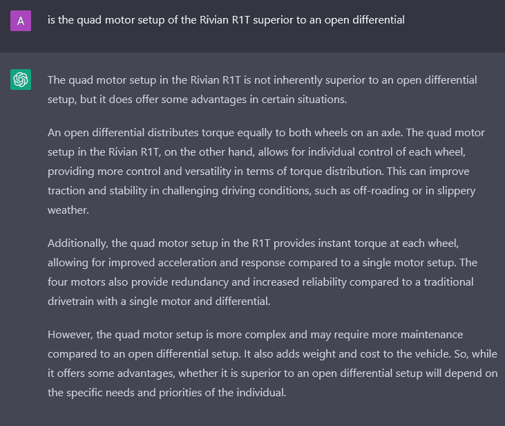

It's official... @R.I.P. is actually ChatGPT in disguise!
Rivian R1T R1S Quad motor vs locking diff Screenshot 2023-02-08 at 16-00-45 ChatGPT

Sorry, remember, I am an old Oregon Longhair... So not as up on this online stuff as most... What is "Chat GPT?"
No worries man, check out the link. Also this YouTube channel does great work

The chat GDP quote above does a decent job of summary. It is not as specific as the testing I did, but definitely gives you the idea.
