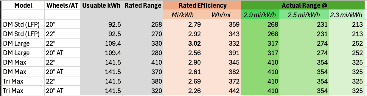

I'm getting about 2.3-2.4mi/kWh on my Gen 2 Max (22" range wheels) over 1,500 miles, mostly at 75+mph speeds.
On a max battery, you'd get a bit over the 200 miles of ranges that's been estimated if you use 65% of the battery (80%-15%):
141.5kwh * 2.3mi/kWh * 0.65 = 212mi
If you're willing to use 80%-10% = 228mi
More efficiency (drafting, slowing down, or putting the suspension in low) will obviously change that equation.
I, like you, am coming from a Tesla (2015 MS with poor charging speed and okay range) and made a quick reference when I was thinking about different builds and real world range:
Rivian R1T R1S R1S Charging speeds and range 1724347723950-n9
Those actual range numbers are obviously for 100%-0%, but just calculate whatever fraction of the battery you're willing to use. DM Large rated range seems quite dubious, btw. Std and max are optimistic but more attainable.
Charging speeds I'm less clear on at this point. The charge curve seems solid if you can get a DC charger that will provide good numbers. If most of your routes include v3 Tesla chargers open to Rivian, then you're in good shape (mine sadly do not).
Hope that helps your decision-making some.
