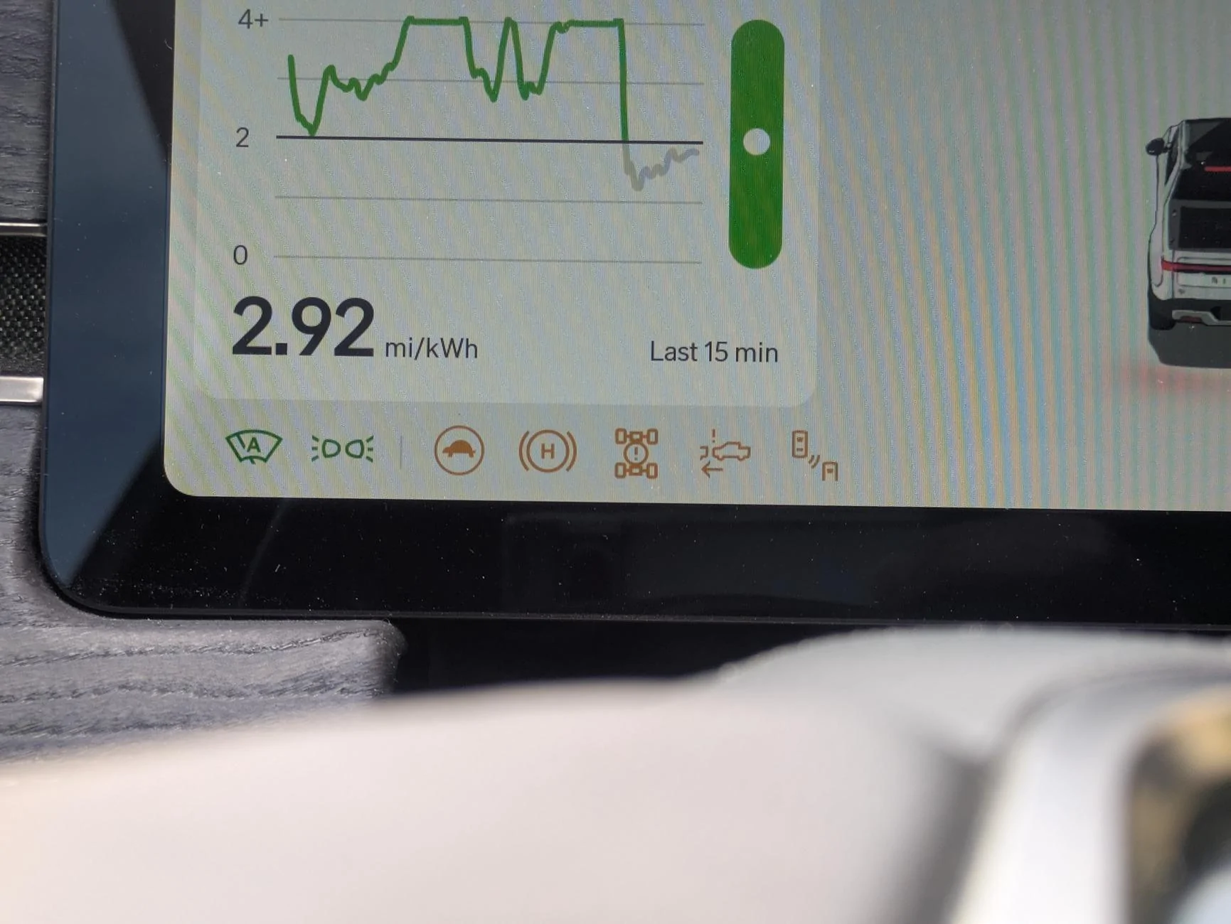

Fastest way to verify your fault / no fault will be with drive cam, and/or checking to see if you have ((H)) on the driver display which will indicate a Brake Hold failure.
Anything else at this stage is conjecture.
If the drive cam / gear guard shows you rolled backwards, you're guilty (regardless of truck tech fault). If it shows you were stationary and hit, then success - send to your insurance.
If ((H)) shows up then you're still technically at fault, but at least you know the truck's brake hold is borked and needs service.

I had a random set of errors for a drive home last weekend that could result in this. Cleared up for my next drive a bit later.
So it can also happen with a set of errors, but those would likely be noticed on the dash plus the pop up warning about driver assist issues (I think that was the gist of the pop-up).
Rivian R1T R1S R1S Roll Back on Steep Hill at Red Light?!? Please help 1000004010
Note the ((H)) listed, those were disabled functions for my short drive.
