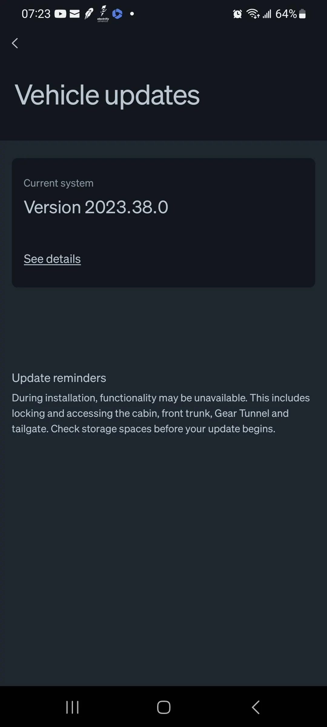

"Sounds to me an alignment problem. Mine just wandered all over the road at highway speed, sort of reminds me of the early American SUVs that never track straight and tends to require lots of steering correction on the freeway to keep it straight. When the Driver+ is activated, the problem goes away. It just gets tiresome driving long distances where Driver+ is not available. It is time like this that I truly missed my Tesla's Autopilot; with literally no restrictions on where I can use it. So I finally took it into the CS and all they did was an alignment and plus my air suspension recalibration,noh, plus they realigned my steering afterwards. I will be going on a 400 mile plus interstate drive later today. I'll report back then."
Update:
-since repair, and driven it over 500 miles, I can say that it tracks better and drift less on the freeways. On a different note, I also noticed the AC works much better after the latest software updates 2023.38.0 ?
On a down note, when it prepares rhe battery for fast charging, the noise level is noticeably louder now. Also notice the same noise now after fast charging. Sometimes last over a minute or so...
