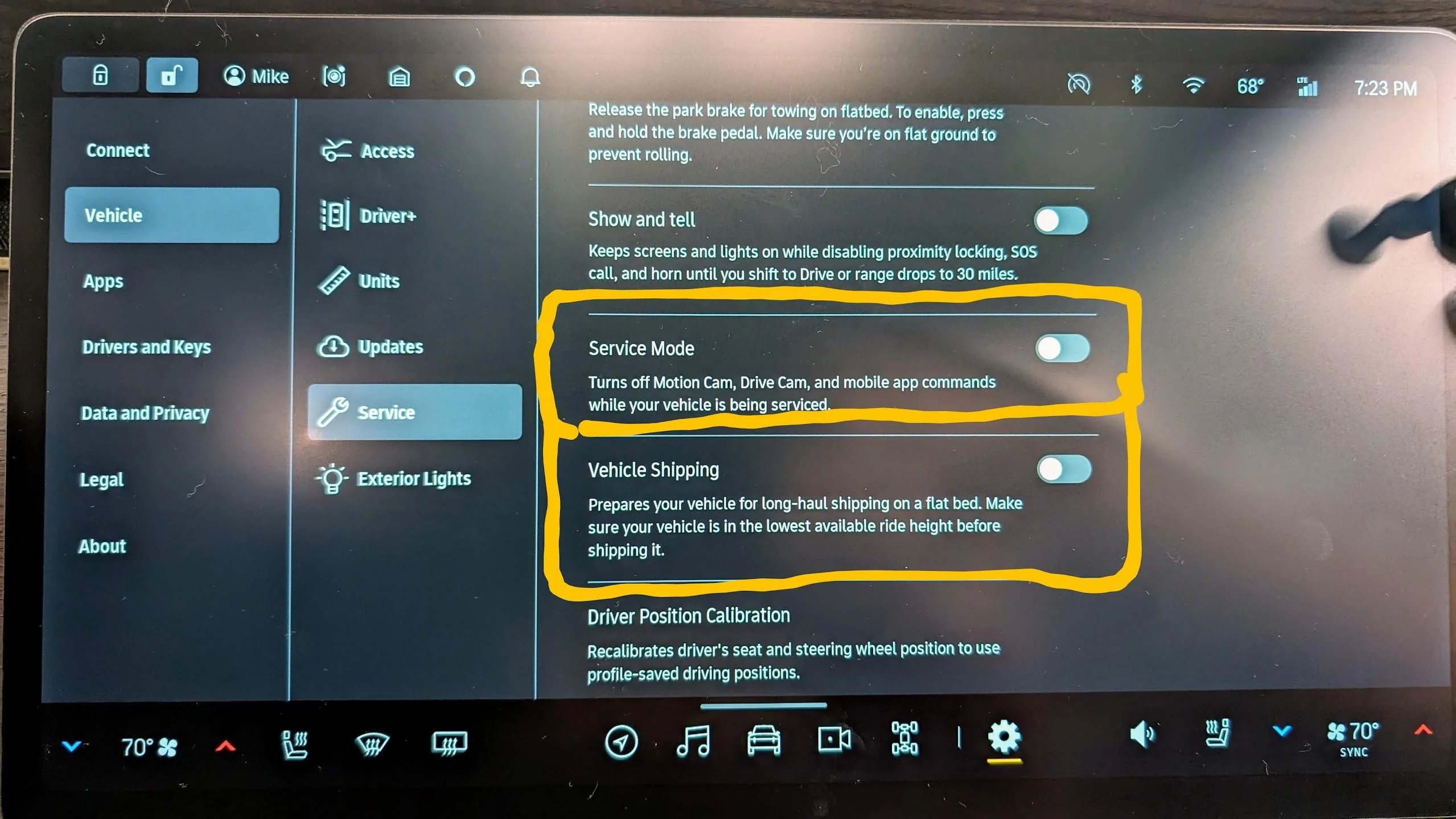

Do you mean Shipping Mode?
I think Service Mode was just referenced in the .46 release notes and is for service technicians. Some used to able to access it with the old RIDE code.
Under Vehicle --> Service. Try one. Or the other. Heck, try both. ?

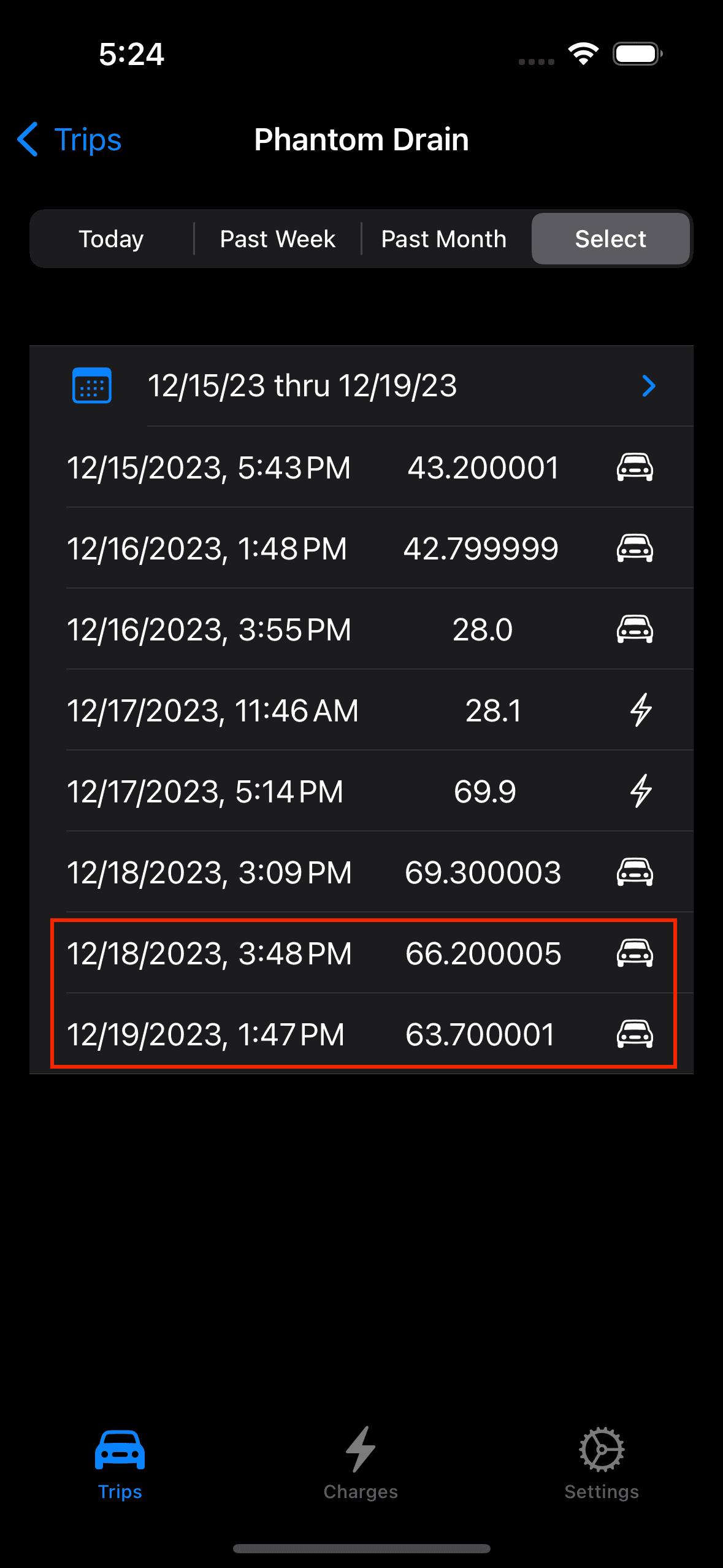

Here is what I am doing, there is no great solution since the precise data is not available so you compute some 'ballpark' estimates and live with them.
These results are taken from a personal iPhone app I use to log trips and charges and are records selected with there being a minimum of 6 hours idle time between events. As I am reworking the graphing I made a simple list, the first item in a pair is the end of an event and the second is the start of the next event.
Rivian R1T R1S R1T phantom drain and possible work around 1703025180858
Drilling down into the last pair of events, my Rivian sat from 3:48PM yesterday until 1:47PM today when I was ordered to replenish the Christmas cookie larder, let's call this 22 hours idle. The SoC declined from 66.2% to 63.7% for a loss of 2.5% SoC. I did turn on the climate and seat/steering wheel heaters since there were a couple inches of snow to clear off so not all the loss is solely due to phantom drain. On my Large pack battery use `1.3kWh/degree of SoC so this represents about 3.25 kWh of consumption.
This data does clearly demonstrate the limits of using the SoC as a proxy for energy as overnight on Sunday the reported SoC had increased when I plugged in Sunday AM to charge. While the vast majority of idle periods record a loss of SoC this is not uncommon and is probably because the battery management software did some cell balancing or other work and the SoC was recalculated.

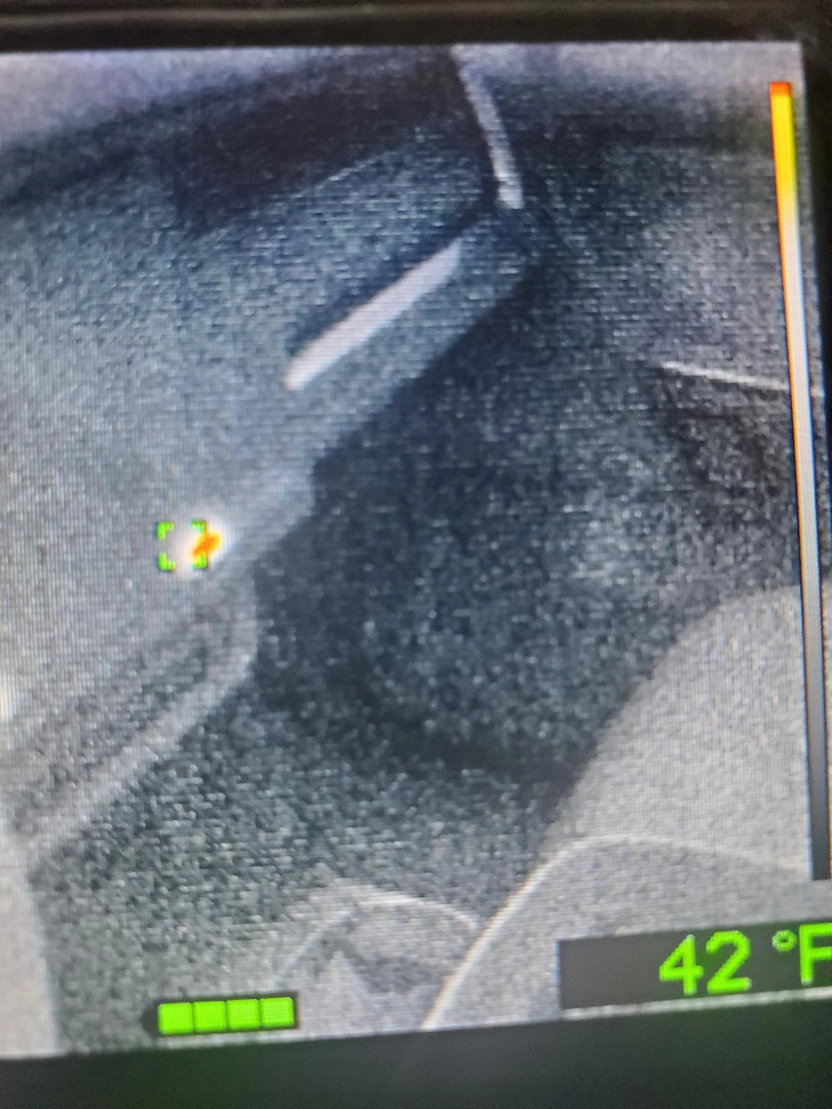

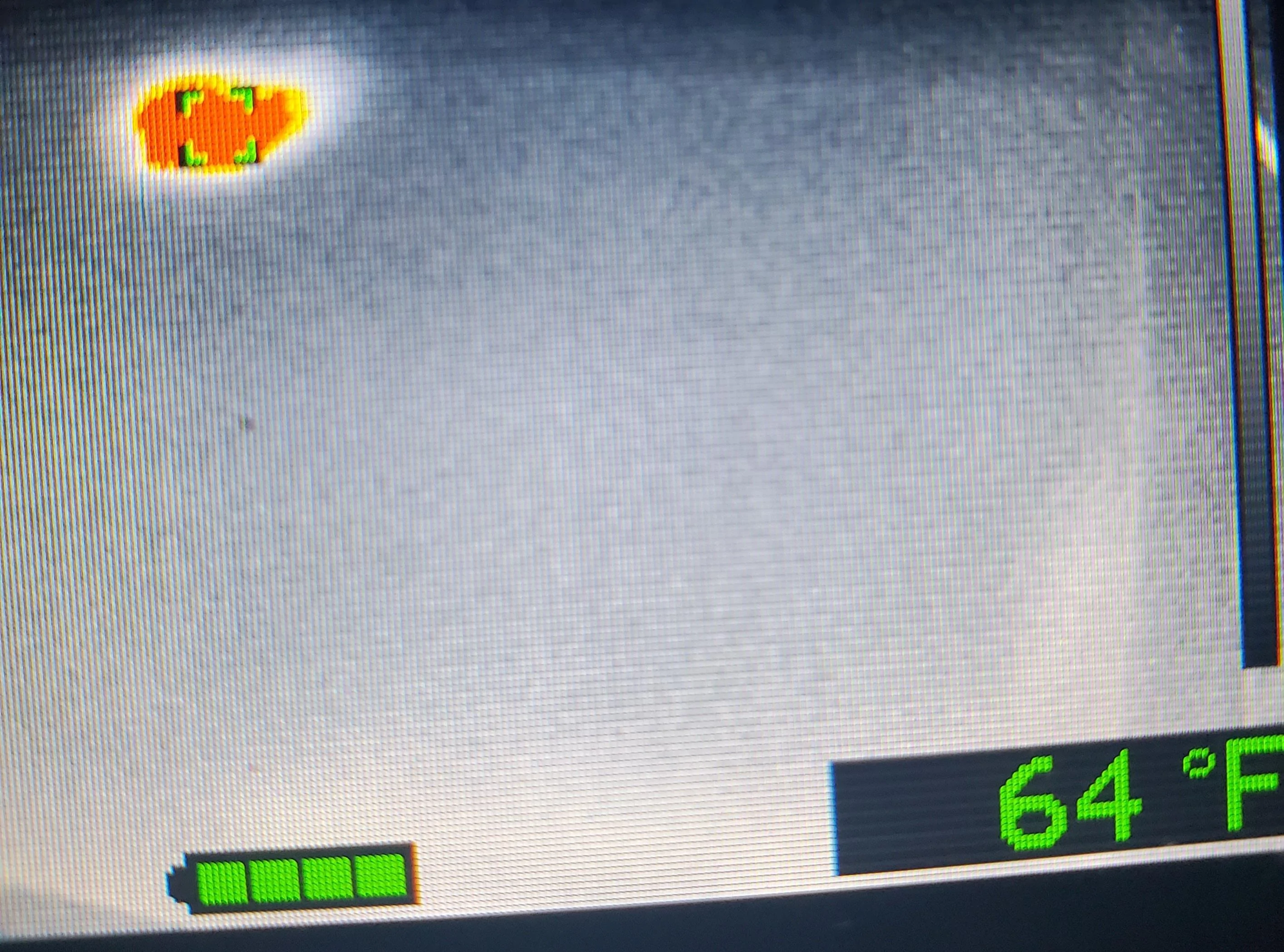

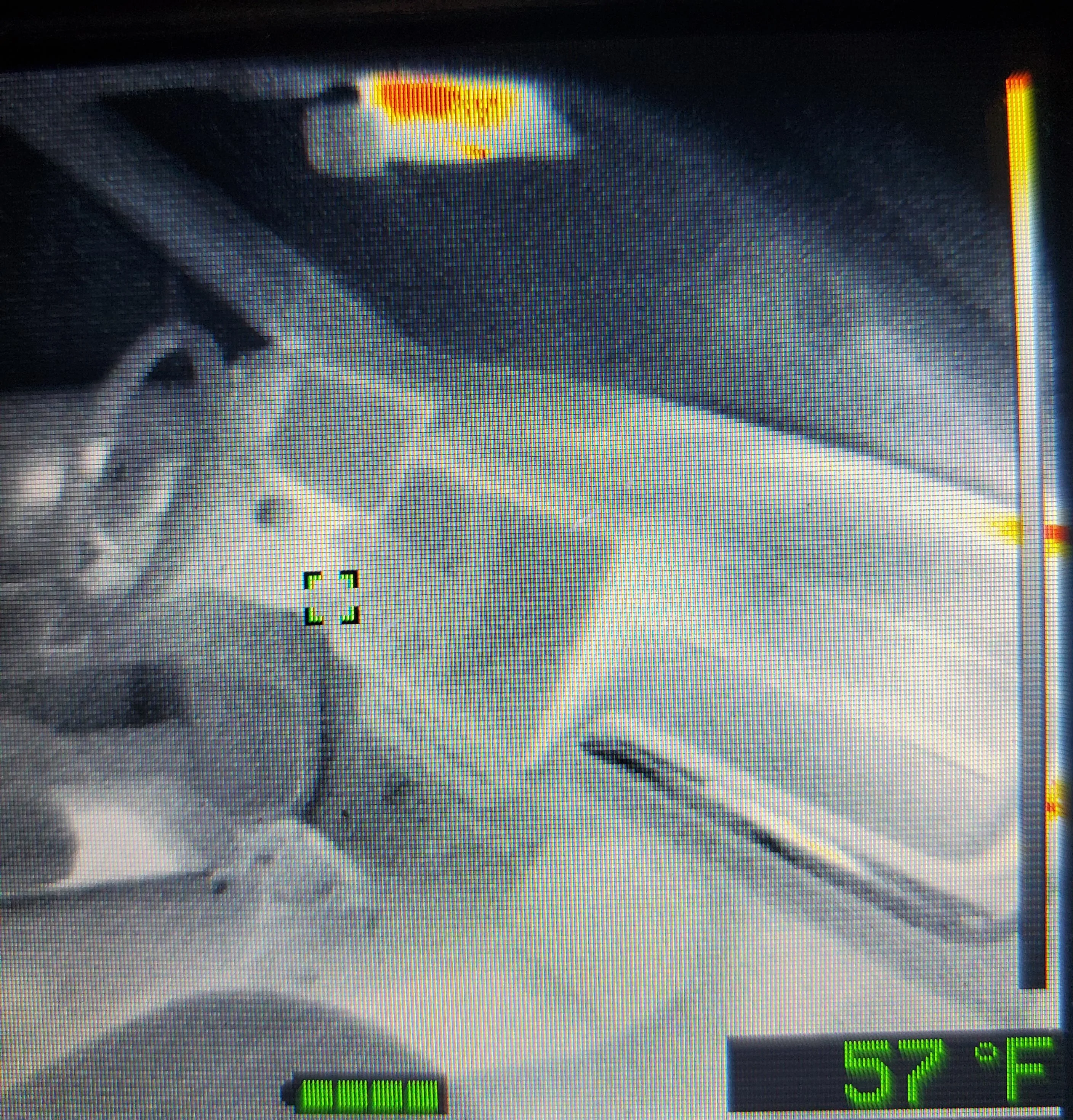

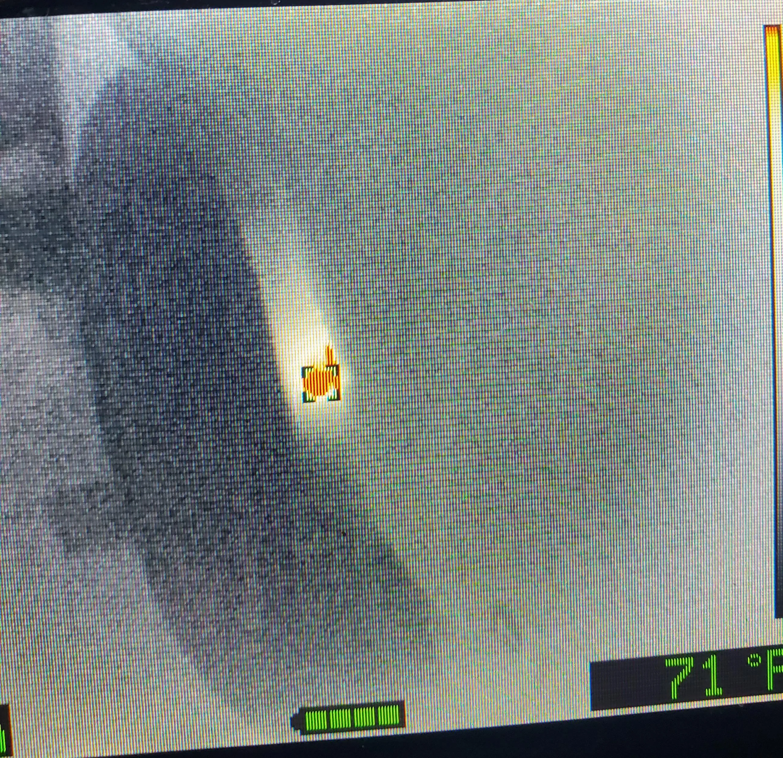

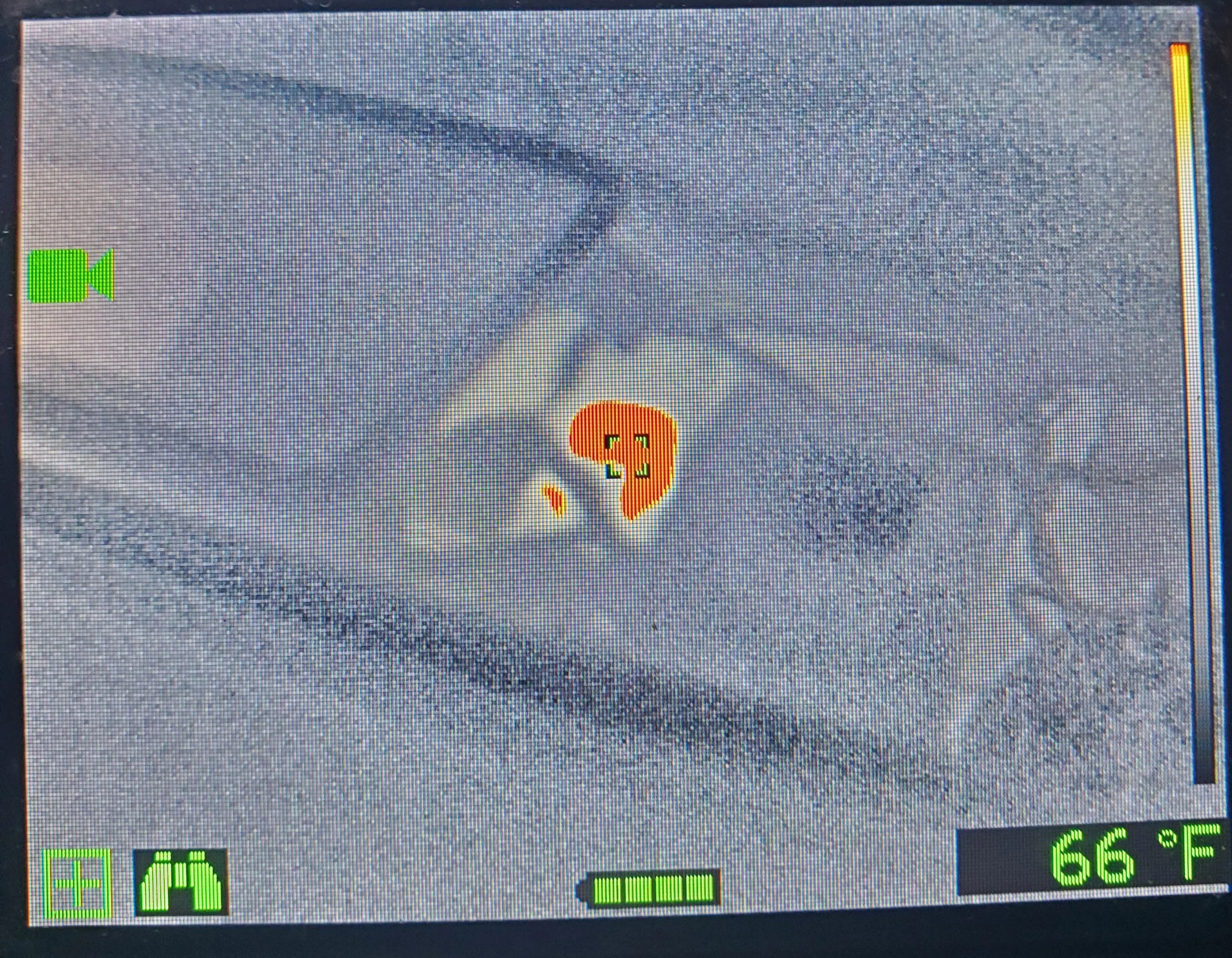

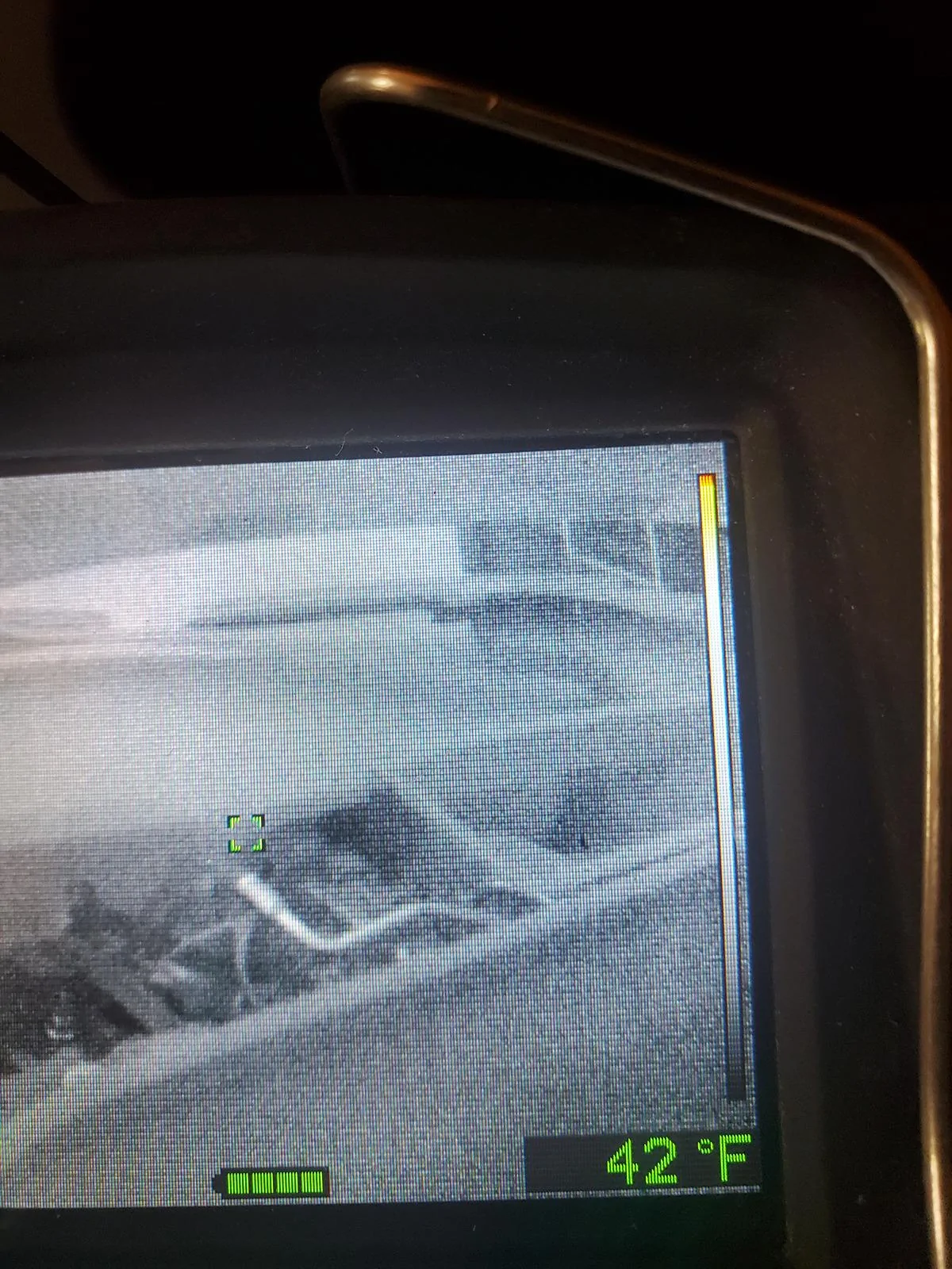

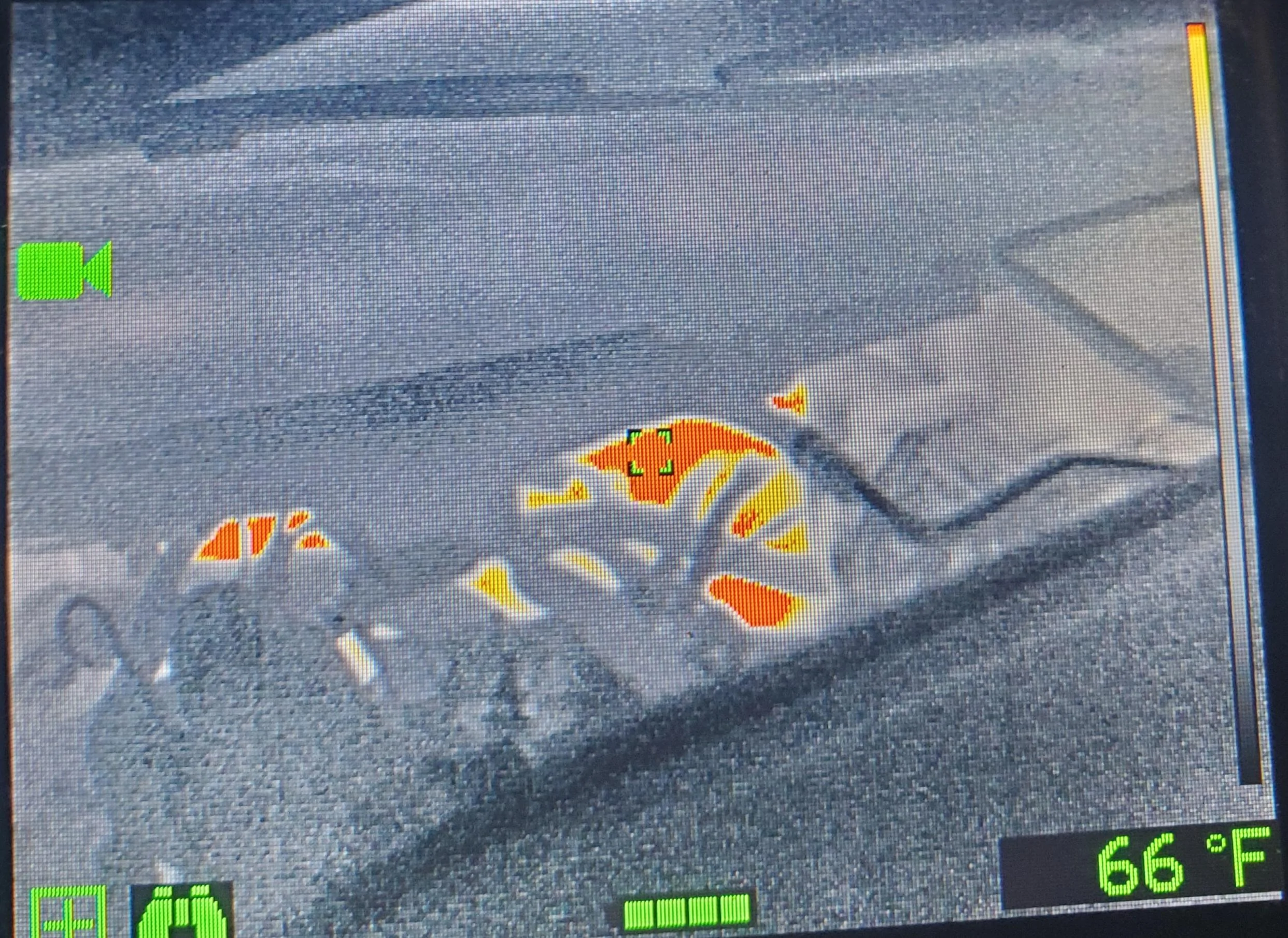

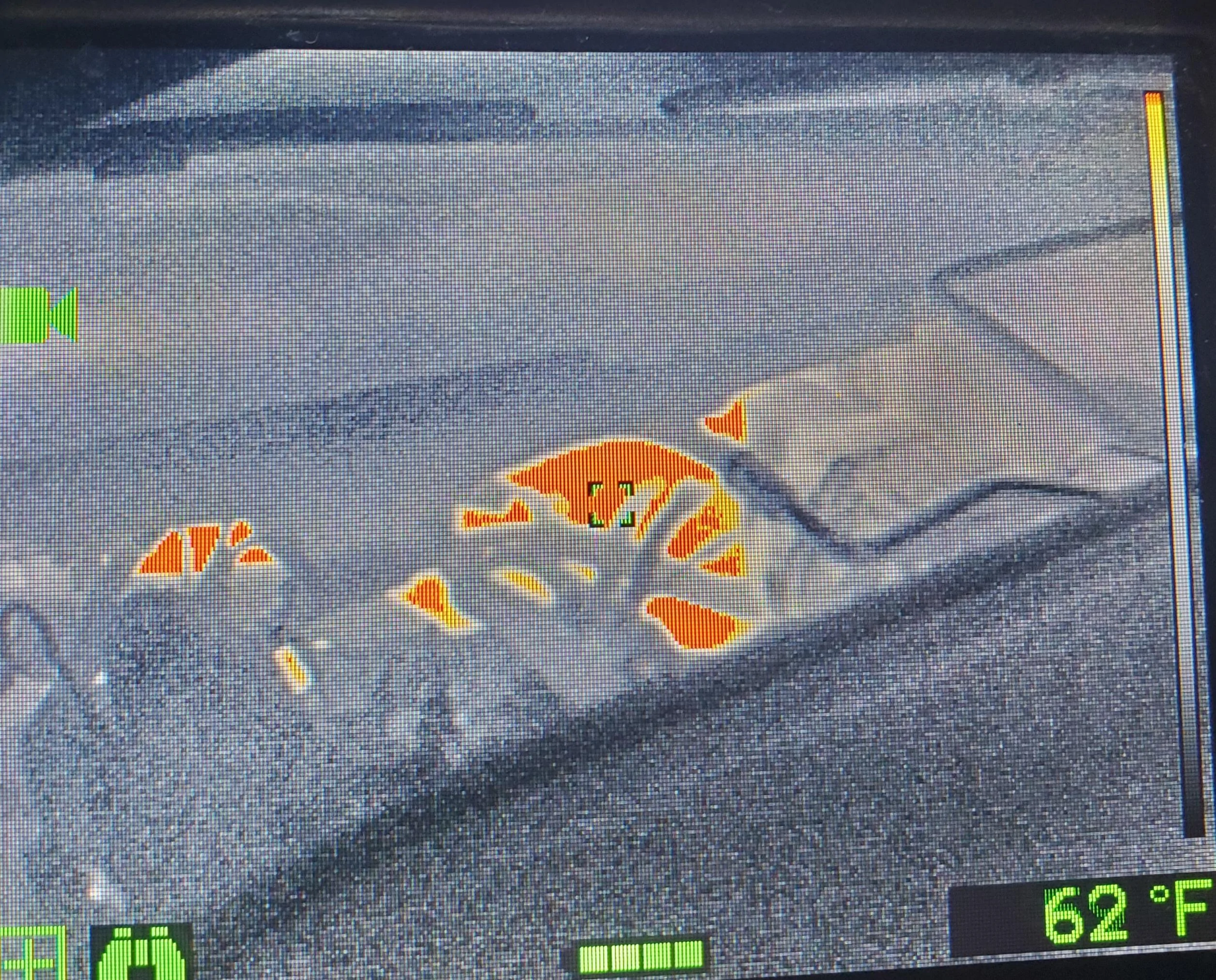

Took some pictures with a thermal camera, I made sure all Bluetooth was disconnected and key fob disabled 24 hrs. before these photos. Ambient temp in garage is about 50 degrees F.
Removed plastic cover in frunk for some of the photos. It seems that the things making heat are the cameras, u.s. sensors, and what look like coolant lines running into the fire wall. Also the entire dash is warmer than my work car by about 7 degrees. Most other areas I could see were ambient temperature.
Driver side Cowling
Rivian R1T R1S R1T phantom drain and possible work around Driver side cowling
Driver side camera
Rivian R1T R1S R1T phantom drain and possible work around driver side camera
other car in garage interior
Rivian R1T R1S R1T phantom drain and possible work around reference car interior
pass side cowling
Rivian R1T R1S R1T phantom drain and possible work around pass side cowling
interior
Rivian R1T R1S R1T phantom drain and possible work around interior
windshield
Rivian R1T R1S R1T phantom drain and possible work around Windshield
pass side cowling
Rivian R1T R1S R1T phantom drain and possible work around pass side cowling (2)

Basically what you are saying is that all the cameras are running even with gear guard off? Try cycling all the settings for that feature. Maybe a software bug or maybe big brother just watching all the time.
My car definitely just decides to wake itself up for no reason. Super annoying.

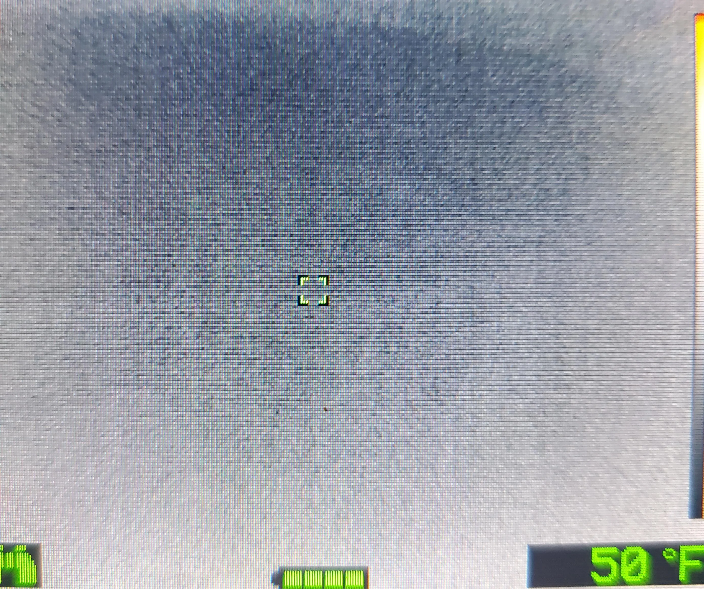

Finally posting an update to the thermal pictures I had before, but there is basically no heat coming from under thew cowling or anywhere else on the vehicle.
Rivian R1T R1S R1T phantom drain and possible work around 20240323_135244
Rivian R1T R1S R1T phantom drain and possible work around 20240323_135057
