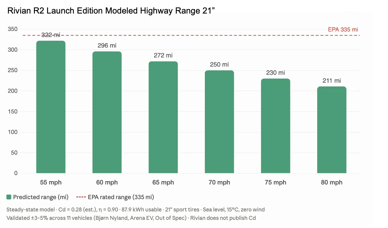

This is a longwinded post but the short version is I figured it was pretty straightforward to build a decent model to predict highway range. So I got together with Claude and Gemini and we did. I did this for another reason but then ran R2 through it and thought you folks would find it useful. The result is this: an AWD Launch Edition with 21" road tires should deliver ~250 miles of highway range at 70mph sea level in good weather (note Out of Spec at higher altitude add ~20 miles). This is pretty competitive with Model Y (Motortrend just benchmarked it at 252 which is consistent with the model).
I've summarized the model details below and attached the full writeup in pdf. It is sensitive to input data so that as always is the key caution.

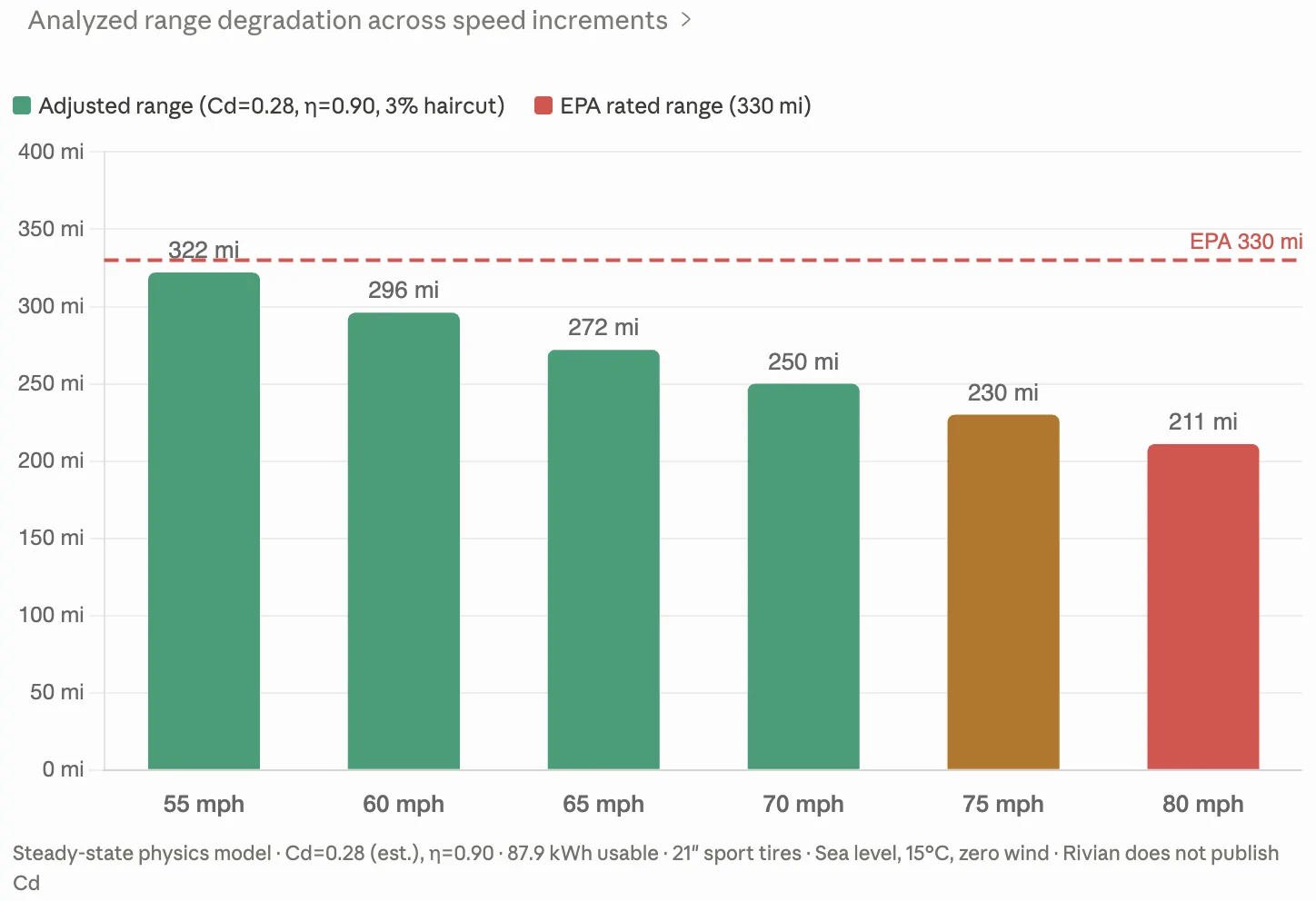

EDIT - Updated the EPA estimate to 335 from 330 (no impact on model)

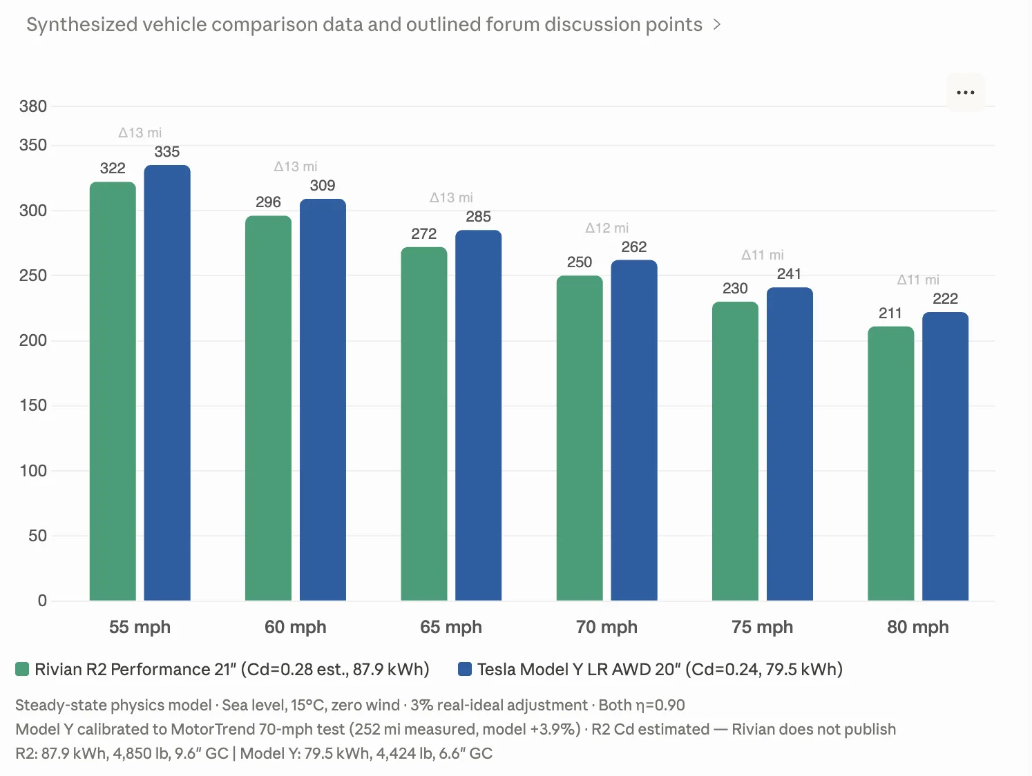

Here is the modeled 2026 Model Y for comparison (AWD 20" wheels)
The Calculation
1 Mechanical Power Requirements
The mechanical power required at the wheels to sustain a constant velocity is the sum of aerodynamic drag power and rolling resistance power.
Aerodynamic drag power, which overcomes air resistance, scales with the cube of velocity:
P_aero = ½ × ρ × v³ × Cd × A
Rolling resistance power, which overcomes tire deformation and surface friction, scales linearly with velocity:
P_rr = m × g × Crr × v
Where ρ is air density (kg/m³), v is velocity (m/s), Cd is the drag coefficient, A is the dynamic frontal area (m²), m is total vehicle mass including payload (kg), g is gravitational acceleration (9.81 m/s²), and Crr is the rolling resistance coefficient.
2 Electrical Power Draw
The total draw from the battery pack adjusts the mechanical power requirement for drivetrain efficiency and adds the constant auxiliary power demand:
P_total = (P_aero + P_rr) / η + P_aux
Where η is the hardware-specific drivetrain efficiency and P_aux is the baseline auxiliary power draw for thermal management, computing, and HVAC systems.
3 Range Calculation
The consumption rate in Wh/mi is derived by dividing total power by velocity and converting units. The theoretical range is the usable battery capacity divided by this consumption rate, multiplied by the 0.97 real-ideal adjustment factor:
Consumption (Wh/mi) = (P_total / v) × 0.44704
Range (mi) = (E_bat × 1000 / Consumption) × 0.97
The 0.97 adjustment factor (3% haircut) was derived empirically from calibration against multiple benchmark vehicles and accounts for BMS management overhead, parasitic losses in power distribution, and minor regenerative braking losses during speed maintenance that are not captured in the steady-state power equation.

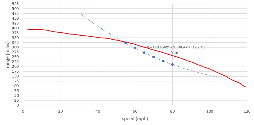

I didn't dig into the calculations the AI did, but I think something is amiss. I plotted out the numbers and the curve has the wrong inflection. As speed increases, the range should drop exponentially. As noted, the power requirement goes up to the 3rd power with velocity. I drew in a representative curve shape, ignore the position. Be careful about trusting AI.
Edit: I was wrong about the inflection of the curve :)
A couple of quick points: first this is not an ai output, it is an excel model (which i am happy to upload if you would like). Where the AI is useful is in validating the methodology and gathering the key variables from around the internet (cd, curb weight, frontal area, fill rate, etc. etc.).
That said, the curve shape is actually correct. You're right that power scales with v³, but range is energy per mile, which divides power by velocity one more time. So consumption scales with v², and range follows a reciprocal quadratic — exactly the shape the blue dots show. Your quadratic fit with R²=1.0 is actually confirming the model, not contradicting it. The red curve you drew would be correct for a power-vs-speed plot, not a range-vs-speed plot.
Power = ½ρv³CdA (aero scales with v³)
But consumption per mile = Power / velocity = ½ρCdA (scales with v², not v³)
And range = Battery / Consumption ≈ Battery / (av² + b)
So range versus speed follows a reciprocal quadratic, not an exponential. It's a gentle curve, exactly like the blue dots show. The quadratic fit with R²=1.0 actually confirms the model is producing the correct mathematical shape.

I'm a bit sleepy, but check my equations:
energy = power * time, ex. 100kW x 1hr = 100kWh
time = distance/speed, ex. 50 miles / 100 mph = 0.5h
energy = power * (distance/speed)
distance = (energy/power)*speed
Power scales with speed^3 and is in the denominator. Energy= battery capacity = constant. So as speed increases, the denominator should increase faster, so the distance shall decrease?
Again, a bit sleepy, not all the neurons firing, but it didn't look correct to me at first glance.
The Validation
The model was validated against two independent benchmark datasets: Arena EV (controlled-speed road tests at 56 and 81 mph in Europe) and Out of Spec Reviews (70 mph highway range tests in the United States). The steady-state physics model described in this paper provides a reliable, transparent, and validated method for predicting highway range of battery electric vehicles at constant speeds of 70–81 mph. The model achieves ±3–5% accuracy against independently measured benchmark data when environmental conditions (altitude, temperature) are accounted for.
