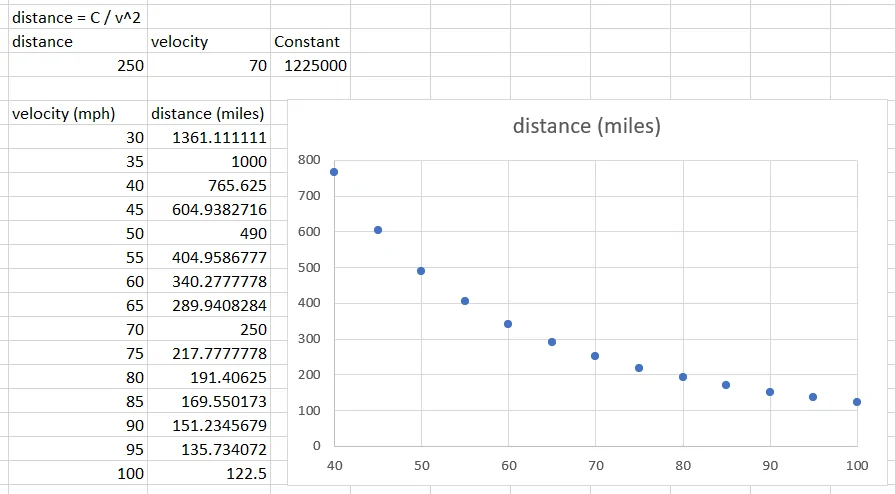

K, I'm a bit more with it this morning. Assumed 250 miles at 70mph as the reference point to calculate a constant to bundle in battery capacity, drag, frontal area, etc. Plotted out. Of course, this is a much more simplified calculation which leaves out the details of linear scaling of rolling friction, etc. Just wanted to see the shape of the curve which my initial intuition was incorrect about.
Rivian R1T R1S R2 Highway Range at 70MPH = ~250 Miles (Modeled) 1777301949190-g9

I didn't dig into the calculations the AI did, but I think something is amiss. I plotted out the numbers and the curve has the wrong inflection. As speed increases, the range should drop exponentially. As noted, the power requirement goes up to the 3rd power with velocity. I drew in a representative curve shape, ignore the position. Be careful about trusting AI.
Edit: I was wrong about the inflection of the curve :)

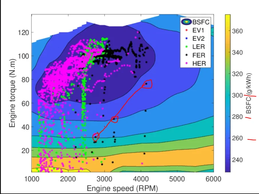

This is actually easy to explain. Internal combustion engines are notoriously inefficient at low loads. At higher loads, their efficiency goes up (less throttling losses as the throttle body is open more, more heat energy goes into pushing the piston down instead of into the coolant/oil/exhaust, etc). Every internal combustion engine will have what's called the Brake Specific Fuel Consumption map. The units in this particular plot are grams of fuel burned to get a kWh of energy out of it. So, the lower the number the better. This study had a bunch of different drive cycles plotted on the map. I drew in the red line to illustration going from a lower cruising speed/lower load to a higher cruising speed/higher load. At the higher load, you can see the BSFC values get lower which means better efficiency. Peak internal combustion engine efficiency is always at high load and low-mid engine rpm. Engine friction increase exponentially with engine speed.
Rivian R1T R1S R2 Highway Range at 70MPH = ~250 Miles (Modeled) 1777346561419-hg
