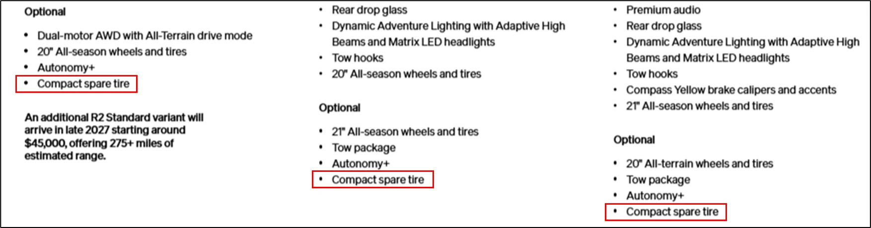

So I won't be able to use my compact spare, that stinks.
What's the story w/ optional compact spare tire? Where is it carried? In/out of sight? Hopefully well-secured wherever it is?

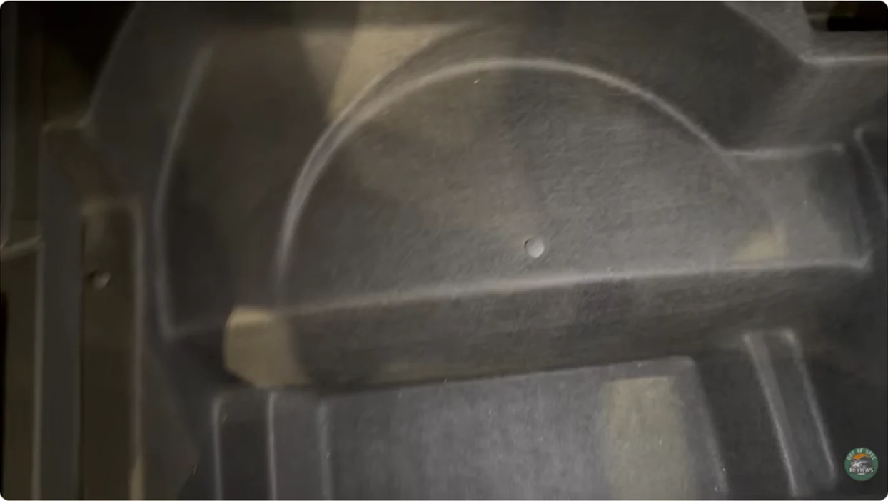

There appears to be recess in the subtrunk that's designed to fit the compact spare. Slightly molded in. I think it was shown in one of the recent Austin walk-around videos on Youtube with the Normal pre-production vehicles.
You can see the spot on Kyle's video from out of spec with the R2 with Scott (holding the camera)
Yep, there it is, thanks!
