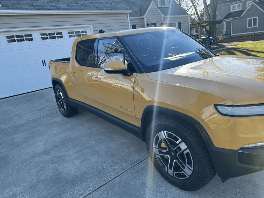

Funny update. They still have the truck but have switched out the loaner and now I have this. Discontinued color and discontinued wheels. Maybe its a loaner because it was a combination most didn't want
This swapping of loaners after a month is truly the definition of insanity. All it does is create more work for Rivian!?!? Why would they do that to themselves, unless there is some legal requirement to do it?
