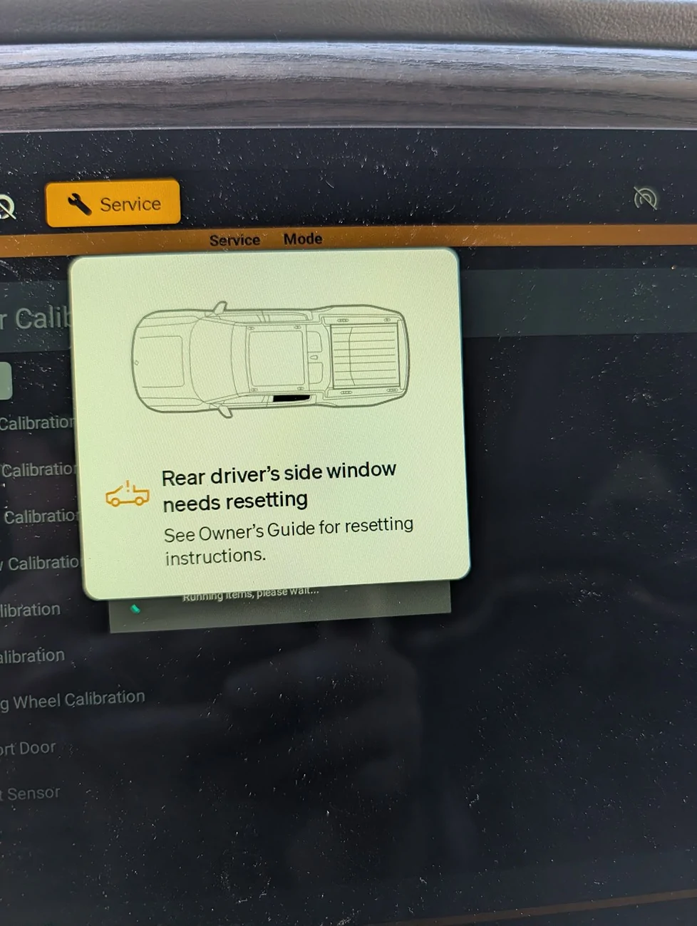

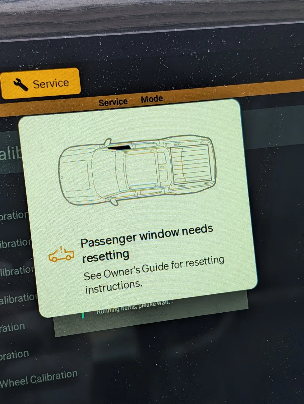

I wasn't going to start a separate thread, but it's related, so I'll jump in: this thread reminded me I was going to do the calibration to try to resolve the wind noise on my passenger side. When I did it (via RIDE), it popped up this message for a couple windows. No idea how to reset/fix it - I tried doing it via the individual window switches, but that didn't fix the message (it still popped up when I did another RIDE calibration).
