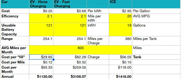

Something like a Kia telluride would be half the fuel cost and no long fueling stops. Even with my high @$$ electric cost up here, at least my home charging is still a "savings" vs ICE.
This assumes an 800 miles. which is probably about as far as most people would road trip, regardless of distance or battery size (range) the cost per mile would be the same.
Anything above $0.32/Kwh makes gas, at the current price of gas, the lower cost travel options vs DCFC

One gallon of gas is 33.7kwh. just multiply the two numbers.
While that is correct, that would be if you're converting gas into 1 Kwh of ENERGY. that is not the way to truly convert mil/Kwh into MPG. Most cars can go >25miles on 1 gal of gas, but EVs only ~2 miles on 1 kwh.
