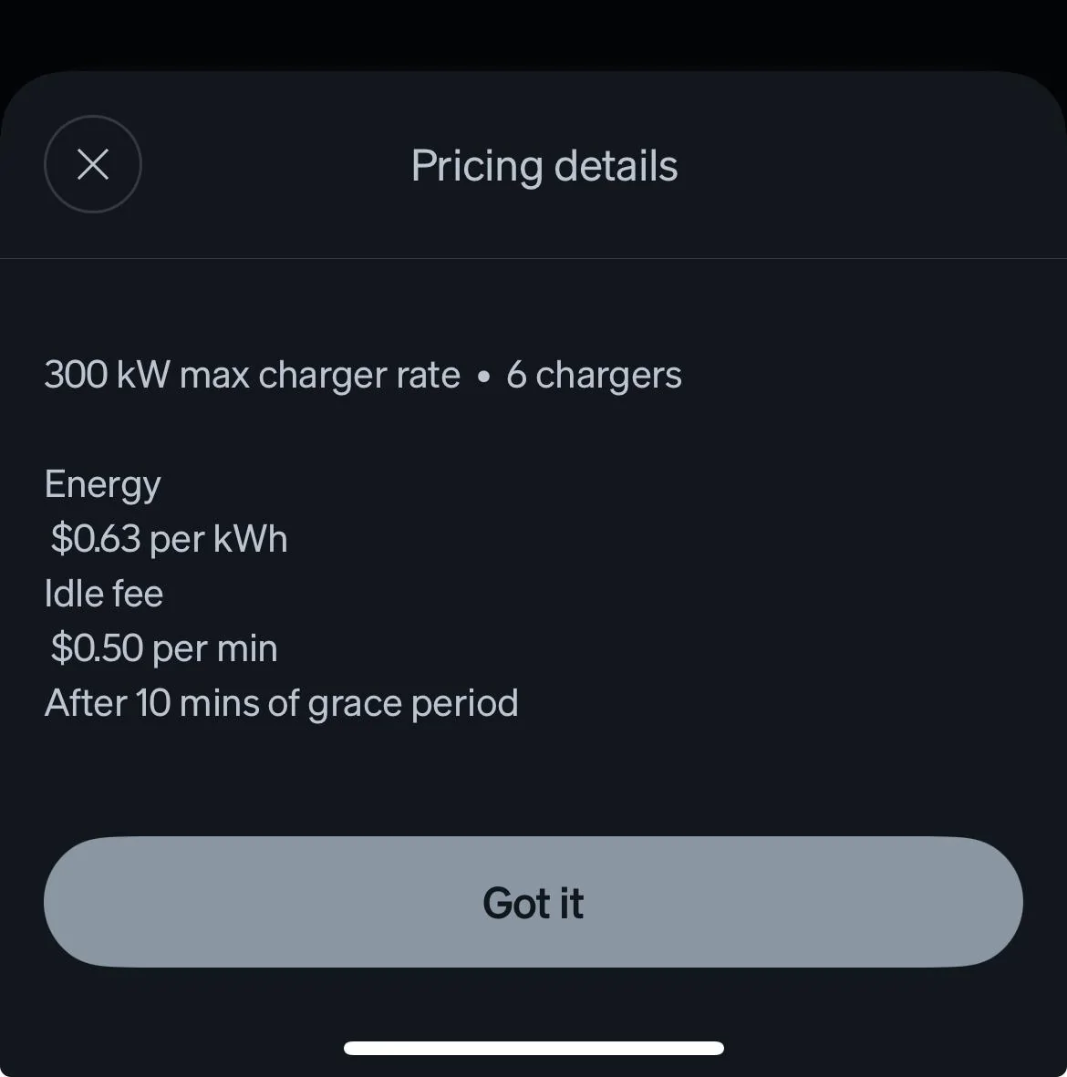

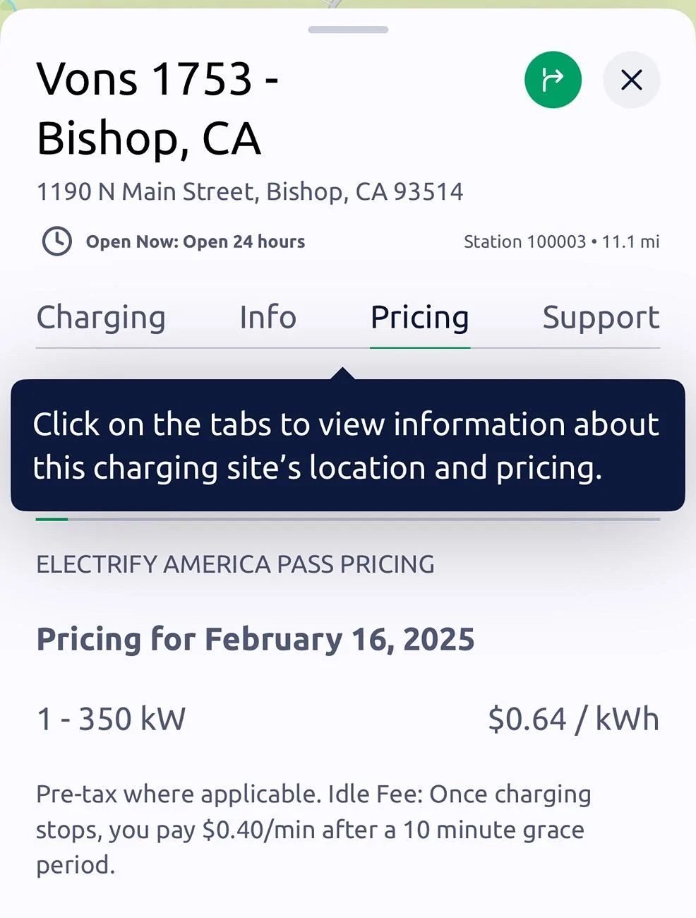

did rivian switch to TOU pricing? i swear I checked last night and prices were $0.36. today i see $0.64 (5pm). will check later tonight and tomorrow.
it would make sense to have TOU pricing but i see no way to access a schedule in the rivian app. pretty sure tesla has TOU prices and i don’t see that anywhere in the rivian app either.
