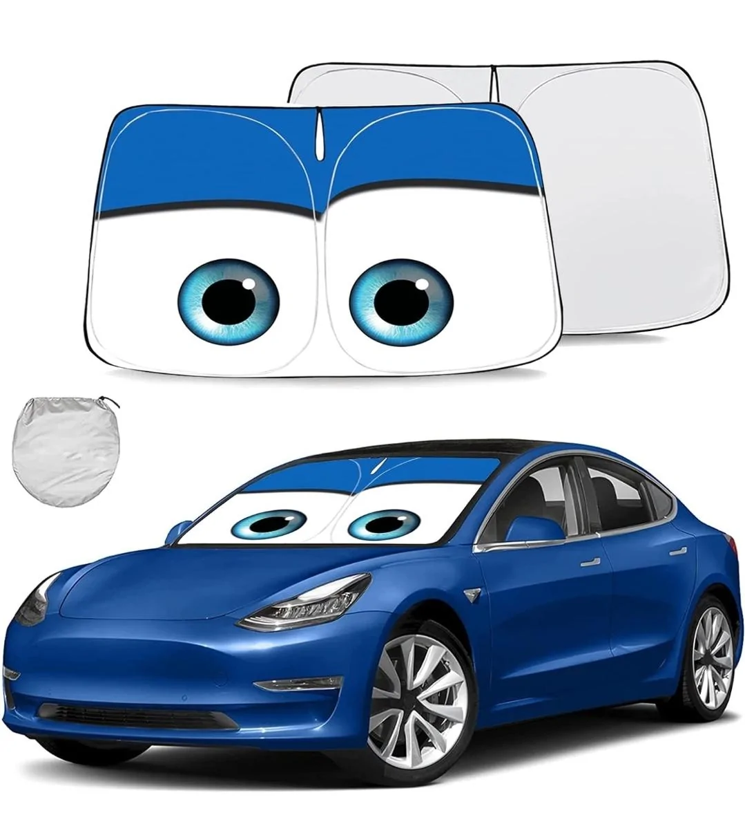

I haven't used a car shade since I was in college and used to park my vehicle and a lot for an entire week all year, but if I were to buy one today for the Rivian I think it should be mandatory to get one like the cars eyes....
Gven for Tesla Model 3 Sunshade for Tesla Model Y Windshield Sunshade 2016-2024 Car Shade Front Window Shade Double Layer Blocks UV Rays Sun Visor Protector 100% Cover (Blue Eyes) https://a.co/d/bjwiyjm
