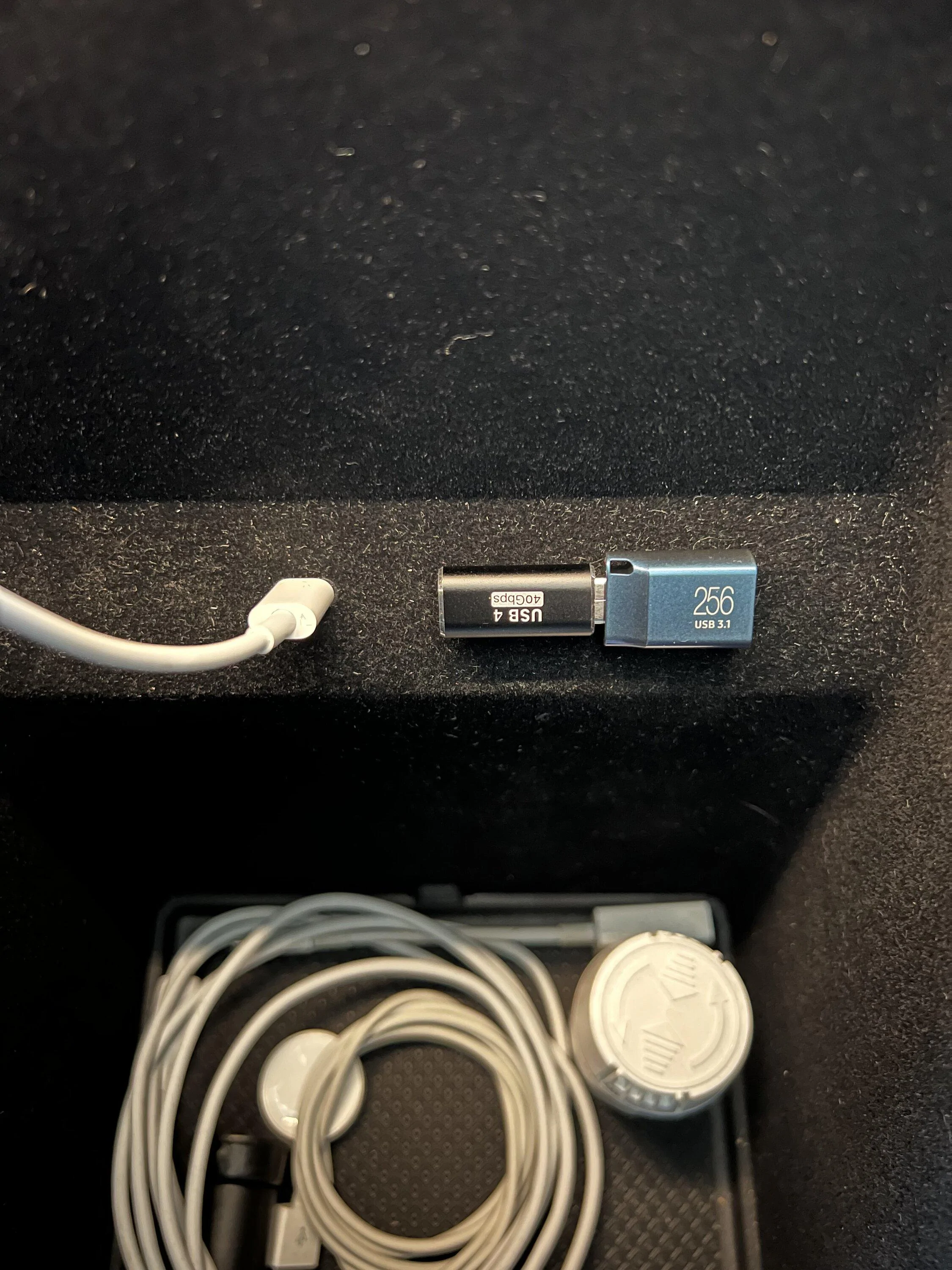

Super simple setup here with an 90-degree rotated USB-C adapter and a Samsung 256GB. Am still considering a true dash cam.
Rivian R1T R1S Show off your dashcam memory card install IMG_2990

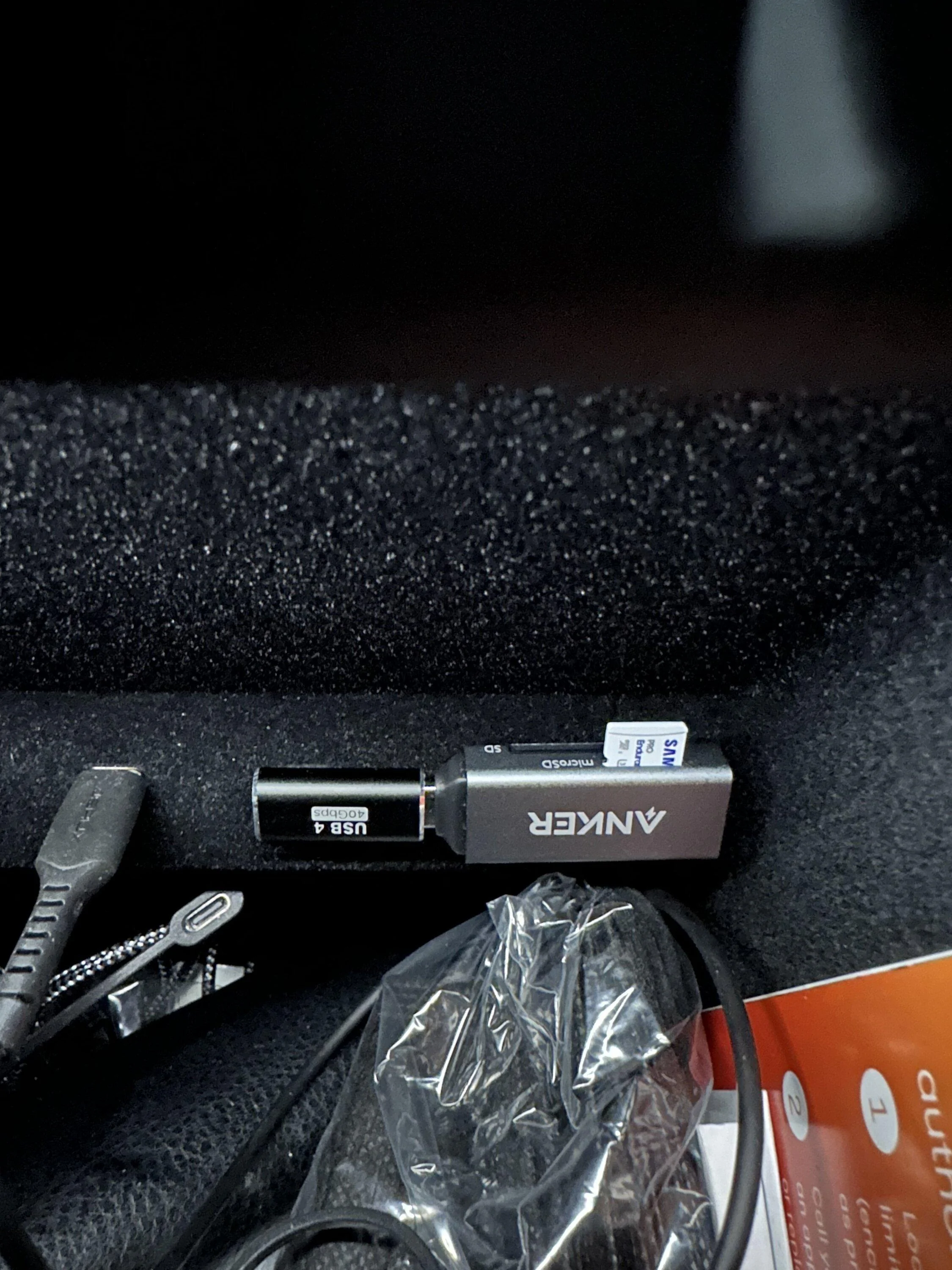

Samsung SD, Anker reader and 90 degree connector. Works well so far.
Rivian R1T R1S Show off your dashcam memory card install 270AA47D-3FE5-4726-AAAD-8DFBAF8069A7

I haven’t been able to get the Anker to work consistently (ordered from Amazon). It formatted and passed all the tests and I recorded a short video. Left the truck and came back and it said no card was setup. If I pull the microsd card and put it back into the anker the truck recognizes it again. So basically with the anker every time the truck stops I have to re-plug-in the microsd card.
not exactly a workable solution. I am going to try to order a different usb-c to microsd adapter: SmartQ C356 Type C (same one others have linked to in this thread) from Amazon.
Got it, for what it's worth I've been out of town since last Wednesday and just tried again today and now it's working. I'll see how it holds up and if I experience any issues like you mentioned.
