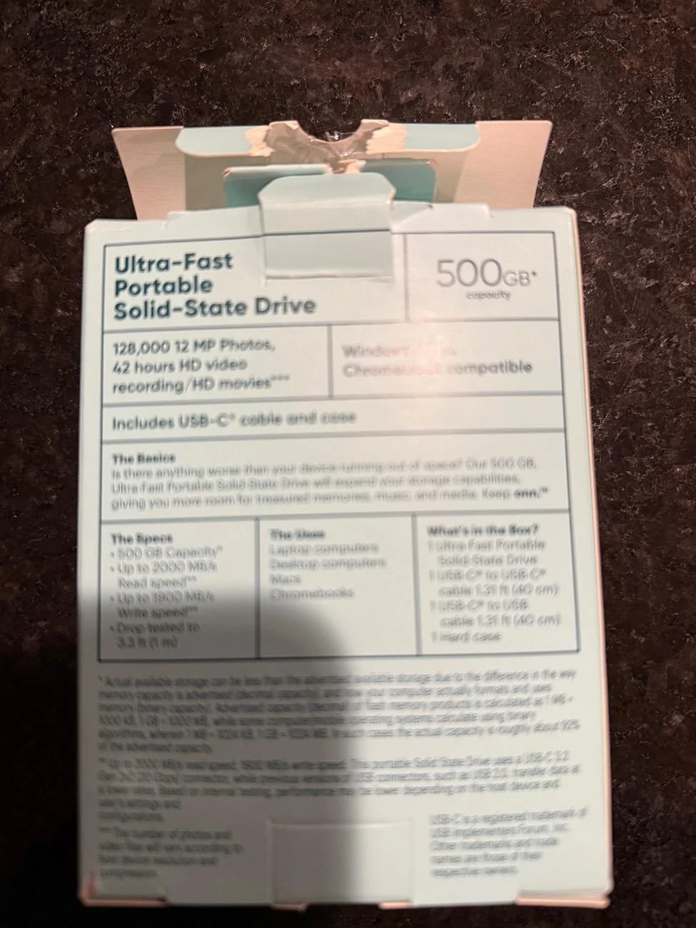

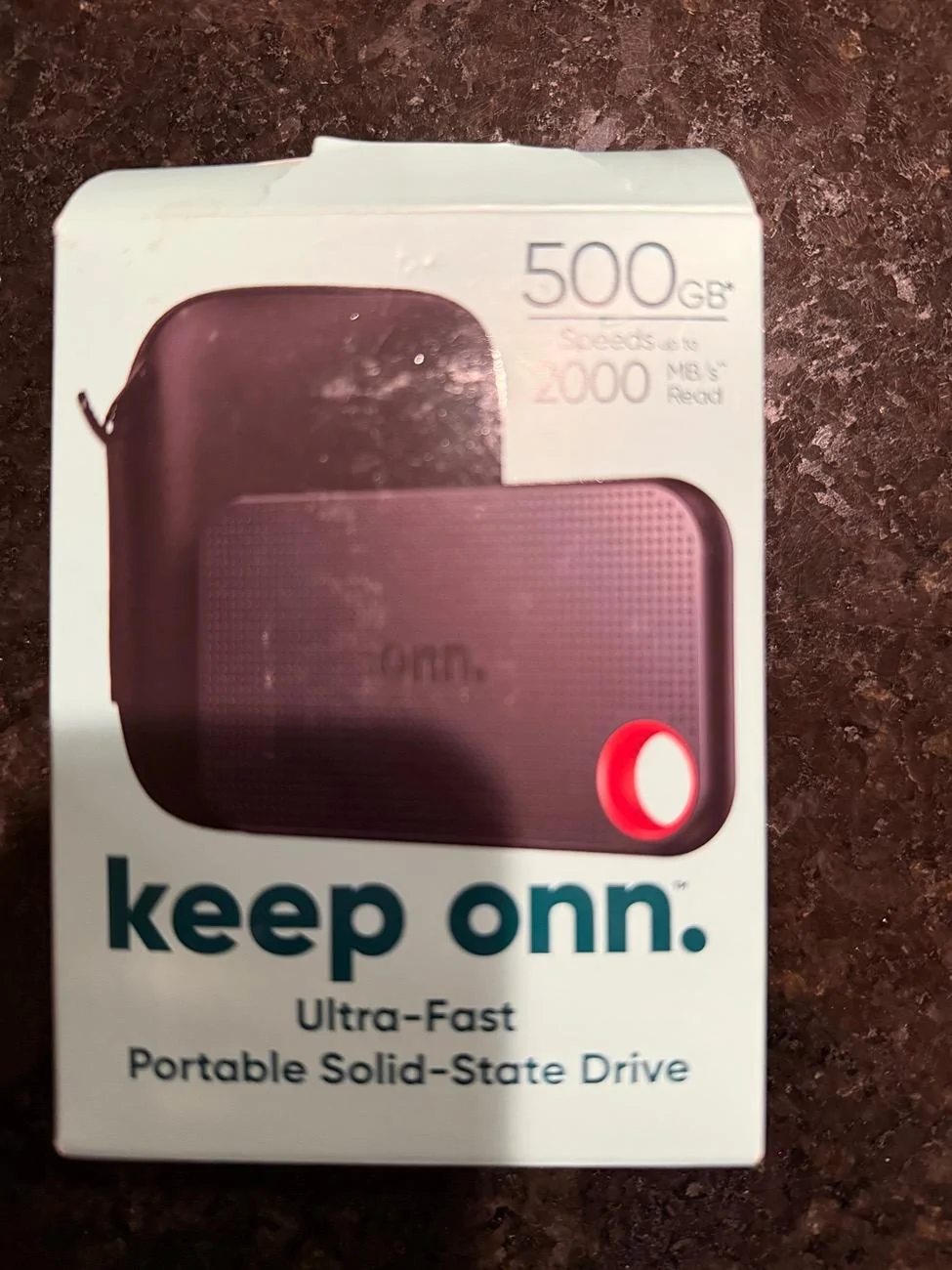

This inexpensive ONN 500gb drive works perfect in our Gen2 R1S. Comes with a case and both USB-A to USB-C and USB-C to USB-C cables. Paid $59.99 at WallWort.
