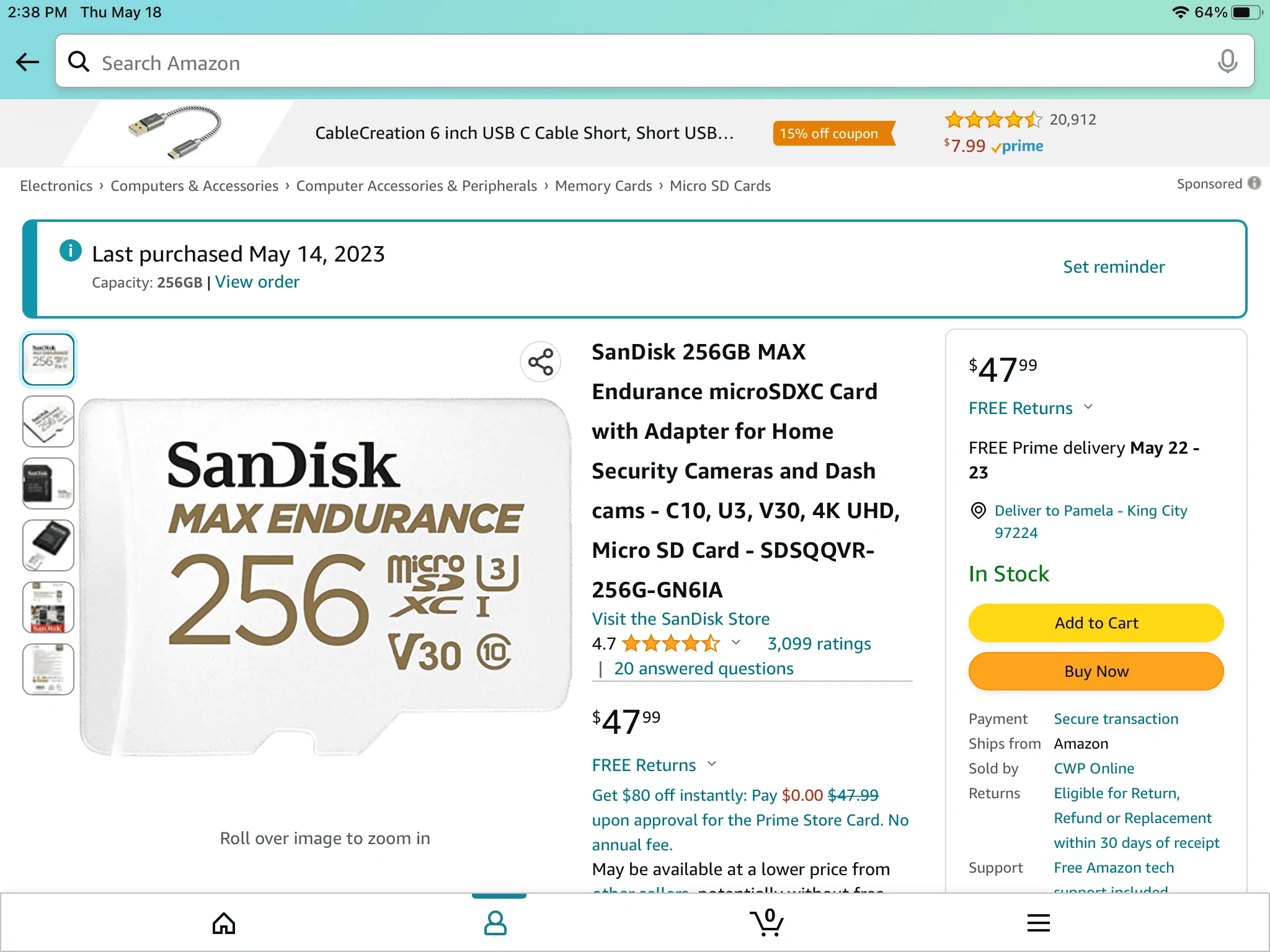

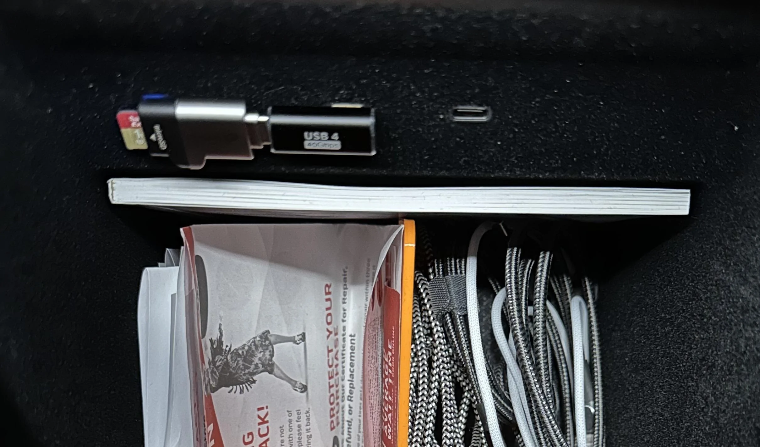

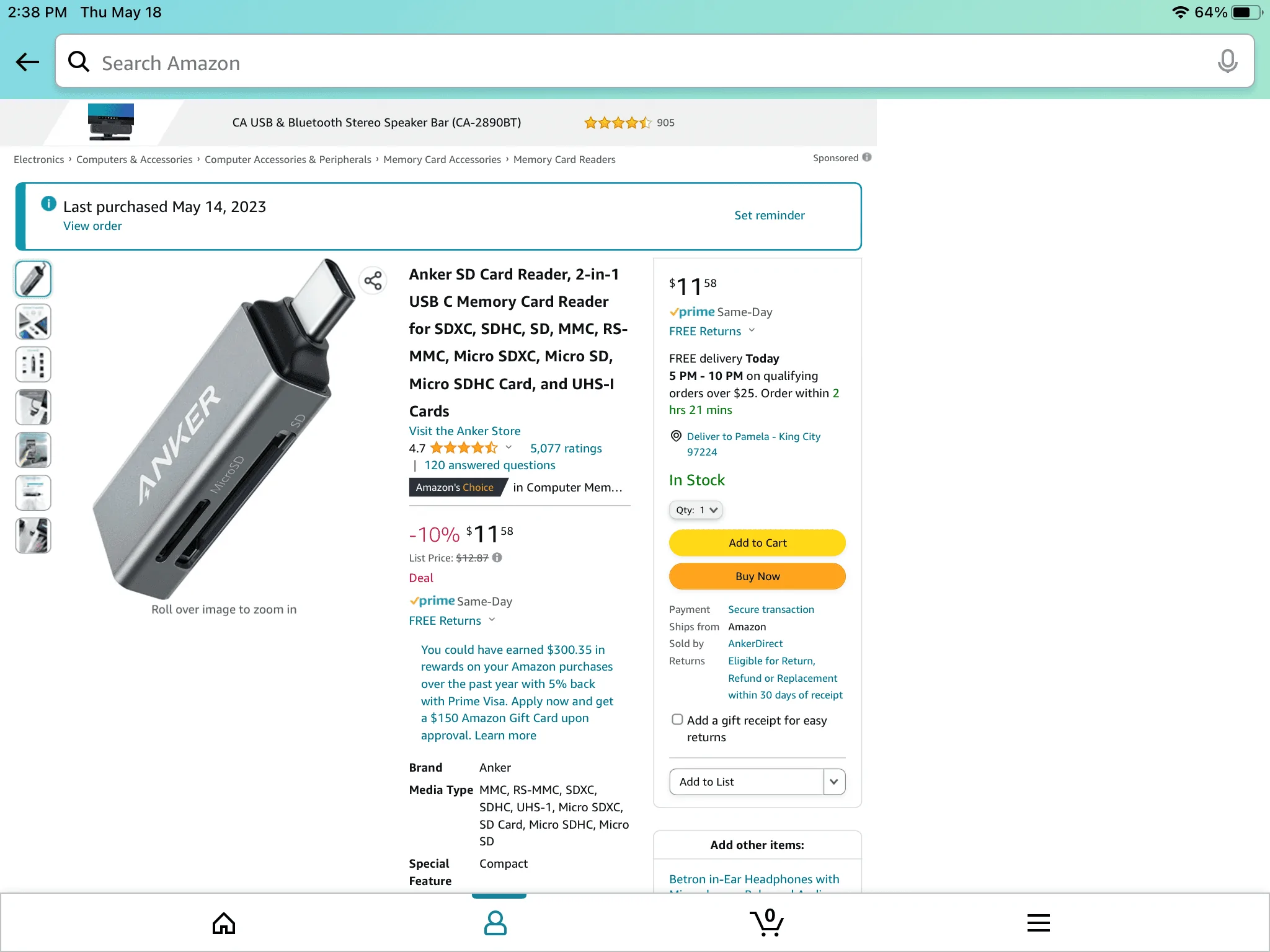

Using these two devices. Still haven’t figured it out yet.
I am using the same setup with an Anker card reader and SanDisk Max Endurance 256 GB with a right angle adapter, but I can't get it to work. I thought it was a bad reader, so I replaced it and I still can't get it to work. Is anyone able to get the Anker to work? I will try getting a different reader, but wanted to see if I can somehow use the one I already have.

Can you confirm functionality of the setup on a different product? connect to your phone or computer and see if you can read the card?
sakugo
Sameer
Dec 7, 2023
Florida
I was able to read the card when I connected it to my Mac. Not sure why, but Anker just doesn't seem to work with my R1S. I tried removing the right angle adapter and plug in just the card reader, but it still doesn't recognize it. I will post an update after I get a different card reader.
