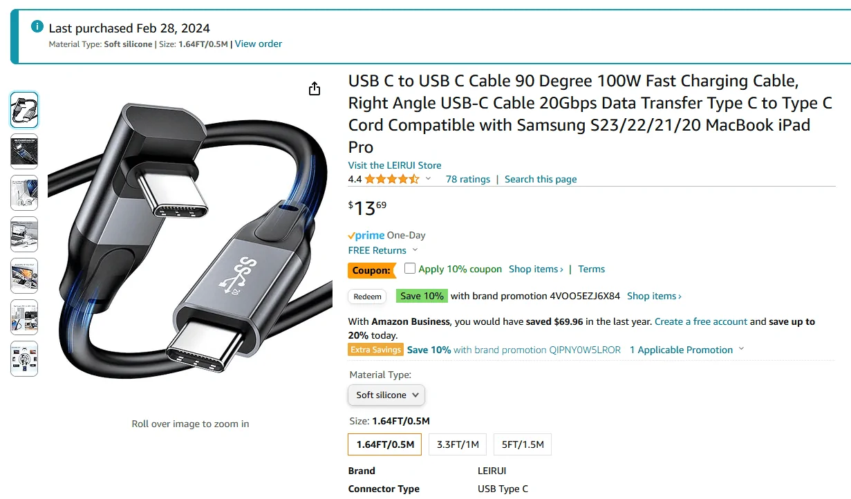

Great use for something you repurposed!
I used a right angle cable to prevent it from sticking out of the truck USB port and possibly breaking while rummaging through the center console:
For my SD card, I already have an adapter that angles sideways (clocked 90* from the one you show) that I was planning on reusing. It's just a USBC-C adapter, so a C-C cable will still work with it. Thanks!

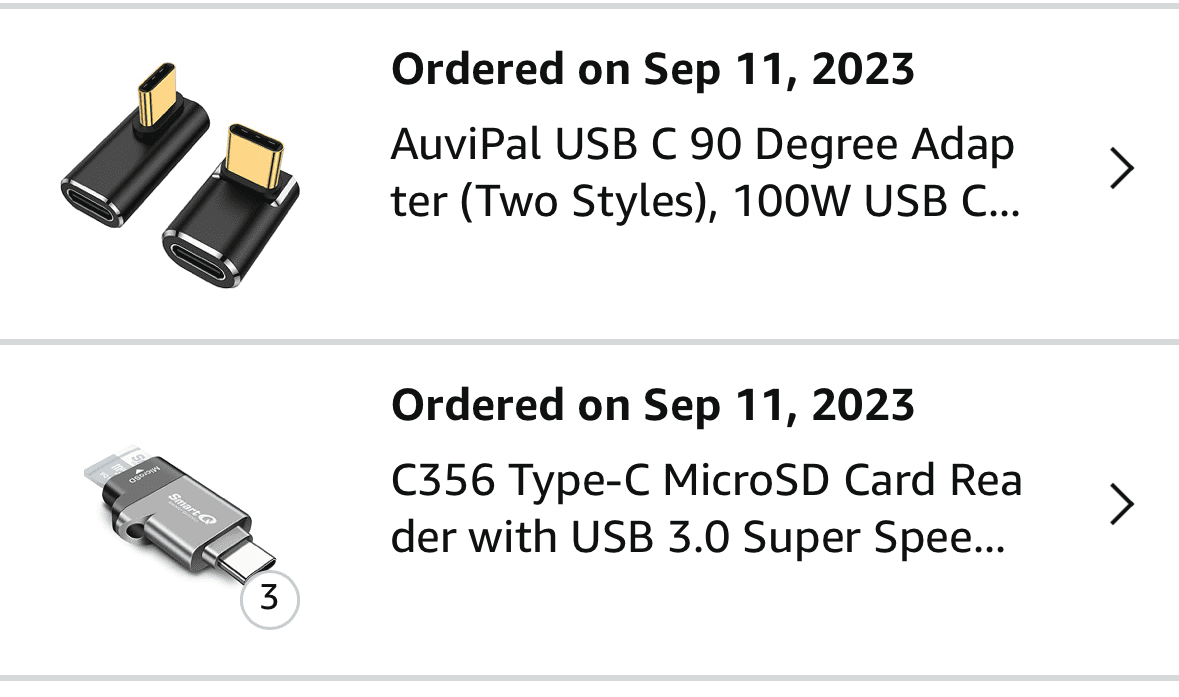

I’ve been through a couple of microSD card readers. Would you mind linking which one you’re using and which 90 you’re using as well?
