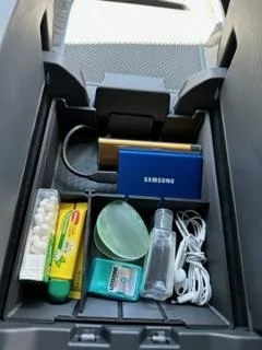

I’m all set up. Now I just need the update!!!
Also - this photo let me know I need to go vacuum my cubby...
Nice. I think I have the same drive.
Do you have a link to that short cable? How are you getting the drive to stick to the back? I tried some velcro I had in my tool chest but it wouldn't stick.
I want to copy your setup!

Happy to help! The drive is a Samsung T7 1TB.
Right Angle USB Adapter: https://www.amazon.com/gp/product/B0BRV9P49S ($10 for 2)
5" Flexible USB Cable: https://www.amazon.com/dp/B0B49WCQX4 ($10)
Industrial Velcro Strips: https://www.amazon.com/dp/B003CEXPSA ($4 for 2 sets)
On the velcro, I had to trim about 1" off the strips lengthwise to make it fit the back of the drive. I used the "hooks" side of the velcro on the drive, and the "loops" side stuck to the wall of the cubby. The backing is super sticky, so no issues with it falling down or coming detached...at least not yet. We'll see how it holds up in the summer heat.
I found the cable with the Samsung T7 was long enough with a right angle adapter to just stick the drive in the elastic in the cubby so that's what I did. No velcro and no extra parts. Just drive (with included cable) and the right angle adapter (more for safety of the connector than anything else)
Just ordered the USB cable and Velcro. Thanks!
Based on your comment, I tried it, too, and it's pretty clean!
I just ordered @cohall solution, too. I'll try both and see what I like better.

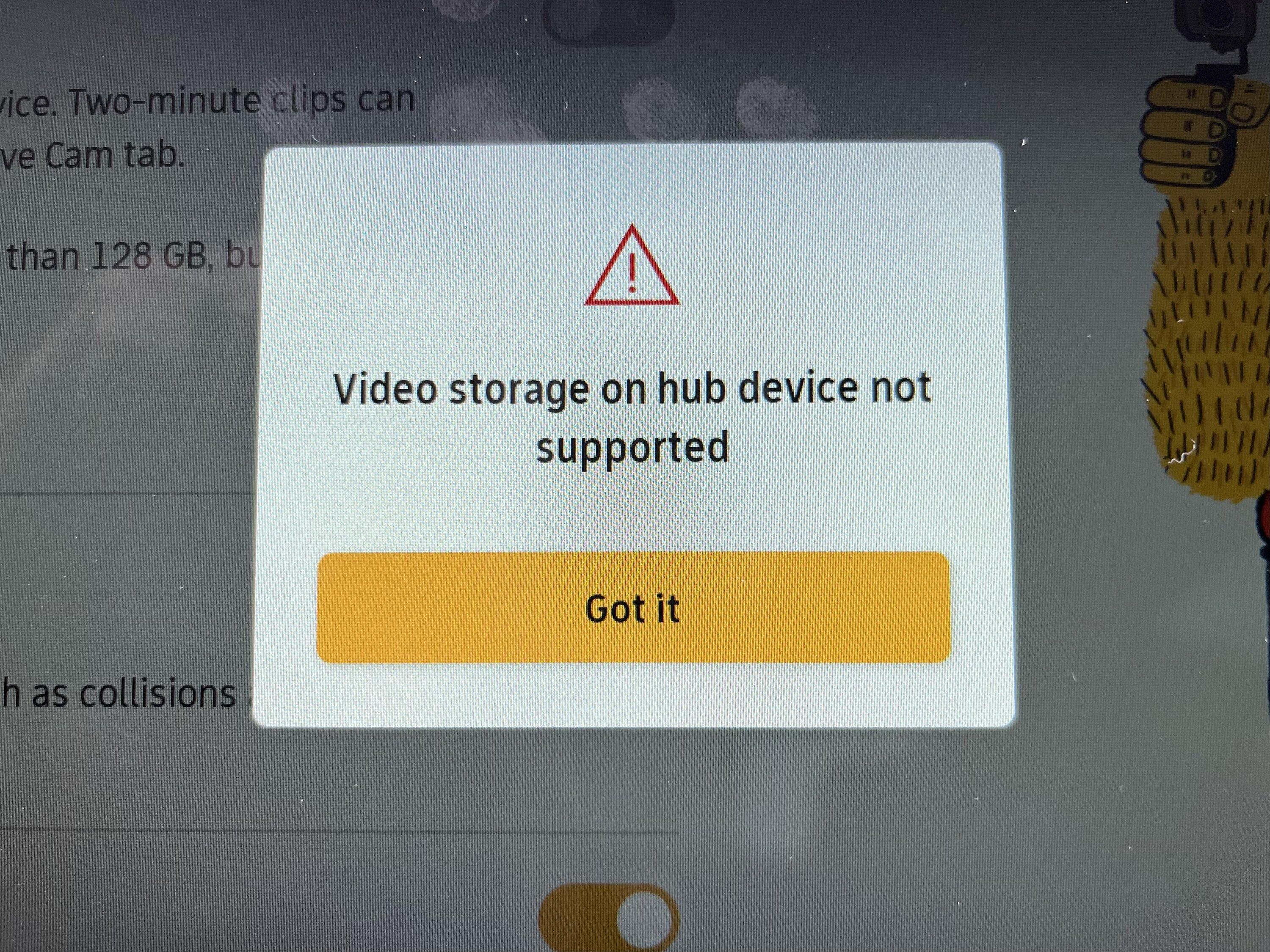

Thought I could get creative with this and retain a usb-a port, but no go since it looks like it's detected as a 'hub'. It did however work fine to download Gear Guard videos before the update. Going to give the basic microsd card reader Kacey3 recommended a try.
