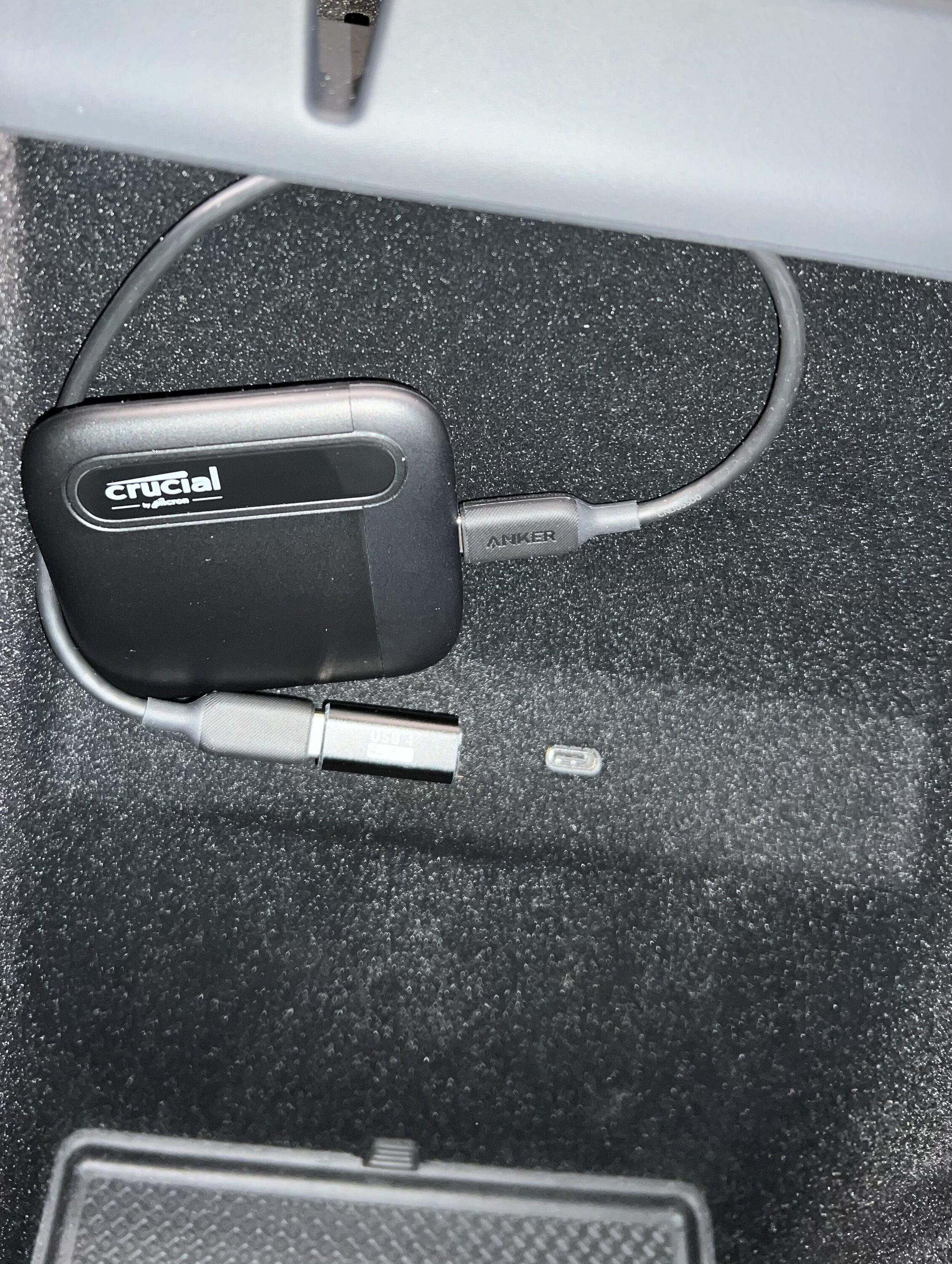

I just got the update tonight, can’t wait to try it out tomorrow. I went with a Crucial X6 1TB Portable SSD. It was only $59.99, bought a right angle adapter and a slightly longer anker usb cable so I could install it like this. I wish Velcro stuck the fuzzy stuff in the console but it seems to sit in their ok for now with out it. If I had it to do over again I would grab the 2tb version since that the drive size limit. Setup went perfect and the drive formatted quickly. Will report back if I have any issues with it.
Rivian R1T R1S Show off your dashcam memory card install 4103656D-C3BD-47BD-A6E5-849FD23ABFD0
