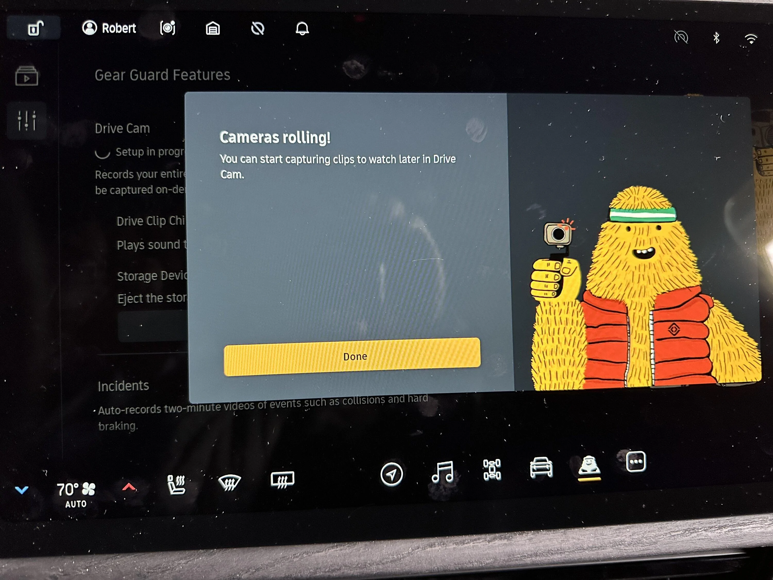

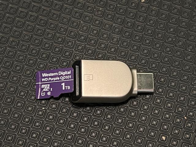

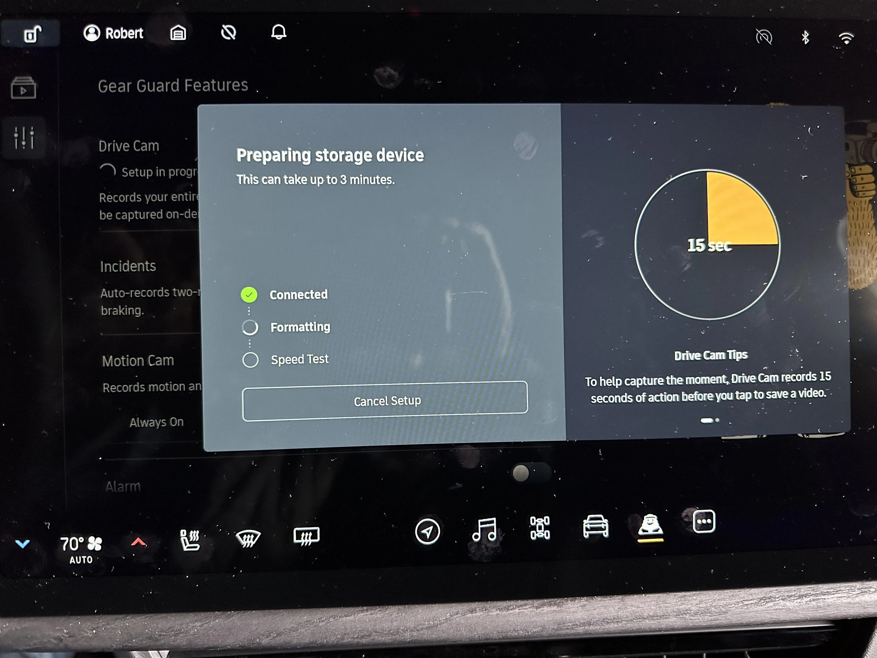

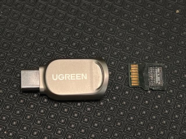

Okay, they arrived - the most compact metal-bodied (for heat dissipation) USB 3.0 Type-C microSD reader I could find online, plus a Western Digital Purple high-endurance 1 TB microSD card. (More size means even better longevity, since 50 TB of usage is only 50x, not nearly 500x like would be on a 128 GB drive, the Purple series also is rated for a wider operating temperature range -25°C to 85°C.) The truck insisted I format it FAT32 instead of ExFAT, but that isn't a big deal.
I ran a speed test on it in that reader, and got 65 MB/s write, 85 MB/s read (165 MB/s read in my fast reader.) I left that running for an hour, and the reader was "quite warm", but not too hot to touch. That should be fine in the truck, since I doubt (hopefully) it won't write at a constant 65 MB/s.
