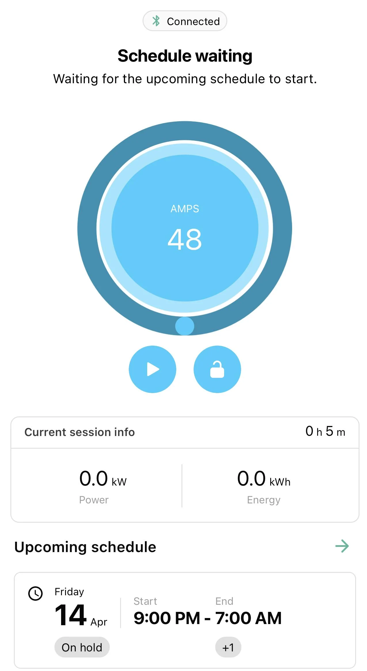

Agree, would be nice to adjust amp charge rate from app, Tesla has this capability.
That said, when at home, I just control the amperage and schedule from my EVSE, Wallbox Pulsar Plus.

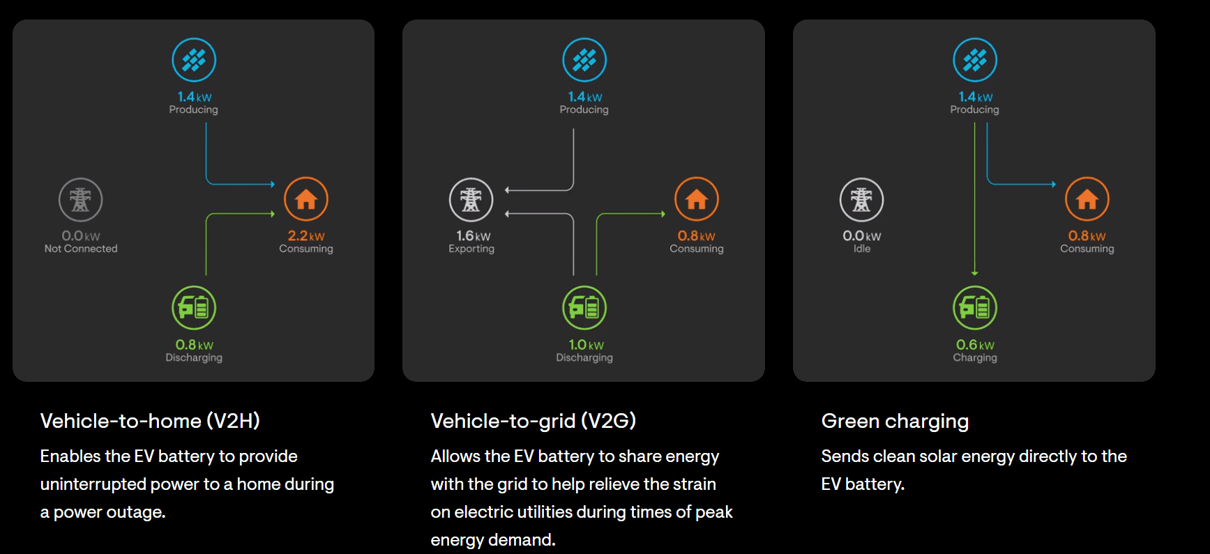

Enphase's solution is due to be released next year. I did the sunlight backup when I installed my 8kW array last year so I would already have the hardware ready for any future battery back up with or without the EV and it should be a simple addition.
Rivian R1T R1S Solar Integrated Charging 1681569511270
This is just the sample screenshot from their website. https://enphase.com/ev-chargers/bidirectional. Having the brains of the EVSE do this would be much easier than constantly adjusting from the truck side, even if it was available in the app. But, most of these solutions are a year or more away, so wouldn't hurt to have the ability if interested.
