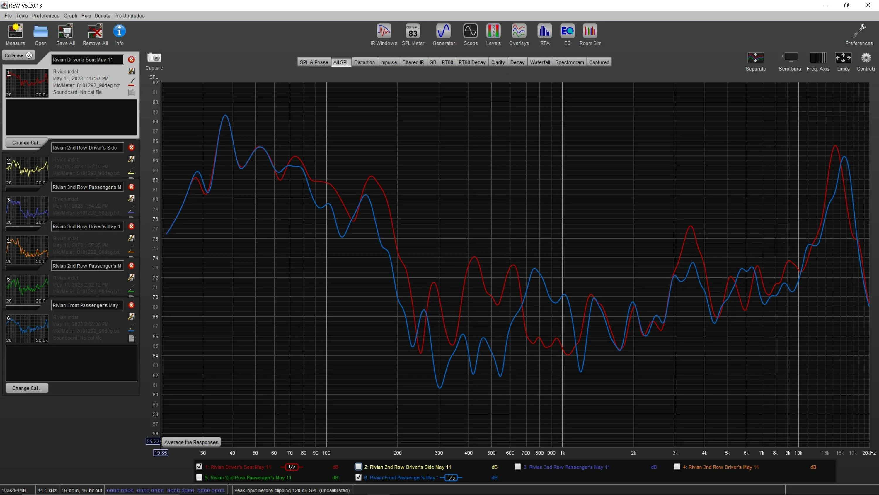

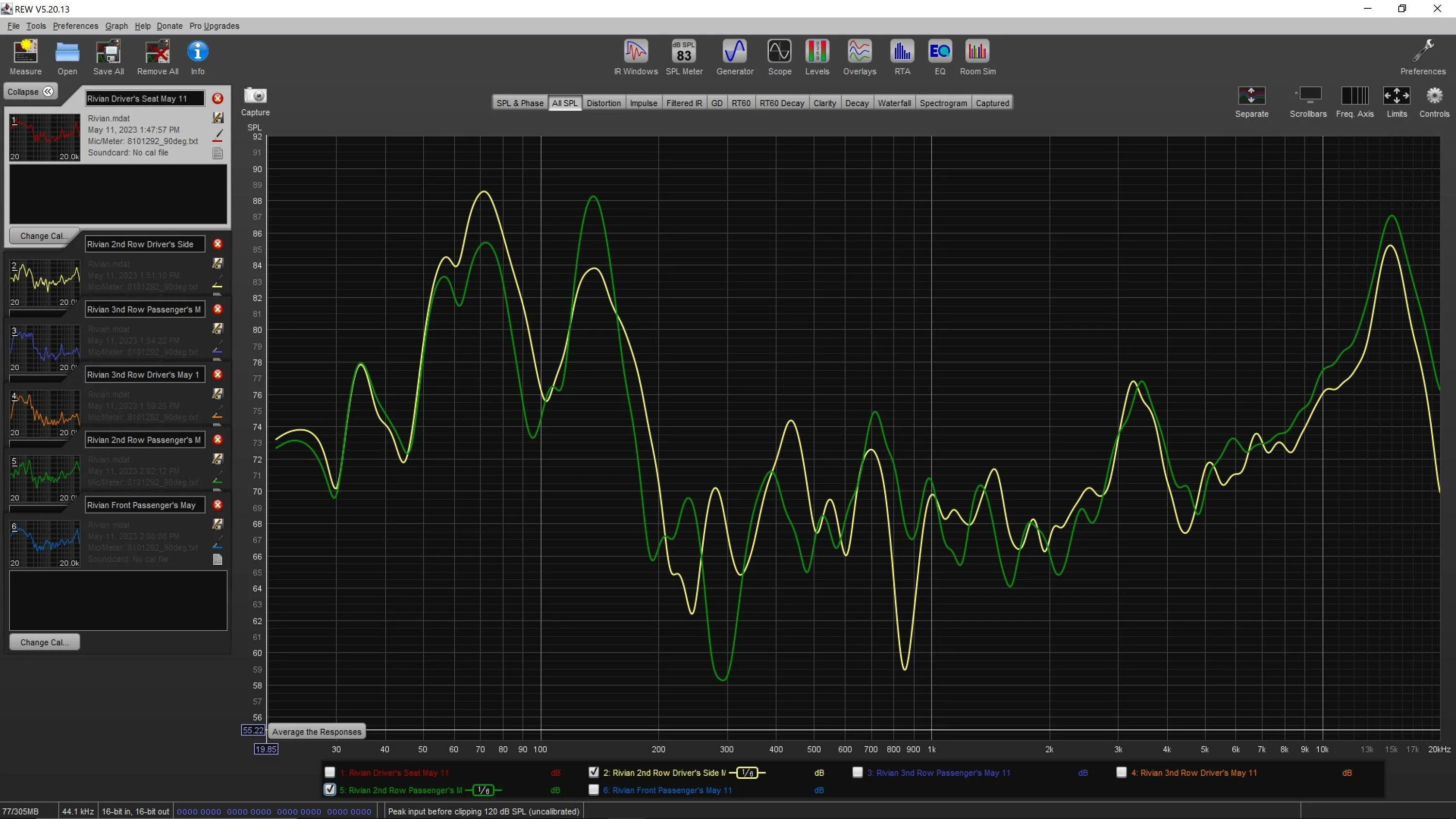

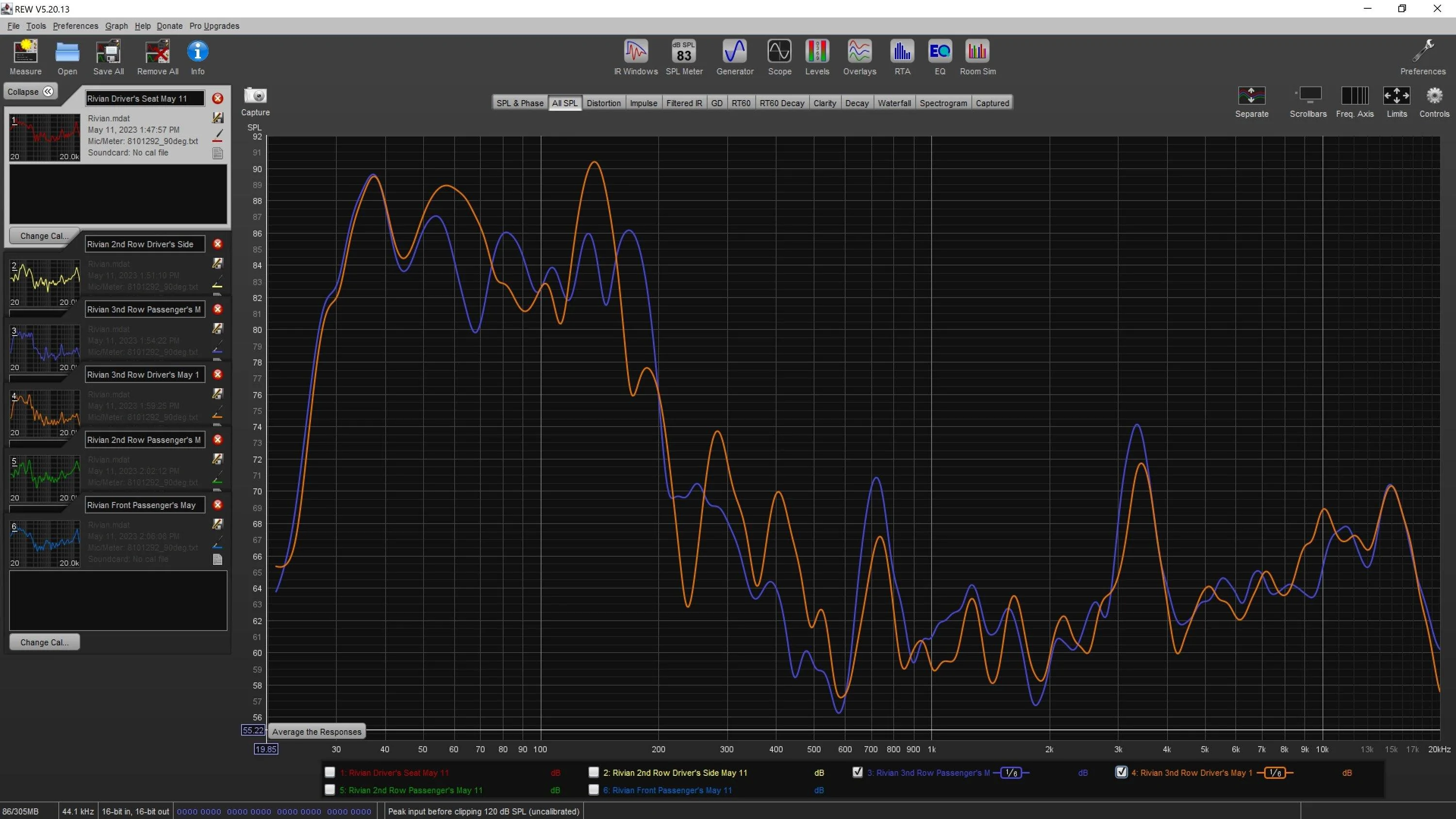

I made some measurements a couple months ago which I posted another site.
"I had some free time today and was finally able to get some sound measurements in my R1S.
I have the Rivian Elevations system not the Meridian. The input source was via Bluetooth from laptop so not the best sound reproduction but it does give you some idea of sound characteristics in the various positions throughout the cabin. Needless to say, I will be doing some tuning with the system's EQ. However, there is such of lack of mid and high frequencies in the third row that the only way to improve it would be to add extra speakers.
Testing equipment and conditions:
Enclosed Garage
All windows and doors in Rivian closed
HVAC off
Test run with me sitting in passenger seat except when testing the passenger seat location when I sat in Driver's (interestingly BT would not stay connected unless I sat in the vehicle)
Sweeps were run with EQ flat, 3D Surround Sound Enhanced, Dynamic Sound Adjustment High (this setting did not matter as expected)
Microphone: miniDSP UMIK-2 USB Reference Measurement Microphone (UMIK-2) on tripod
Measure Program: REW V5.20.13 (REW room acoustics and audio device measurement and analysis software)
Sound Sweep: 20 to 20,000 Hz
Sound Level: -12.00dBFS
Sample Rate: 44.1 kHZ
First row:
Rivian R1T R1S Sound system sounds bad Front ro
Second Row:

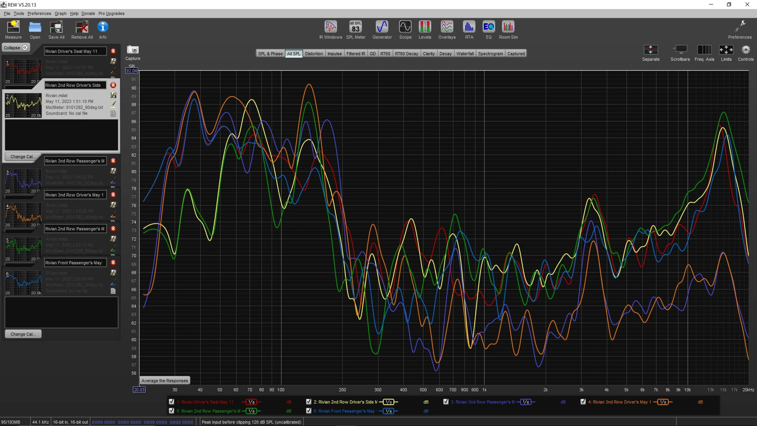

Rivian R1T R1S Sound system sounds bad 2nd Ro
Third Row:
Rivian R1T R1S Sound system sounds bad 3rd Ro
All Rows:
Rivian R1T R1S Sound system sounds bad All positions

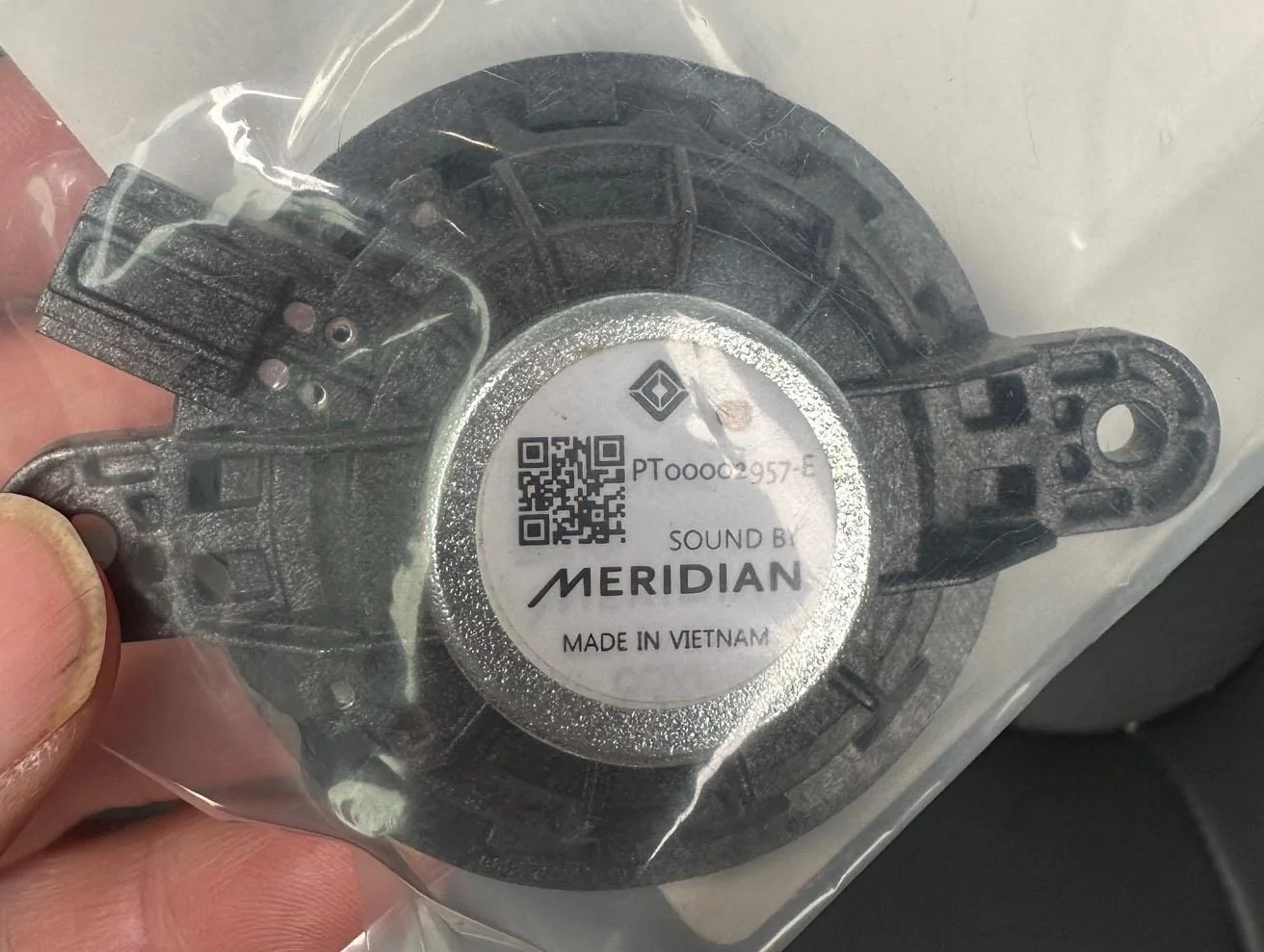

I had my driver's B-pillar speaker replaced for "buzzing" heard mid to high frequency notes especially classical music. Both the removed speaker and its replacement were Meridian which did not fix the issue. The technician and I both agreed that it is likely a cross over issue which can hopefully be fix with an update.
Rivian R1T R1S Sound system sounds bad Meridian

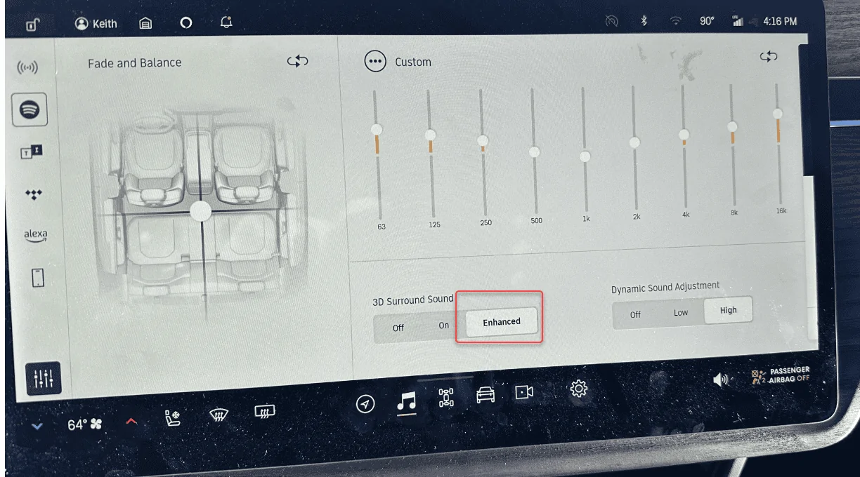

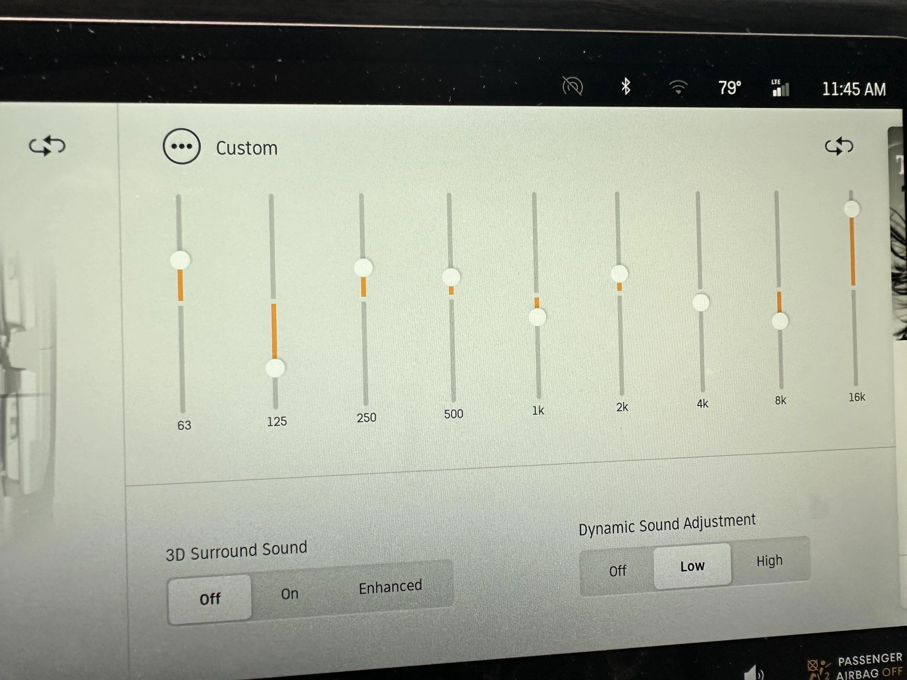

Ah, okay, your EQ settings are similar to mine then. Our musical tastes are similar, so it's not surprising. My current favorites are (aside from Dream Theater and Fates Warning) Haken, Soen, Cellar Darling, Pain of Salvation. Completely outside the prog metal/rock genre, I've also been listening to Ren. I actually think the Meridian system sounds pretty good, though it could use a stronger sub in the R1S (it's a bit better in the R1T).
Here are my settings. I started with the "ROCK" setting and tweaked the highs a bit and the bass. I also use ENAHNCED......to me it fills up sound. Going to try listening to Devin Townsend "Transcendence" on my drive home. His music is very spacial and atomspheric.

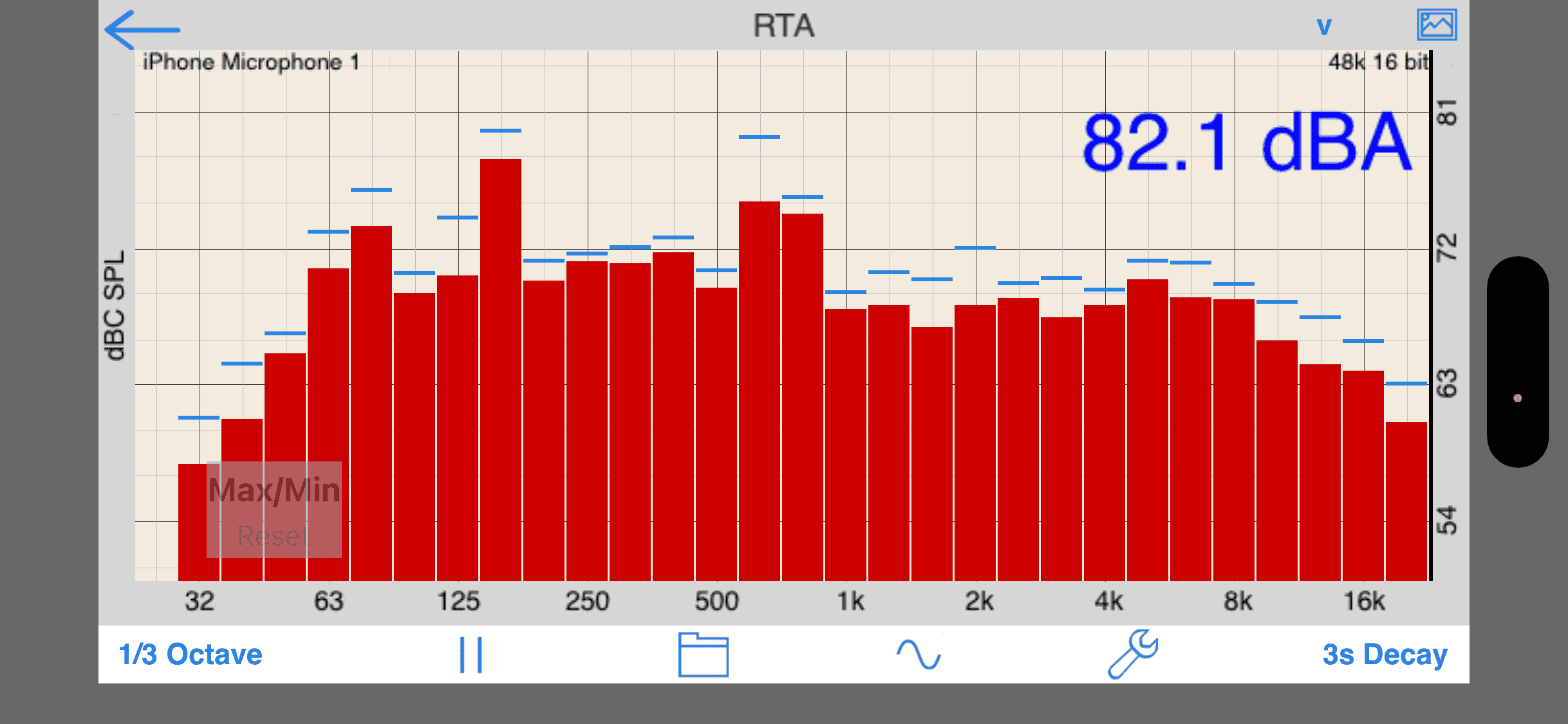

And there is no correct or incorrect taste. When I set up a system, I first set it up using acoustical test equipment including a pink noise generator and an RTA along with other equipment not relevant here. Depending upon the application I might go with setting up to be flat to 4.000 Hz and the drop off from there at about 6 dB/octave. But it is important to remember that that is simply a starting point, and usually does not sound that great anyway. In the end I do it by ear to my own taste. That is what most pros do. I have done that for very famous bands and venues and it tends to work the best. So please do not use test equipment and then feel that what it showed you is the "correct" and best setting and then don't change it. Accuracy is not as important as your own pleasure. So, when setting up a recording studio for the first time you go for very accurate sound as you need to know what is being recorded. But for playback systems (including your Rivian) set it to what sounds best to you. Really... that is what matters! I agree that setting the sound back from the center sounded better to me and that the 3D sounds a bit wonky. But that is my opinion and I vary that depending upon what I am listening to. So, you only have a few things that you can adjust so just play around with it and go with what you enjoy the sound of. Don't feel a need to go with someone else's favorite unless you really like it. I would assume that the engineers who designed the system got it right as far as flatness and such so just adjust to your taste from that starting point and enjoy the sound. Also if there anomalies in the DSP they will fix that in time. And.. I agree that the bass in pretty lacking. Just cranking up the lowest frequencies on the EQ may not be the answer to that but may help somewhat.
RTA + EQ
Rivian R1T R1S Sound system sounds bad RTA
Rivian R1T R1S Sound system sounds bad EQ
Just FYI -- the "Custom" settings pictured above (63, 125, 250, 500, 1k, 2k, 4k, 8k, 16k) are 100% identical to the pre-configured "Hip Hop" EQ setting so no need to start with "Rock" and manually adjust from there.
May save some time for anyone who is interested in trying those settings.
