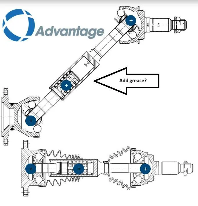

I do wish there was a way to add grease to this section of the half-shaft. I'm virtually certain this part has different levels of grease and that's where the variable sound comes from.
Correct - see video explaining how it works.
I’m certain it’s the linear portion of the moment tee hear/feel.

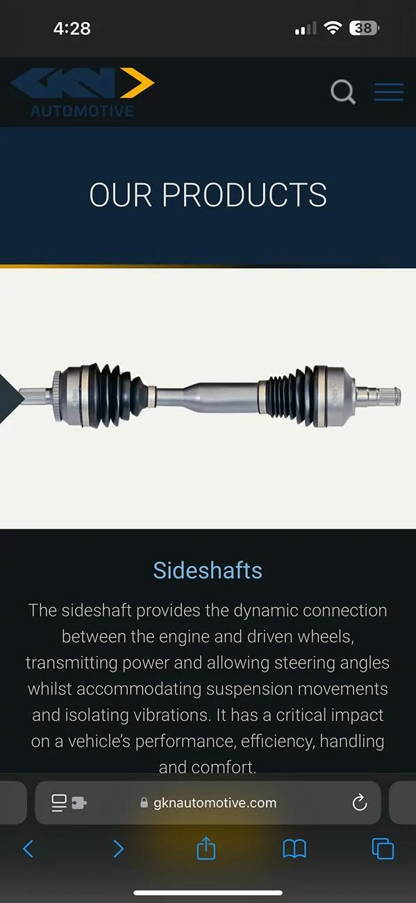

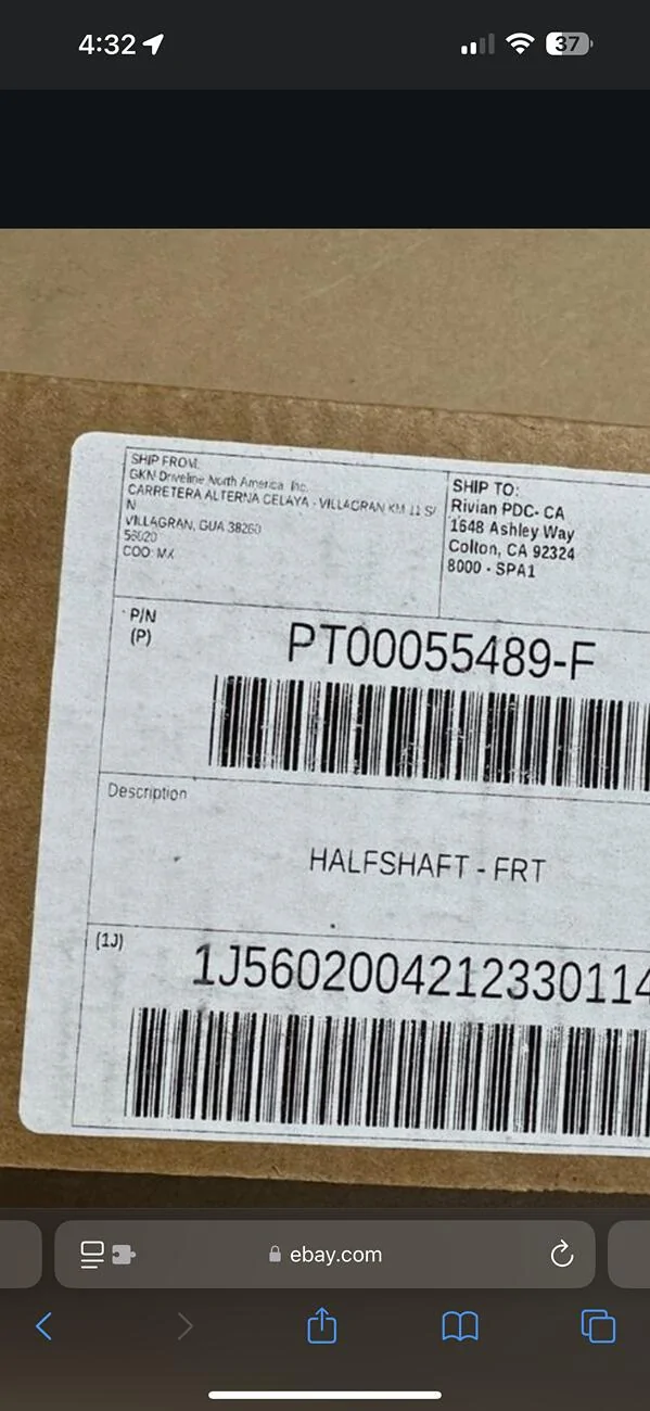

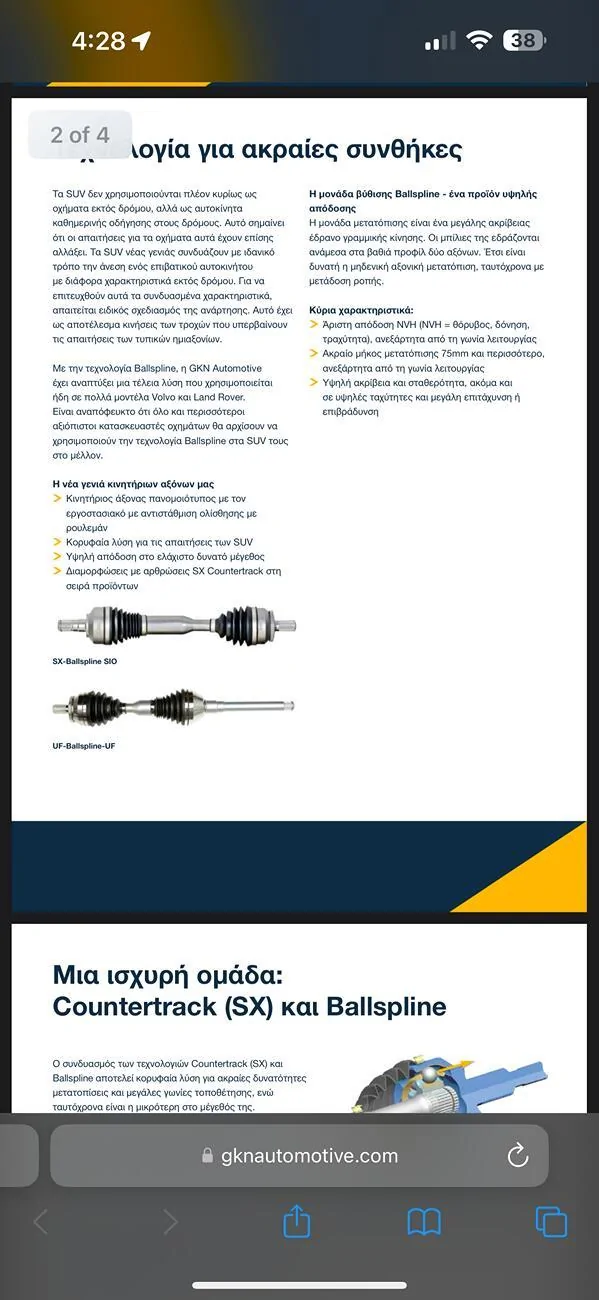

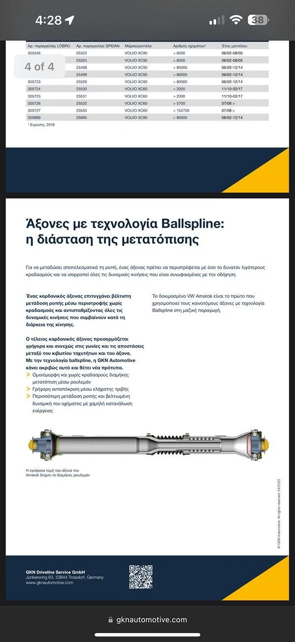

Correct. And actually, I did some more research.
GKN Drivelines are who makes it for Rivian. See image from shipping label on EBay link.
https://www.ebay.com/itm/116385142713
As long as we want the travel that R1 brings, they need to use these axels that allow a third axis of movement (axially).
See images attached.
