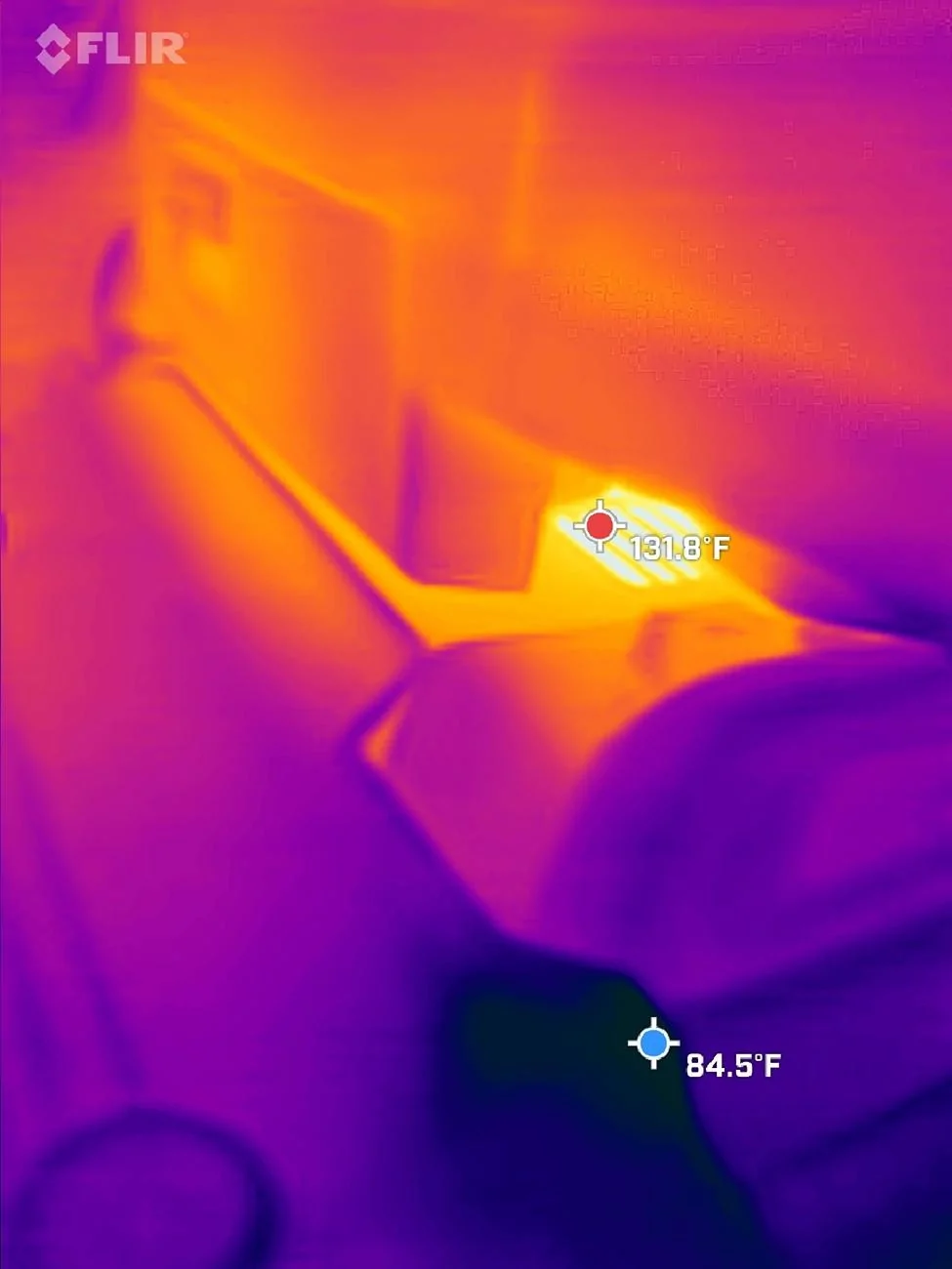

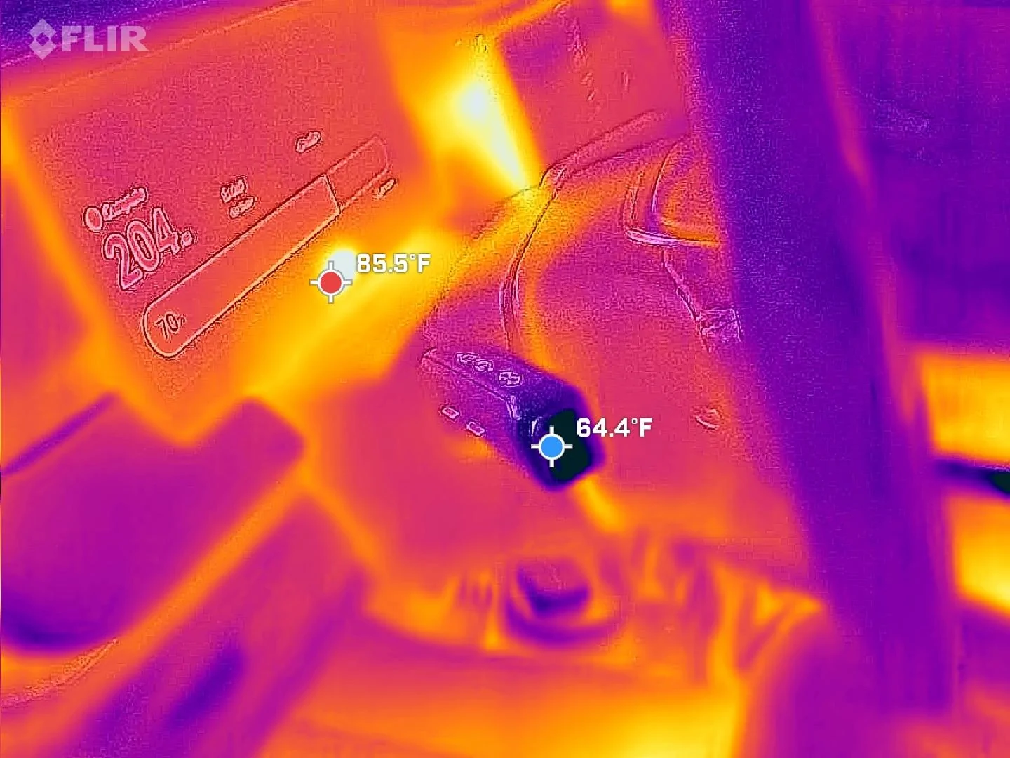

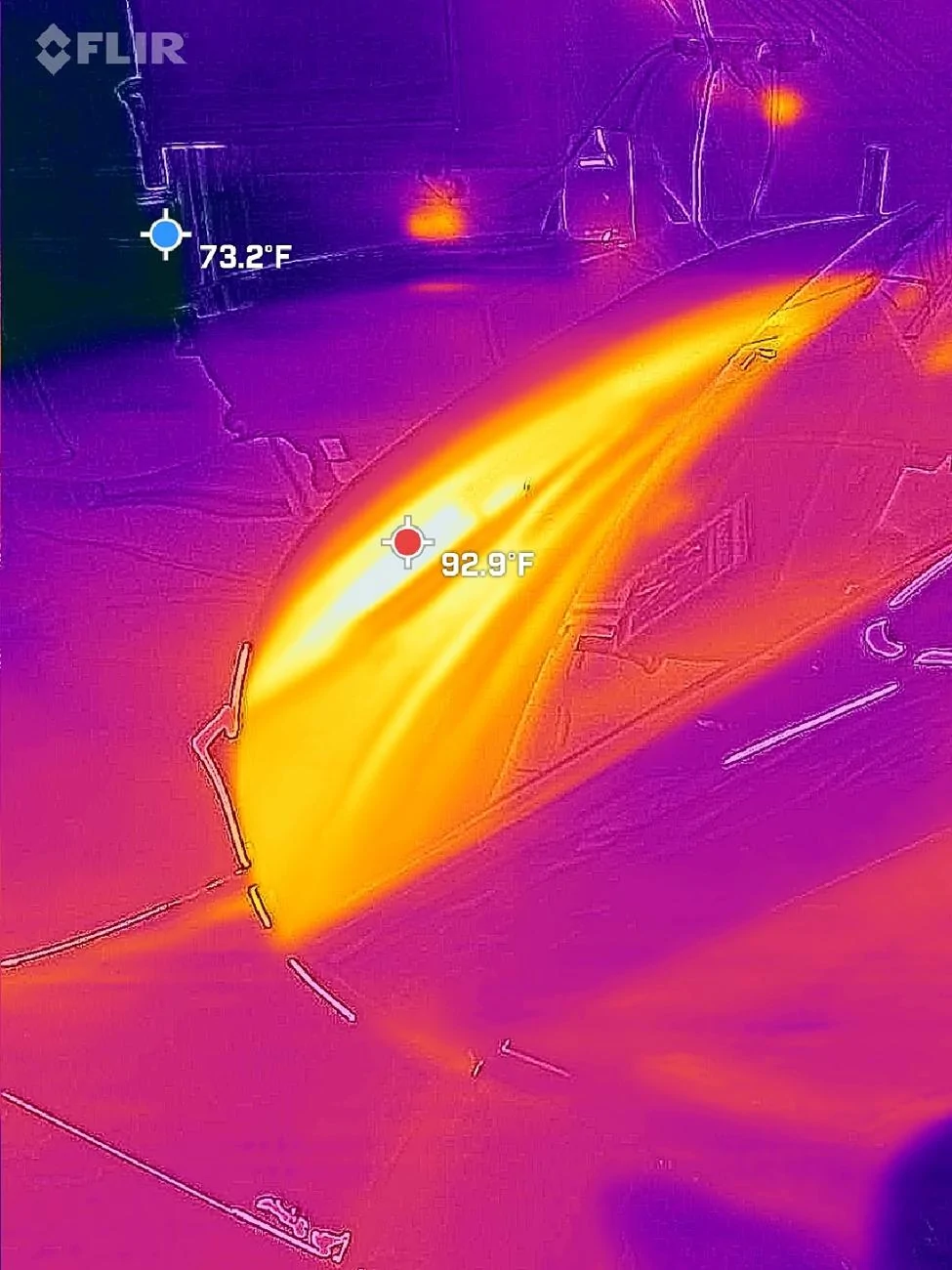

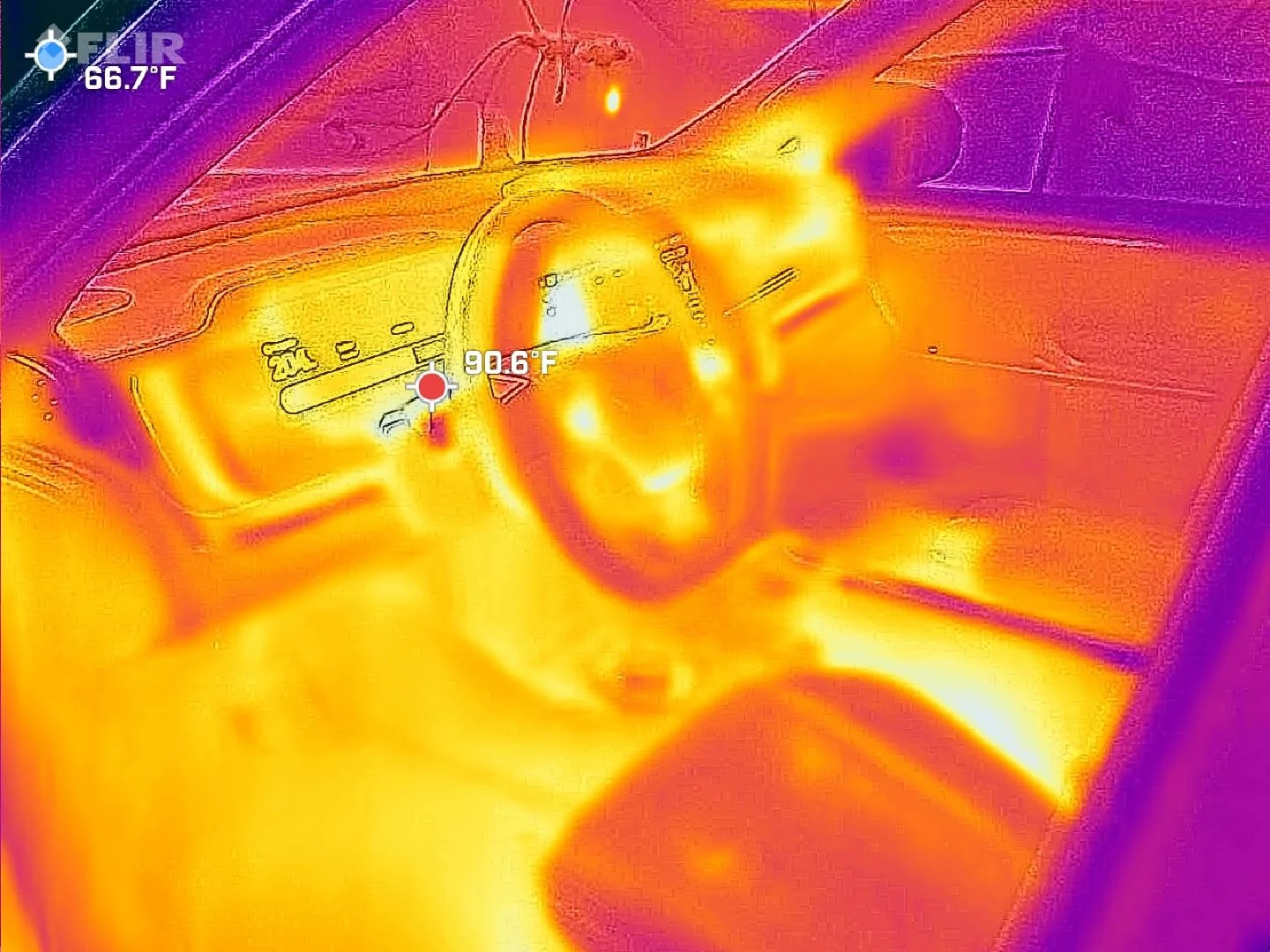

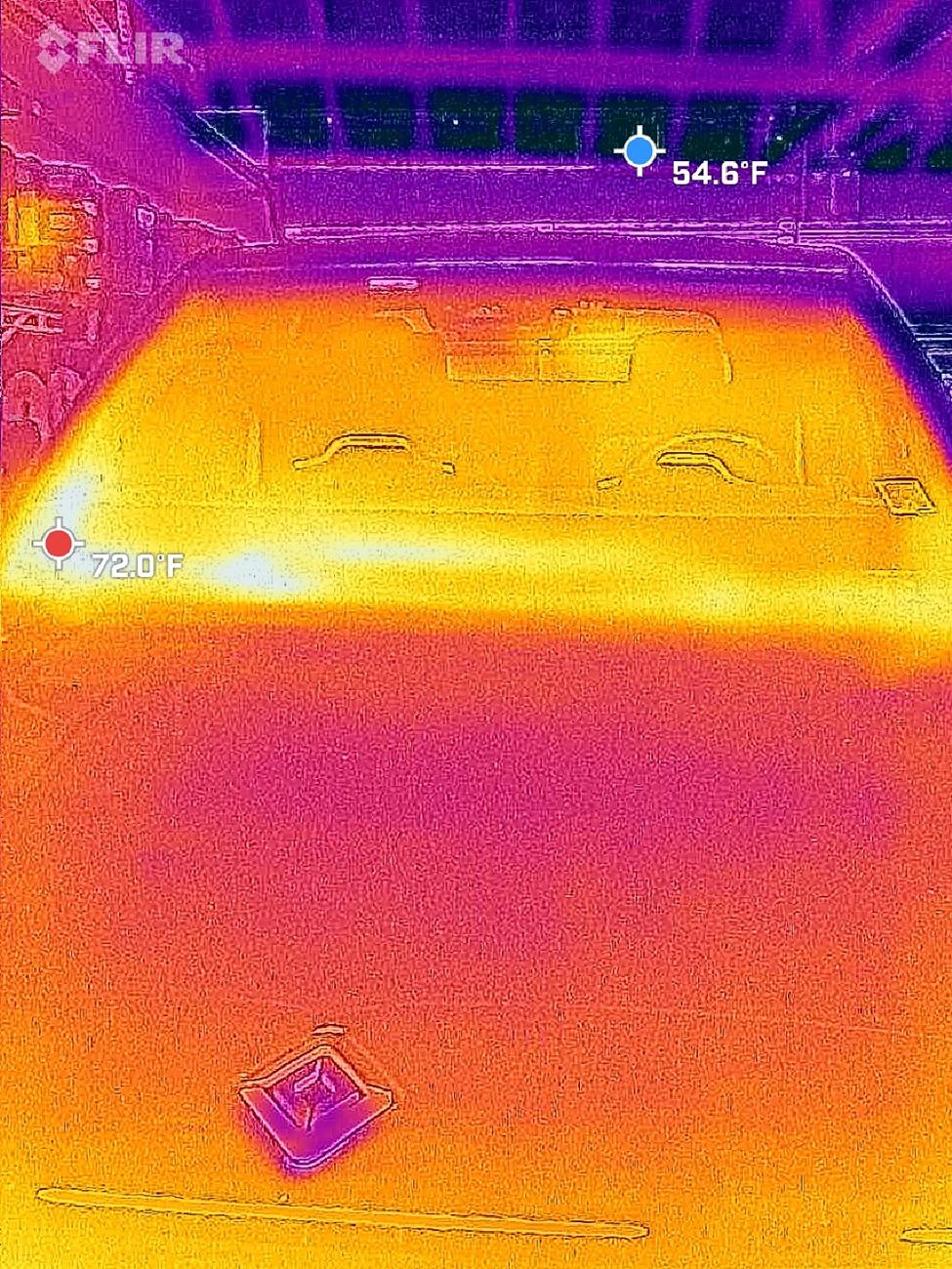

Enginerd
Second day today I noticed my cab is at 91 after being parked all night. It's about 80 in my garage. Didn't charge yesterday, it did today. Not sure how much heat being awake generates but seems high. Highest temp I found was under the driver's seat
Rivian R1T R1S Tail lights keep blinking FLIR_20250716_060436_399
Rivian R1T R1S Tail lights keep blinking FLIR_20250716_060409_294
Rivian R1T R1S Tail lights keep blinking FLIR_20250716_060421_850
Rivian R1T R1S Tail lights keep blinking FLIR_20250716_060256_754
Rivian R1T R1S Tail lights keep blinking FLIR_20250716_060242_825

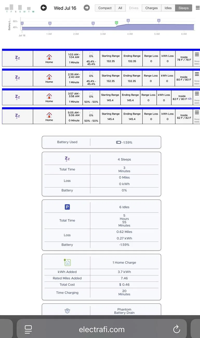

The next morning - interesting; looks like the truck has tried to sleep several times, but never for more than 1 minute. Still flashing.
Rivian R1T R1S Tail lights keep blinking IMG_7984

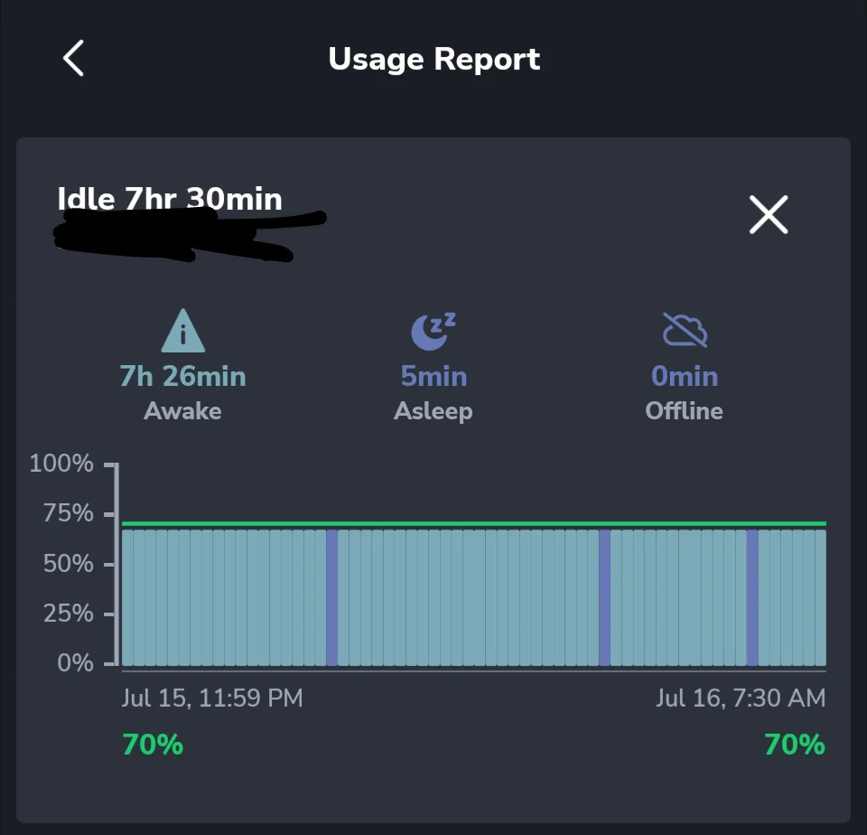

Same here. I also had 2 full front light bar flashes randomly last night. Blinky boi is blowing up my garage cam notifications
Rivian R1T R1S Tail lights keep blinking Screenshot_20250716-075542~2
