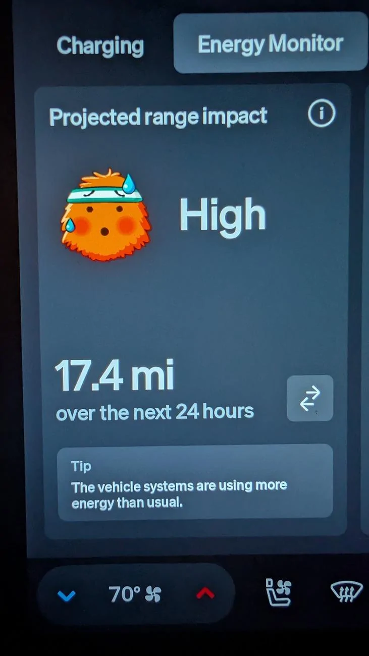

I haven't gotten any offshore support. All seem interested and want to help, but aren't able to pull logs. In the meantime, this is annoyingly cute. "Vehicle systems using more energy than usual". The h*** you say. 😜

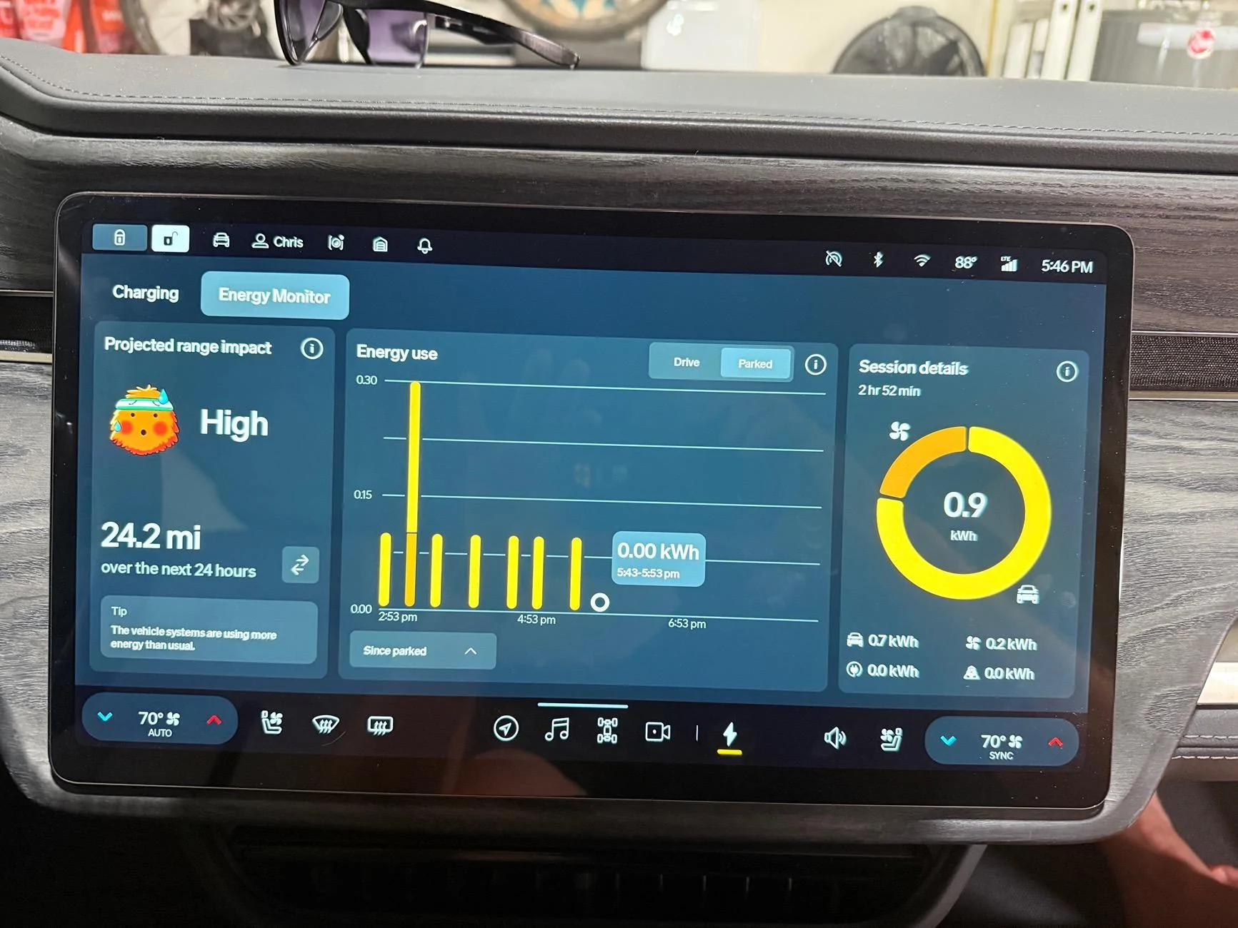

Same here. Must have started on Thursday/Friday of last week. Fried my 12v. Just had it replaced at service center yesterday. Miserable experience (whole other story behind that). But now I’m noticing the truck hasn’t gone to sleep at all since the 12v replacement and tail light blinking is happening none stop. Major issue. Hope this new 12v isn’t getting fried now too!
Oof. 0.9kWh in less than three hours. That's worse than mine. Call and submit a ticket ASAP, if you haven't already. This is going to absolutely demolish a lot of 12V batteries, as you've seen. 😢

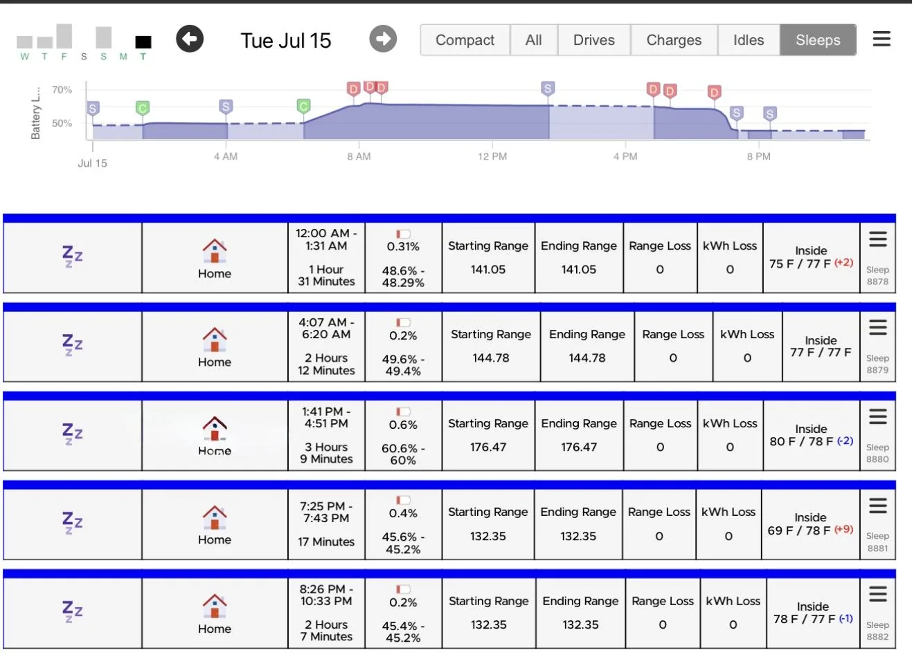

Believe this is happening to me (just started though). Truck was sleeping fine through the day, I went into the garage to move some things around before bed, and suddenly the tail lights started blinking. Truck hasn’t gone to sleep since (it’s usually very quick to go to sleep). Tried turning off Bluetooth on my phone- same issue. Will be monitoring. Oddly I have a service appointment in 1 week so might be adding this to that ticket.
(Re: the pic - 1033 pm (MDT) is when the problem started for me. It’s 1120 pm as I write this)
